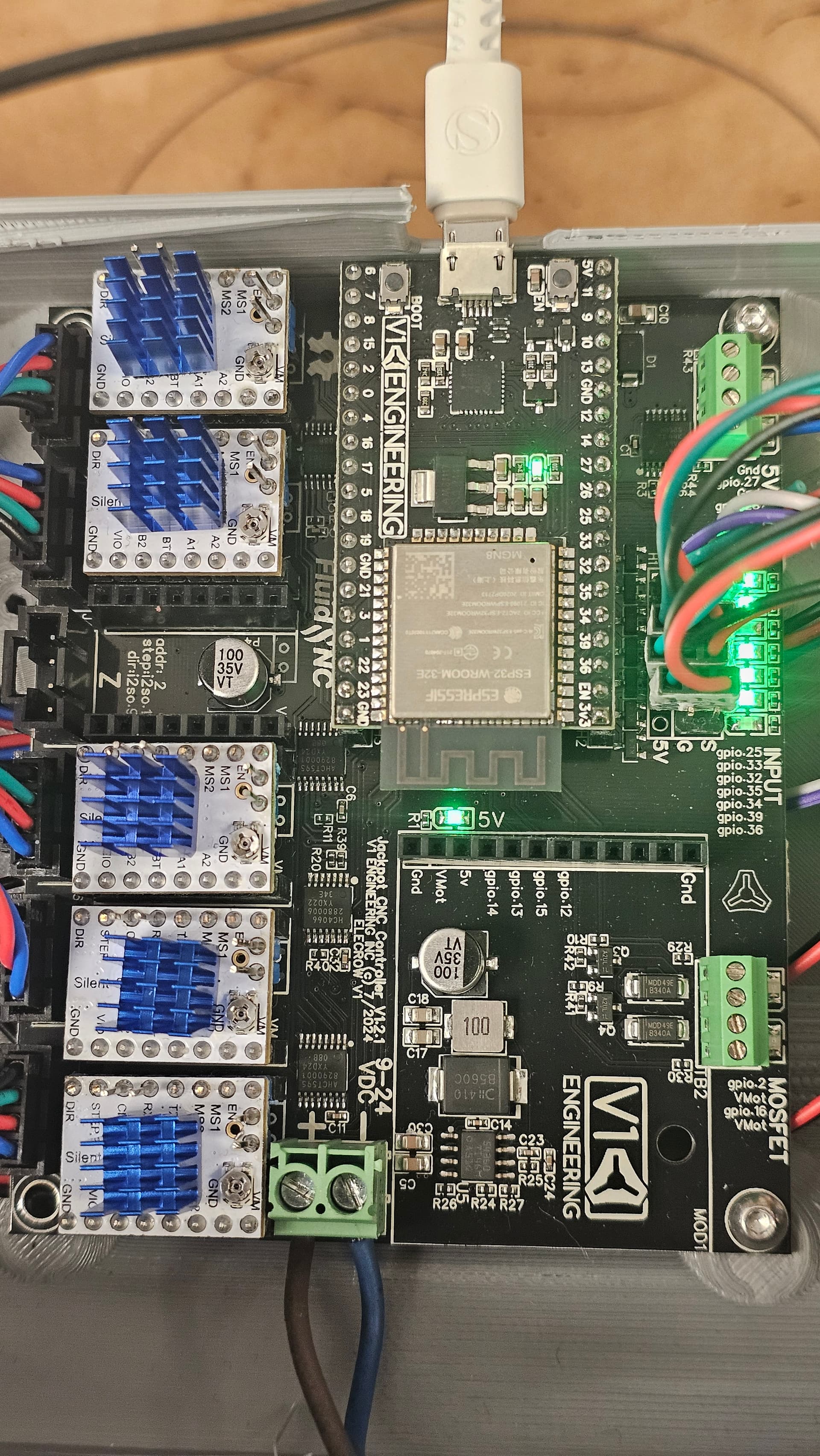

Why do you have a USB cable plugged in?
You need to power up the board from its DC supply before plugging in a USB cable or this happens:
[MSG:ERR: X Axis TMC driver not detected - expected 0x21 got 0x0]

Can you power it up with the USB disconnected and run $SS again please?
Edit: oh and have you checked the stepper pulley grub screws are secure?
So i have checked the grub screws and they are tight.
I furst power on the cnc then i conect it to the laptop to see $SS. It gives the same outcome.

Your TMC2209 module UARTS are not communicating with FluidNC.
You will not get correct motion until FluidNC can correctly configure the Drivers.
Some TMC2209 drivers need to have zero ohm jumpers moved around on them to correctly set the UART pinout. Your modules may be that type.
Willchek that i think i have to remove MS1 and MS2 pins
Did you change Motor 0 for some reason? Ryan’s config.yaml doesn’t have that.
You need to change Motor 0’s microsteps to 8 also. Then they should move the same amount.
So i think the drivers are wrong a plugged in a difrent tmc2209 and i had Y working fine and corected the microscopes to 8. But i accidentally plugged in one of the drivers wrong and blown up the ESP32 So now i haved orderd a new one and will chek and update.
Hopefully i havent damaged the jackpot controler.
