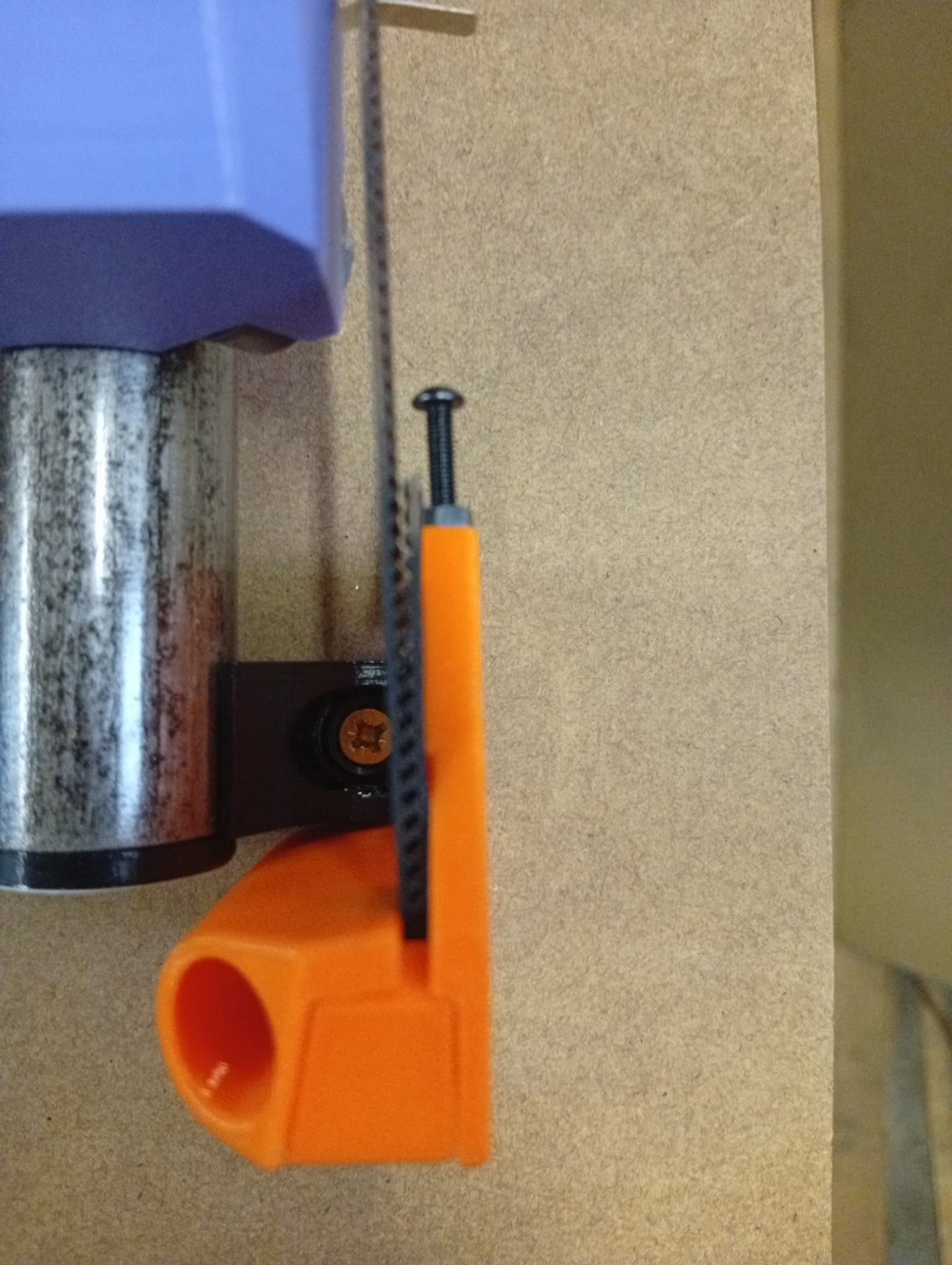

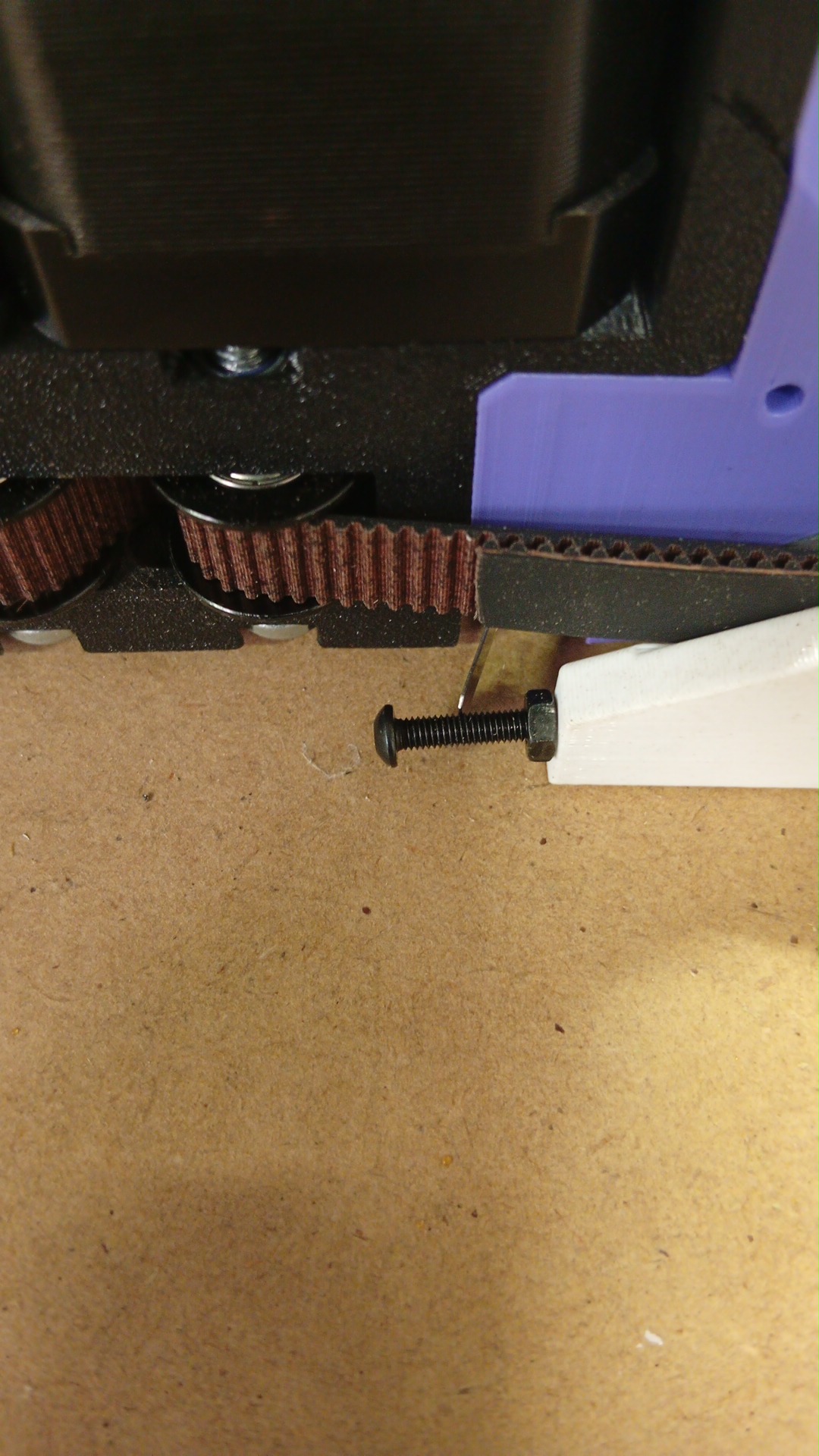

First the one motor whent backwards while the other one whent forward :face_with_peeking_eye: . With the help of my new buddy who wrote my yamil for me. We sorted that out in the yaml file. Start the Y homing and it triggered the limit switches(I have the long blade ones).:clap: and then it did not want to move back. I moved it back by hand(the power was off). Tried again and then the hours of headache started. Everytime one of the motors will go passed the trigger point and then the “grrrr” wil start. I even messured the distance from the end of my runway to the gantry to make sure they where even from the limit switches. When one of them trigger the switch it will continue and the opposite one(sometimes not close to the switch) will stop. Any help or direction will be highly appreciated.

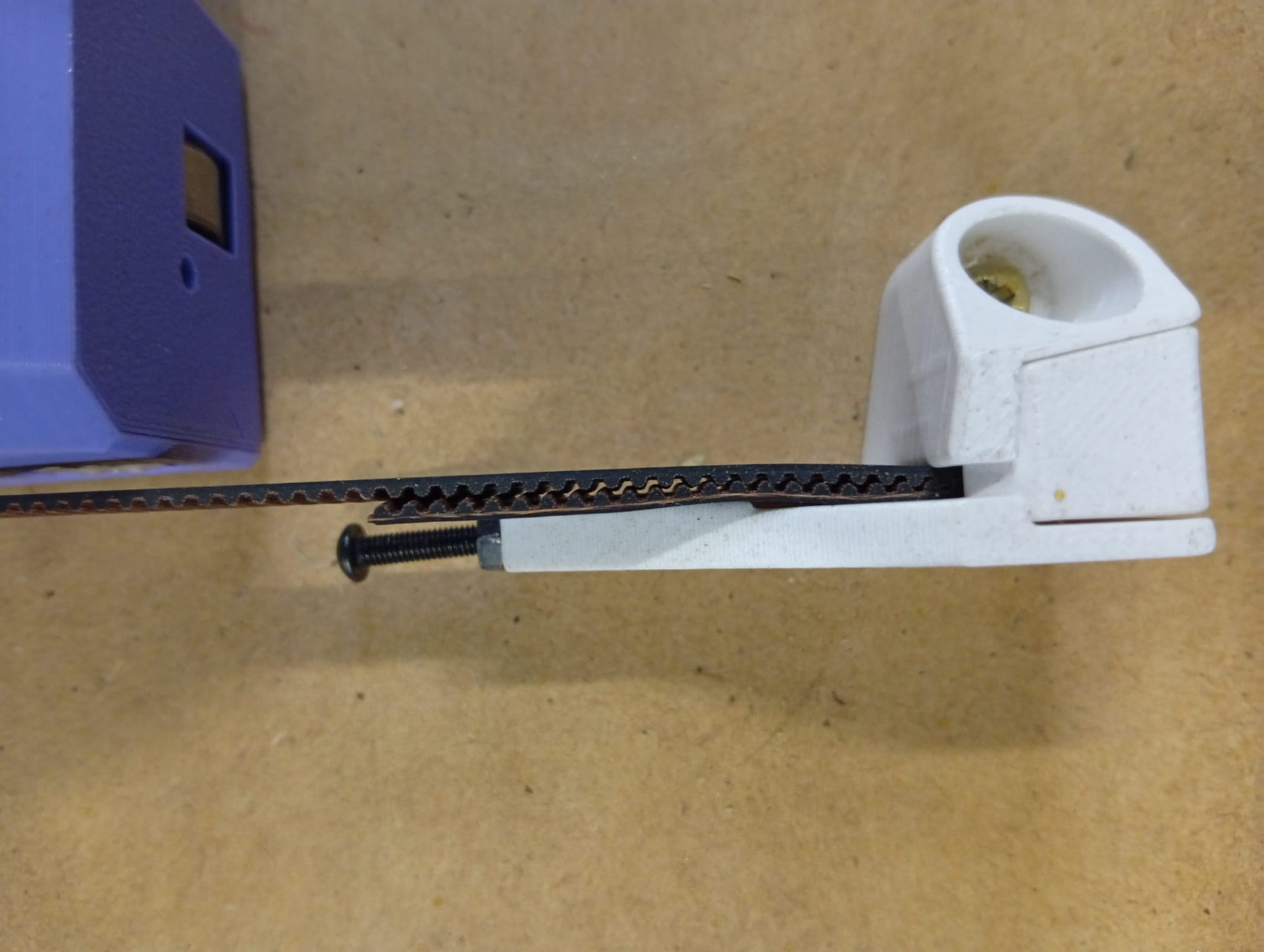

Can we have an above picture of the belt holders? It looks twisted outside.

If it did not stop with the screw that far out whats screwing it in by about 10-15mm going to change?
The screw is pointing outside which could be the problem.
I printed that from the files provided so how do I get the screw on the inside
It’s just crooked. So if you screw it in (but not a screw that long), I am pretty sure that it should work.
I did screw it in both sides but still the same problem. Thanks anyway.

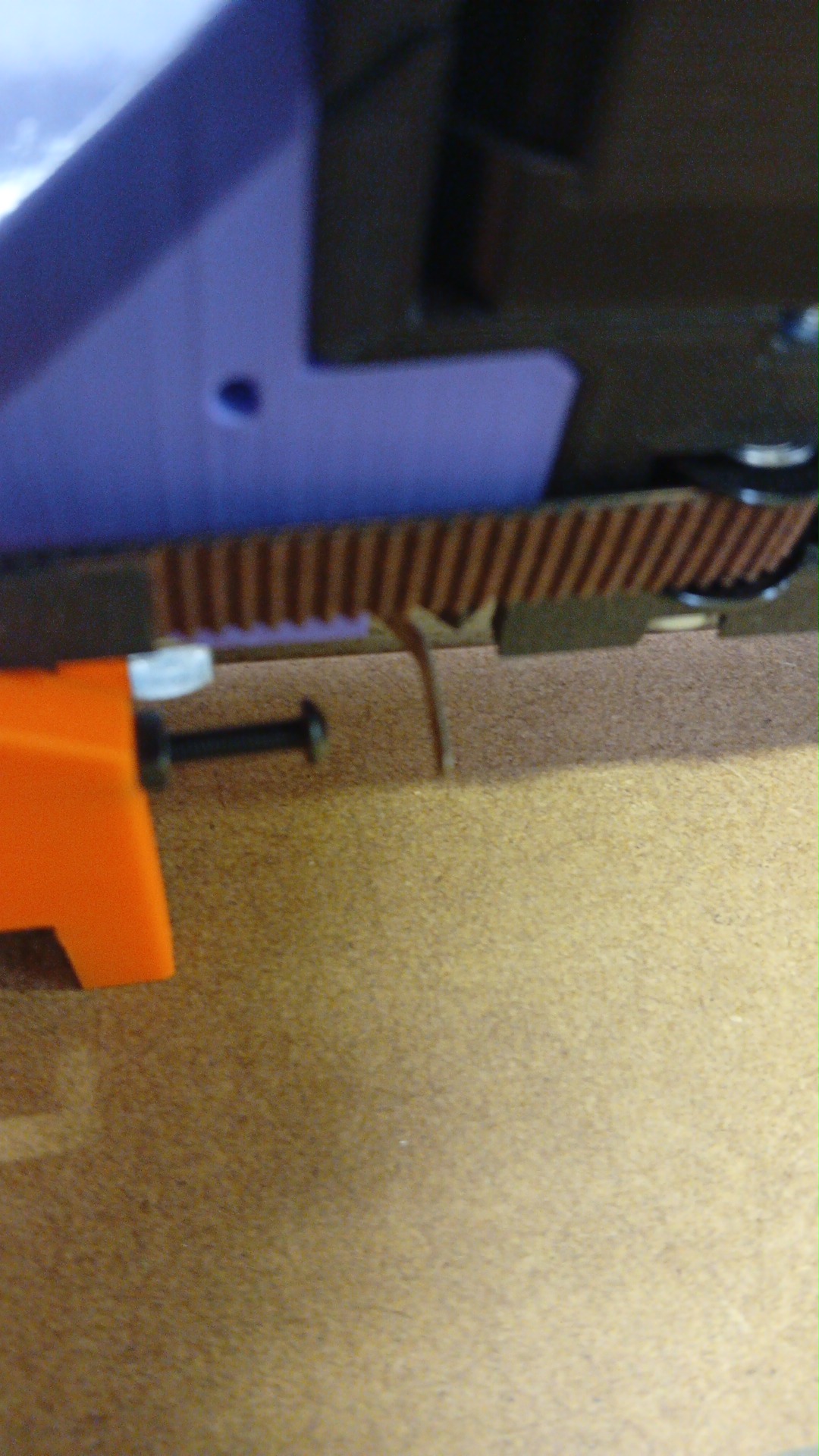

Show us with it engaging the end stop on the Y min side. Does it defs click the limit switch or does the switch just get slightly nudged. Did you run $limits and trigger them to confirm their status is being read correctly?
Think I found my problem. I was trying to home it from about 50-100mm away. I moved it to 400-500mm away and it worked but now after the two touches it stayed switched. I did ran the $x command to release it.

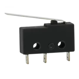

Edit: I just looked at your first pictures again. Why are the limit switches bent 90 degrees? Can you show a clearer picture of them? The first pic shows the switch is past the limit screw without triggering? How can the lever arm trigger the switch if it’s out so far?
as i said before i used the long arm limit switches and not the short ones.
