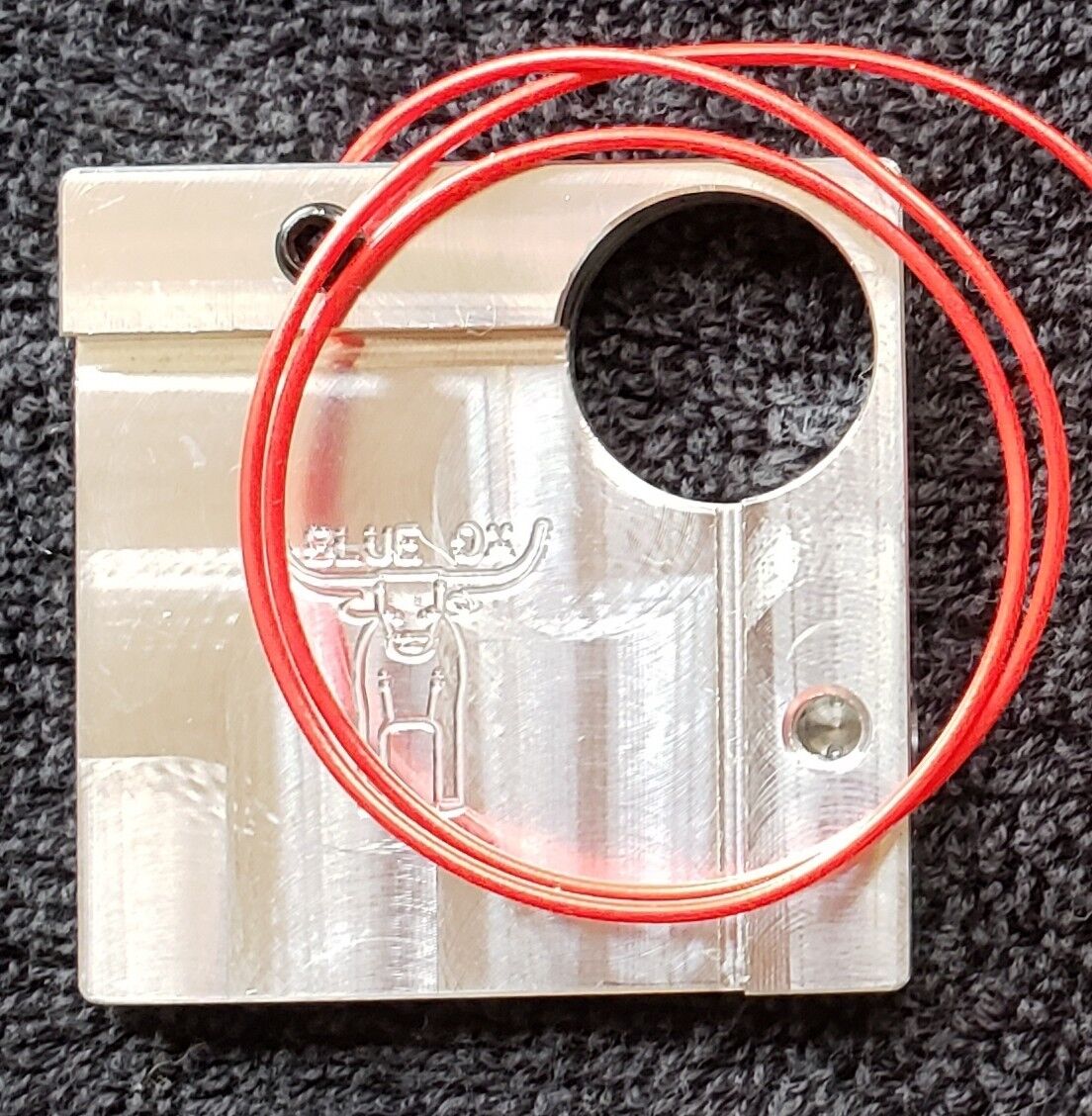

I recently bought and XYZ probe and am having trouble getting it to work on an SKR based LR3.
The sample start code is as follows, with my comments added.
G38.2 Z-15 F100; Probe Z Target -15
G92 Z3; Set Z to XYZ plate thickness
G91 G0 Z3; Raise Z 3mm
G91 G0 X-27; Move Left -27mm
G91 G0 Z-6; GO to Z0
G38.2 X15 F100; Probe X Target Right
G92 X-12.18; Set X0 to X offset (9mm + half bit diameter 3.18 for 1/4", 1.6 for 1/8" .8mm for 1/16")
G91 G0 X-3; Move Left 3mm
G91 G0 Y-27; Move Forward 27mm
G91 G0 X27; Move Right 30mm
G38.2 Y15 F100; Probe Y Target
G92 Y-13.175; Set Y0 to Y Offset (9.2+ half bit diameter 3.18 for 1/4", 1.6 for 1/8" .8mm for 1/16")
G91 G0 Y-3; Move Forward 3mm
G91 G0 Z30; Move up 30mm
This code will probe z, but will start the gcode file immediately after. Is something wrong with using G91 in the context? Im really confused here.
