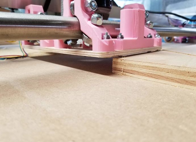

I’m sure this is a simple fix but I haven’t figured it out yet. I’m cutting a 3/4 " piece of plywood. I’ve zeroed the bit on the z axis. I got to the last layer or next to last layer in a cut and the screw mount heads from the router hit the work piece and threw off the router.
What is the best way to set the axis on Z where it doesn’t hit but can cut through a 3/4" piece or whatever thickness piece that is on the CNC.
Thanks in advance

This on the LR2. ok, so the challenge to explain this.
I set the bit at zero on the table while the CNC is off. This allows that if it drops it doesn’t plunge the bit through the table. I could make the bit go deeper I guess and have a hole that it sets into on the HOME position. However, I was thinking more along the lines of a 3d printer where the tip sits at zero to start.
Because the LR2 automatically drops to the table, there isn’t an adjustment to keep it up a few mm’s so getting the actual x plate to not hit the work item (3/4 ply at this point). I’m thinking probably this is a g-code starting issue or something.
More than likely, it’s my perspective on the CNC vs 3d printer and something I’m missing.

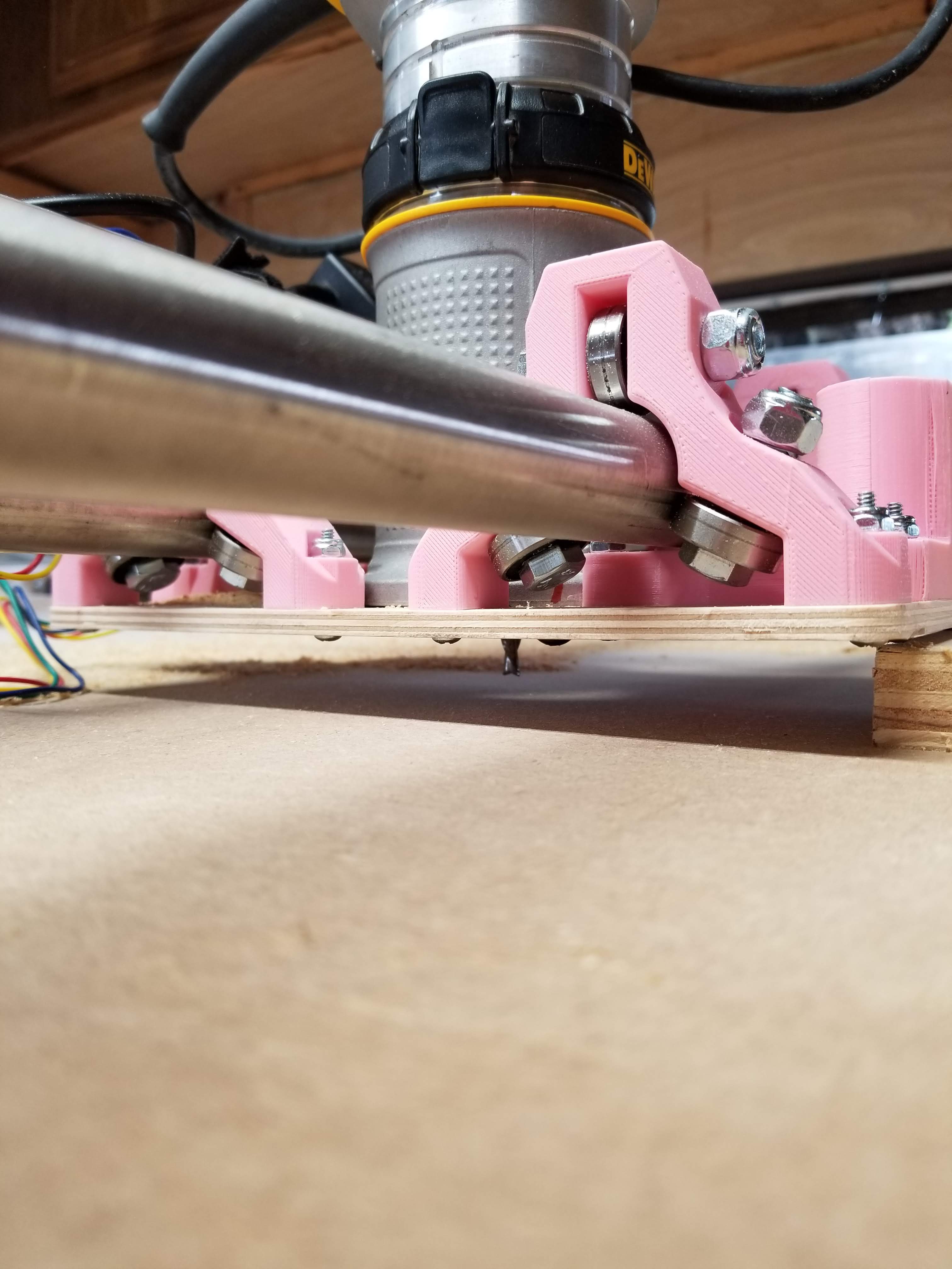

On mine I can get the collet almost all the way past the carriage, though my base plate is only about a quarter inch.
I wanted to use countersunk screws, but I don’t have enough material for that, you might be able to do that. If you’re getting that close, be careful with dust collection, it doesn’t take much for it to stick itself to the workpiece with a shop vac running. Usually before a cut I run the carriage off to the side of whatever I’m going to cut and crank the router down so the end mill goes past the piece, then I lock the router in the base. So in the picture above I’d move off to the left side and make sure the end mill could at least touch the mdf spoil board. I was testing an engraving on the foam in that pic.
When my machine is off, I have the router up enough so the bit doesn’t stick out the bottom. Then I turn the machine on (in a square position), move to the workpiece origin, then up enough to account for the thickness of the work, and I adjust the router base so the bit is touching the top surface and I set the origin position. When cutting 3/4" ply, I might be cutting 19-21mm deep (I cut deeper on larger items, because there will be more error), with a few mms into the spoil board just to make sure the piece gets cut out. When it’s done, it will rise up to the clearance plane, and since I’m always standing right there (never leave your running CNC alone), I will turn off the router, raise the bit by adjusting the router base again, remove my work and usually power off there, but sometimes I will jog over to the starting position first. The router isn’t ever dropping with the bit out (at least not on purpose) and the router is off before dropping. I have a LR1, but I think it’s similar.
If your machine is dropping before you want it to, there are settings for that, and there is a gcode (M84, IIRC) that is sometimes in closing gcode that will disable steppers, which you have to remove.
Bottom line, your bit needs to be sticking out further. Moving the router down is probably the easiest. I’ve also had to remove those little plastic rings on the bits for it to go down the full 21mm. They are just press fit and I can remove them with some pliers.

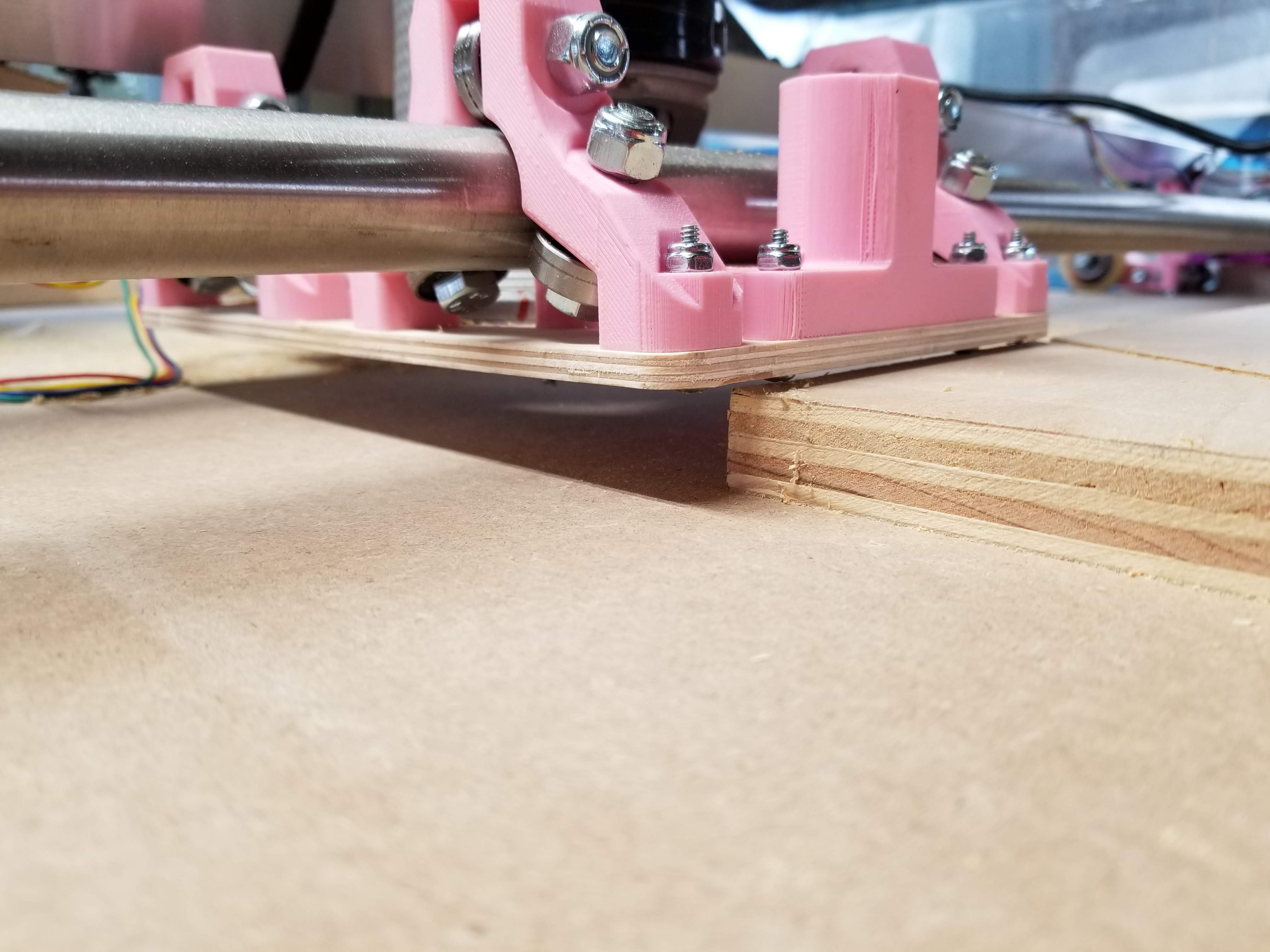

ok, so bear with me if you might.
the distance between the plate when Z = 0 is 1/8th of an inch between the bottom of the plate and the top of a 3/4" board. The screws that mount the hardware slides and the router come down about 1/4"
With that said, I’m trying to figure out how to come from a Z=zero to a position on the controller (say z = 30) to lift up the z axis, then drop the router bit long enough to cut through the material, but at the same time make sure that the plate doesn’t touch the work piece when it cuts through the entire 3/4" .
So my guess is I need to do some g-code settings (estlcam) that would allow this to happen. I am thinking that I should have a zero position set and initial code would allow me to come up say Z=30, change tool which is really lowering the bit, then start the cut.
Does this make any sense now?
I hope that explains it better.
Yes to all of the above. I know it seems wonky but after the first good cut it makes sense.
#4 (as long as your are sure your bit is out as far as you need to go deep plus a mm or two).
Try it a different way, might help to get the hang of it. Set the stick out to be slightly longer than your depth before you start. I have a hole at my table 0,0,0 for the bit to hang through it necessary. That way when you drive to the work piece corner and set the Z you know you have enough tool to do it, the gcode should rest all axis to zero and off you go.
