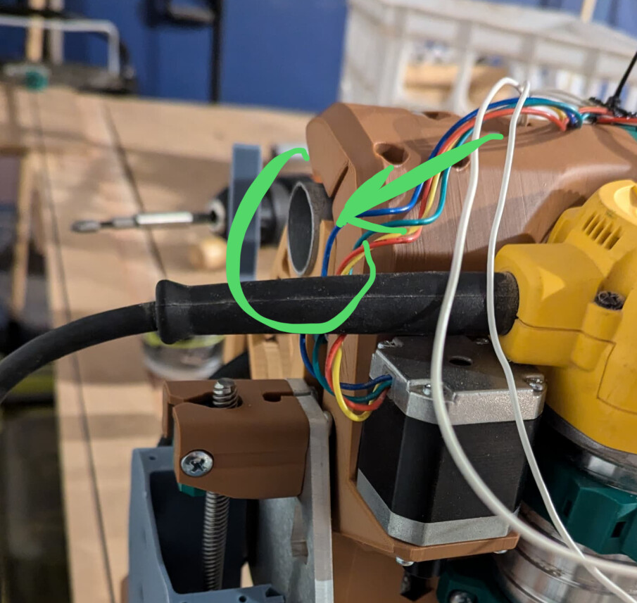

I’m rebuilt a table for my lowrider 2 but ended up making just a half a millimeter too thick so there was always a 50/50 chance it’d skip steps. Decided to upgrade to the 3, procrastinated until the four came out and decided to actually build that one instead. Seemingly going well so far, though I did have an issue printing out the core. I decided to risk it anyways after printing the second time and everything seemed to fit pretty well.

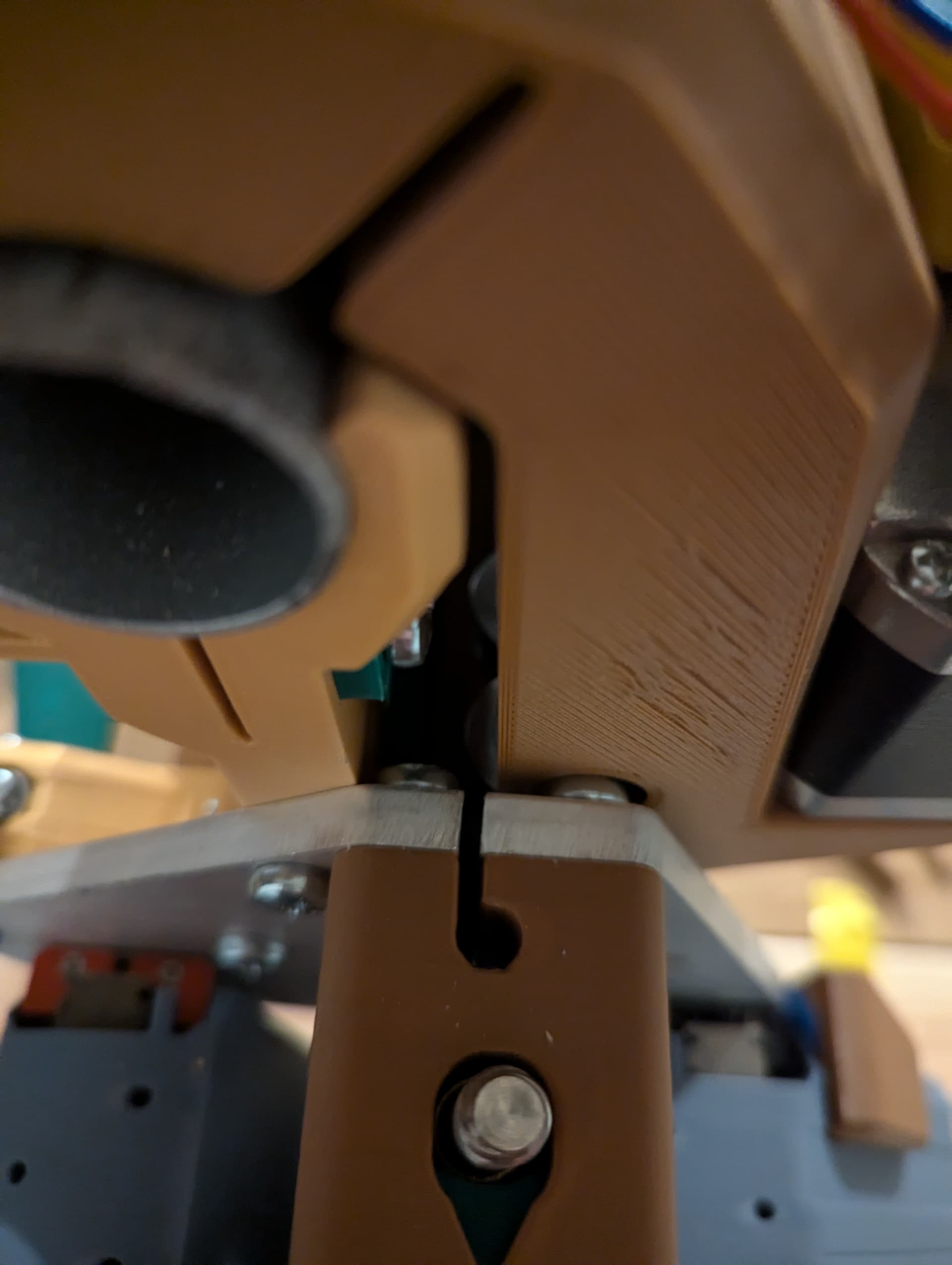

That is until I tried homing x. It doesn’t look like the screw is going home to its hole which won’t allow the x switch to trigger. I’m using a rambo board and the LED light on the board does go off (trigger) when I depress it with my hand. Y and Z homing is working fine so I’m pretty confident it’s this misalignment not allowing x to go far enough.

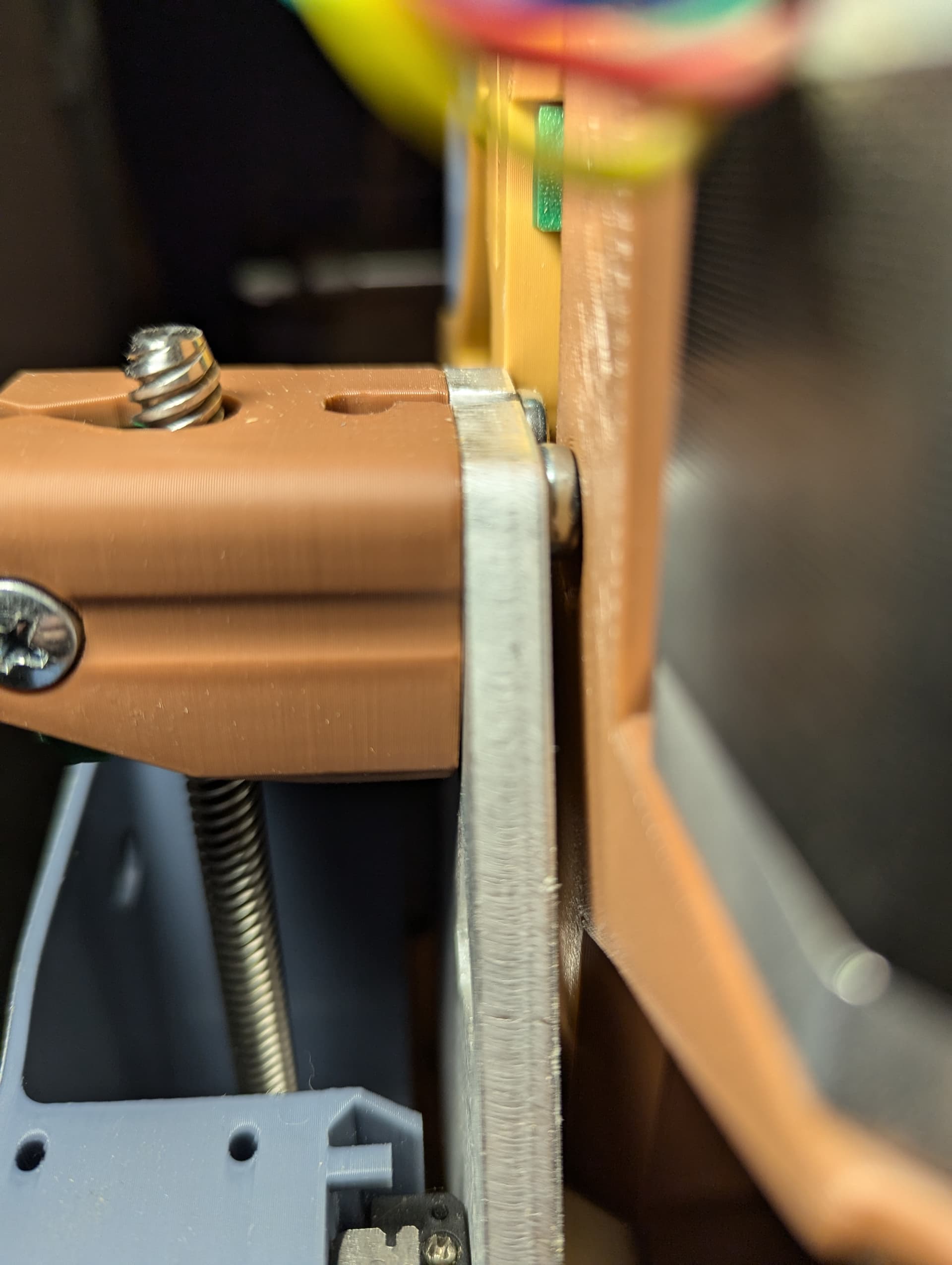

If this was somewhere else besides the first few layers and the rest of the parts didn’t fit well either, I’d try reprinting the core. However, the core fits on the main assembly fine and otherwise works moving around and the core takes a long time to print. The screw is just a little high and forward of the plate screw.
Printed my own parts, hardware and board from V1E. Could this be a different issue?

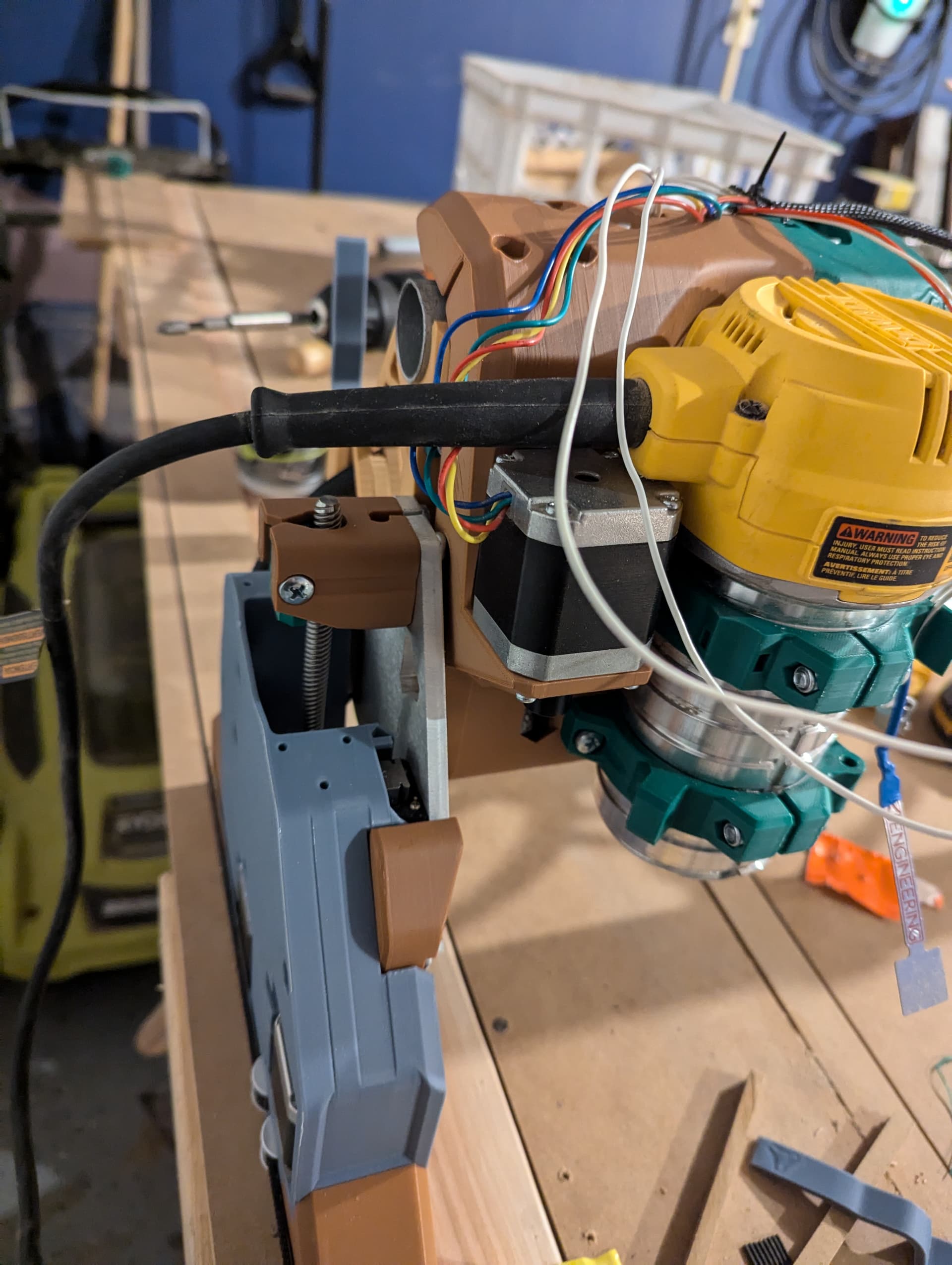

Looks almost like the rail alignment is slightly off. If you loosen your plates can you rock the rails back and forth much? Could be completely off base here but it’s possible the rails are slightly tightened forward making the misalignment.

This rail shouldn’t extend past the brace - is the bottom one the same?
May or may not be related to your issue but it needs addressed regardless.
Fixed, bottom one was good. It just moved a tiny bit when moving from my living room to the garage; it still has the temp struts on so not super locked down. Thanks for the catch!
I was going to say you could bend the stop lever out more
I double sided taped a block the the aluminum plate. The stop will work for sure, just not sure how big of an issue this small misalignment indicates
