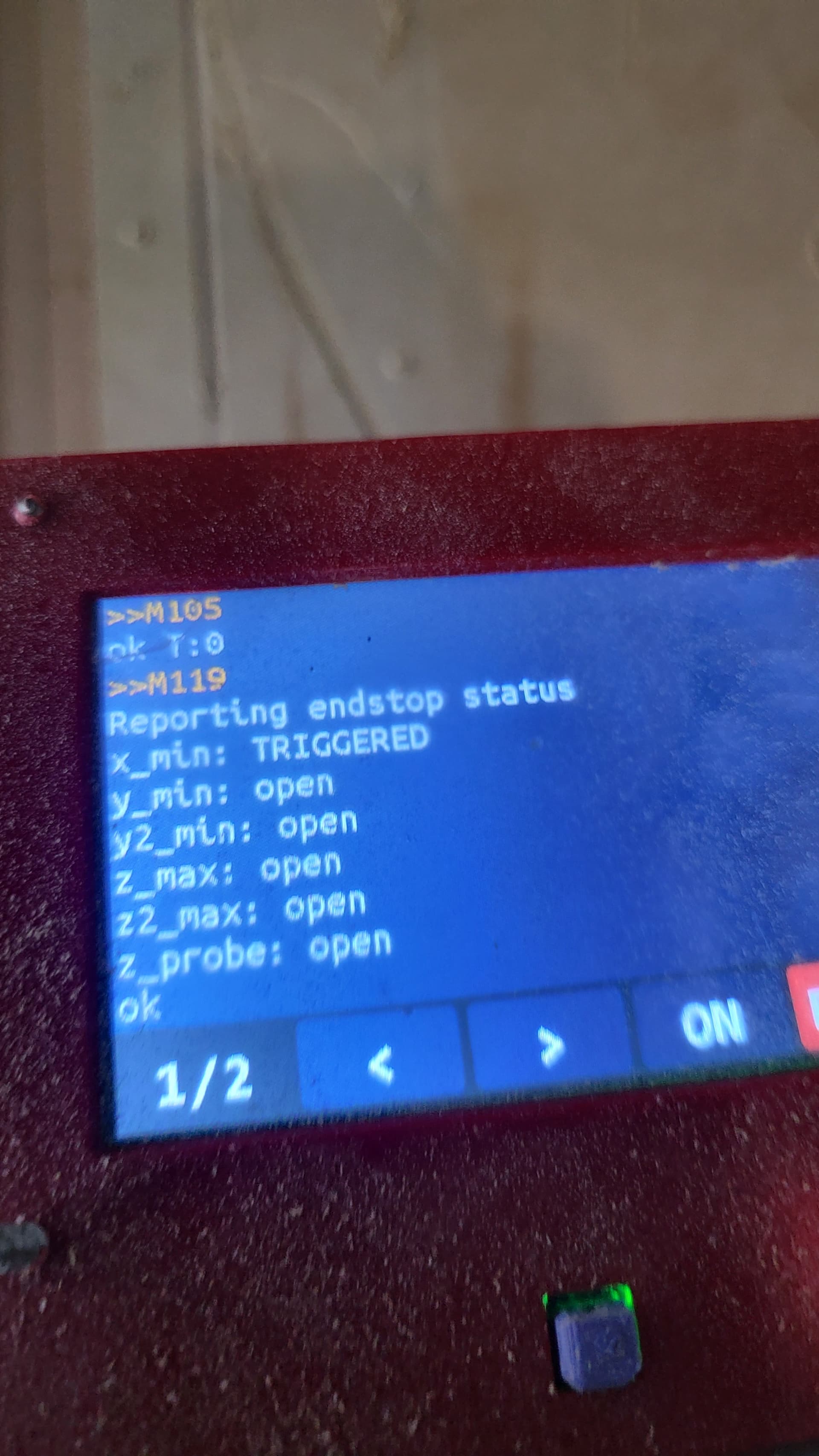

Manually trigger the endstop, then show what Marlin reports for M119.

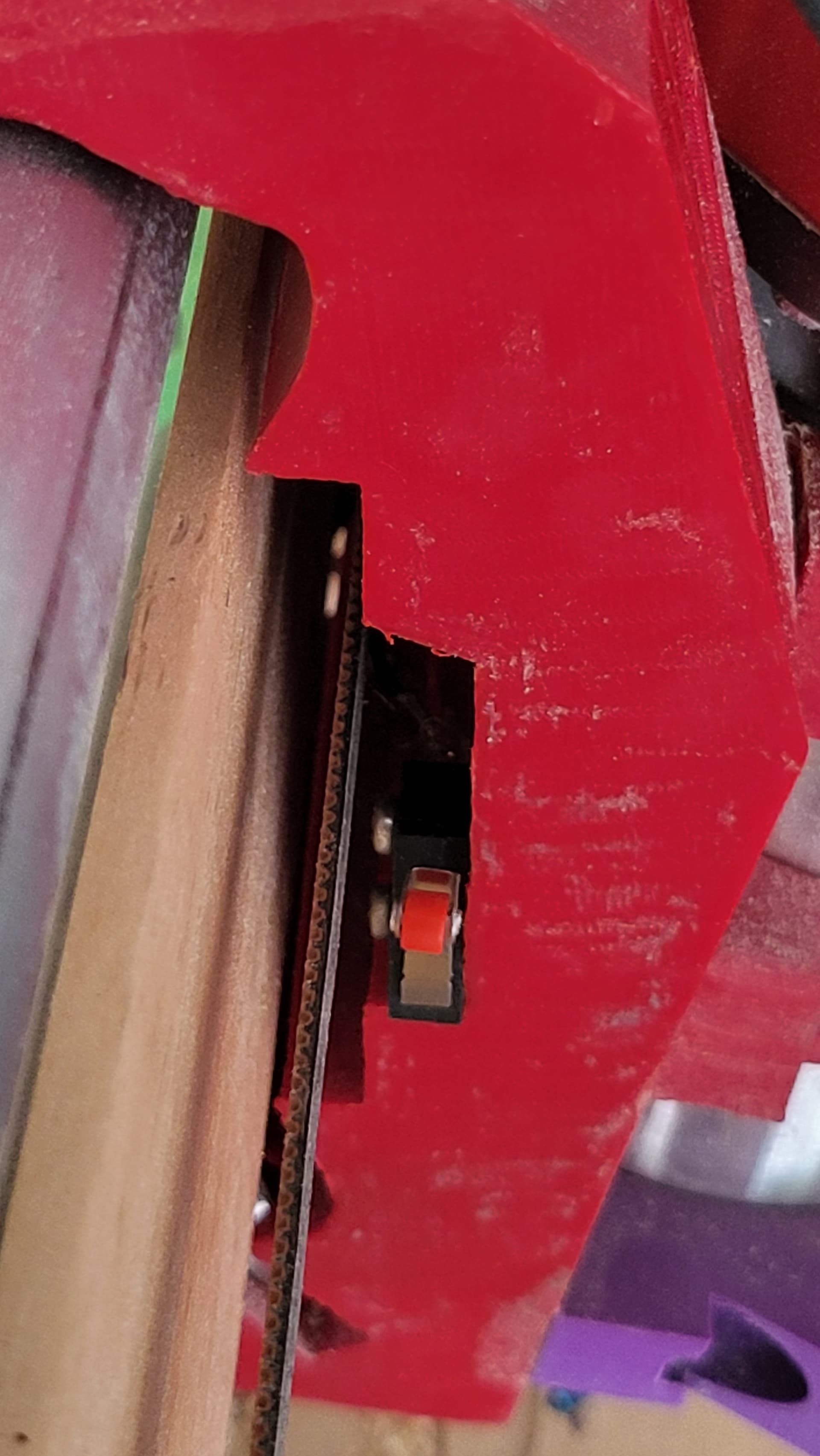

I changed out the end stops and still the same problem. I made sure all wires are secured properly. Stoll not sure what else to do. When I hit home button x, it keeps moving away about 3 mm , with each push of the home x. I habe to manually push the x to the home position before I turn it on each time. Any further ideas. I tried taking a picture of the back of the router but not enoug lighting to show proper connections.

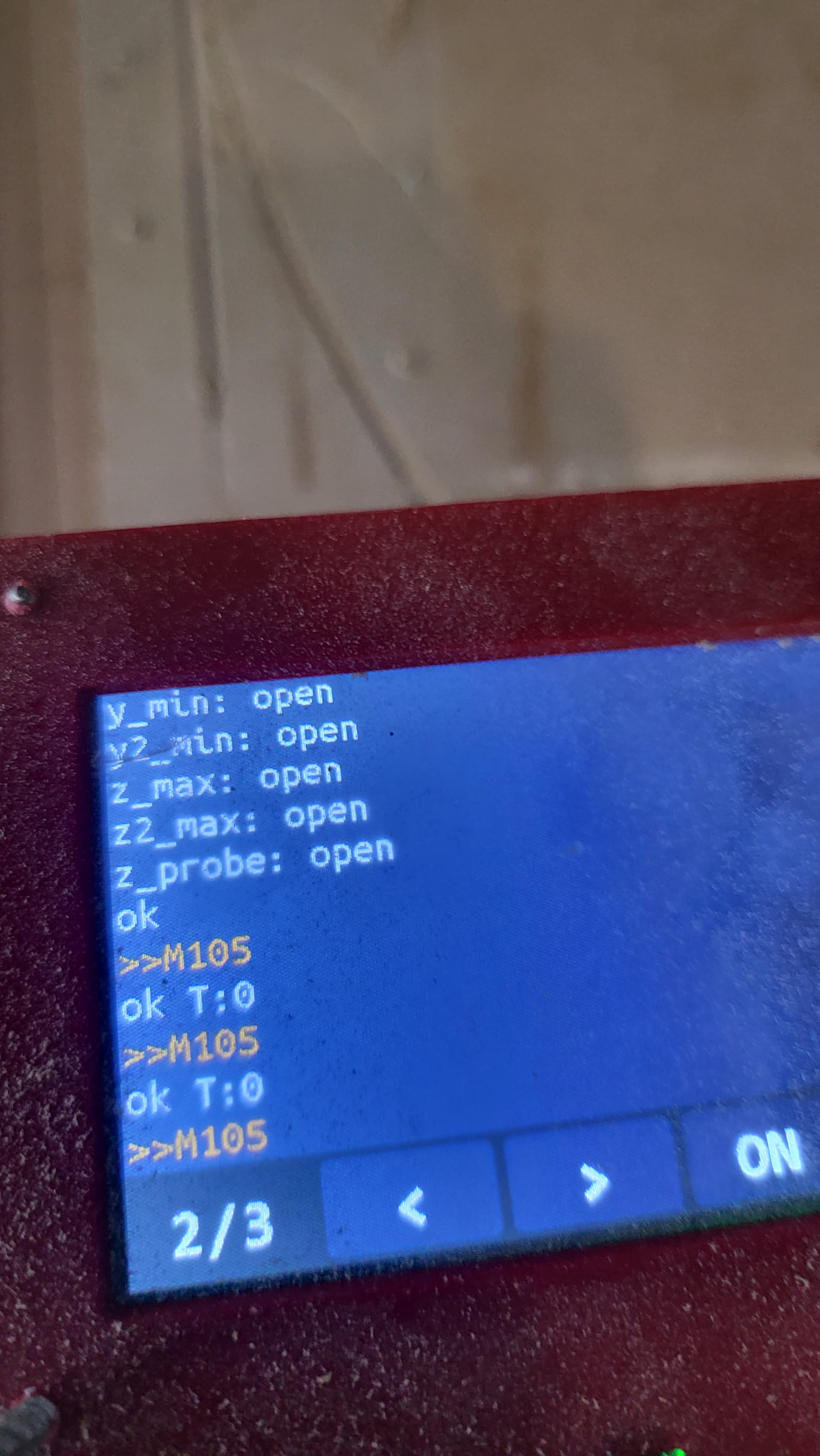

Alright so when I manually trigger it, it says triggered. When its not manually triggered, it says triggered. The first 2 pictures are me manually triggering it. The last one is with nothing triggering it.
Sure looks lile an open circuit to me.

If you are showing Triggered with the switch pressed as well as the switch not pressed, then you have an open circuit somewhere.
I would suggest using an ohmmeter/DMM to test the wiring from the Dupont connectors to the switch terminals. With the switch in normal position (not pressed), you should have close to 0 Ohms between the two Dupont terminals. If not, meter out each wire individually. Also meter out the switch(es) between the COM and NC terminals (0 Ohms when not pressed, OL when pressed)
If you do have near 0 Ohms for the wires and switch, then the issue is probably with the Dupont connector to the controller board. Did you remove the plastic JST shroud from the SKR board? Leaving it in place can prevent the Dupont connector on the wire harness from making contact with the controller board.

I believe that the problem.is with the switch or the wires. If you want to test the board and firmware, put a jumper shorting the signal wire to ground. M119 should show OPEN. If it still shows triggered, the problem is on the mainboard, otherwise it is definitely the switch or the wire.
