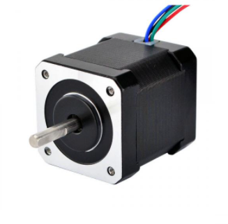

just googled the nema17 steeper’s locally in nz , would it mater if they are 2.5A and not 2A as the link in the v4 parts show
as cant find a 2A in NZ
No that wont matter at all. As long as the holding torque is the same or close you will be good.
bit more searching and this one seems to match
