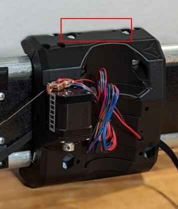

Having a bit of an issue with my newer build, tried searching but wasn’t seeing much. When cutting deeper items, I’m getting a noticeable pitch in the router carrier along the x axis which is causing an angle cut. Seems as though the EMT is a bit too small, but not sure how to adjust or fix. :upside_down_face: thank you in advance!
LowRider 3 or 4?
LowRider 4 you tighten the core using the bolts on the top 2 bearings.
You want to do this using very, very light turns. Just enough that it can’t rock anymore.
Yes I have the 4. Thank you for the help, removed the belt and tightened it up. Will try cut tomorrow!
