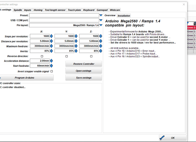

Gyday Guys

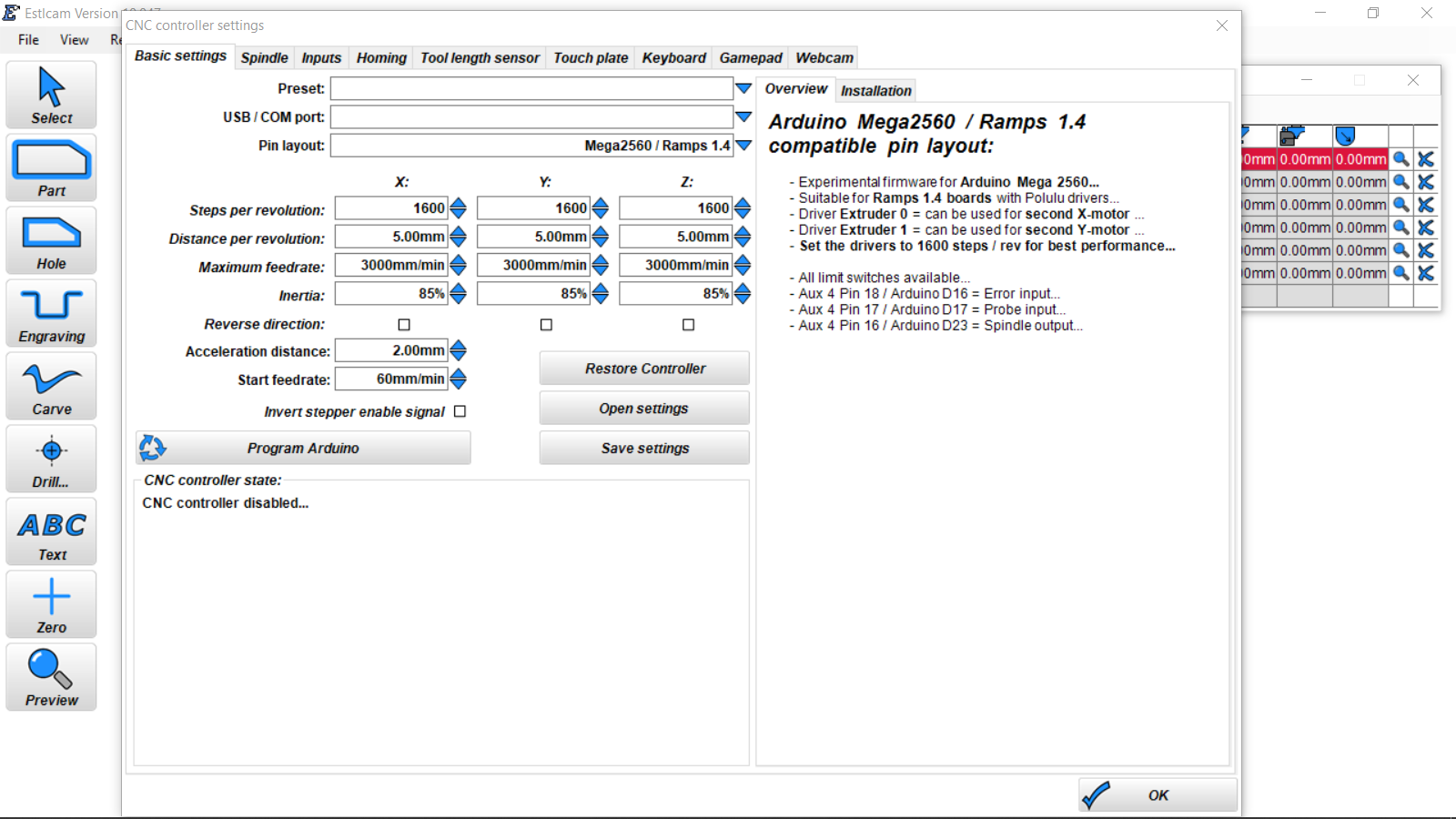

Iam having a similar problem, with the X axis, using Estlcam controller to a ramps board , on a machine I made myself, not bad for a 77old fart!
the X axis Jerks and misses steps when traveling from cut to cut? the cut-outs are good and steady. it seams to me that the speed is too fast, have tried to alter the settings, but some weird results?? am using these settings ,see screen shot.
can any one explain in layman’s language how this screen works.
As far as I know Ramps is no longer supported on estlcam control. It would be easier for most of us to help you if you used marlin on your ramps.
Thanks Ryan
am using Arduino/ marlin
see screen shot of setting that I am using, it works but it isn’t correct.
Lloyd
The screen shot you are showing is estlcam control, it will overwrite marlin. If you want to use it even though it is not supported I have an old post where I detail the settings and math involved.
Otherwise I suggest you start here, https://www.v1engineering.com/assembly/software/
