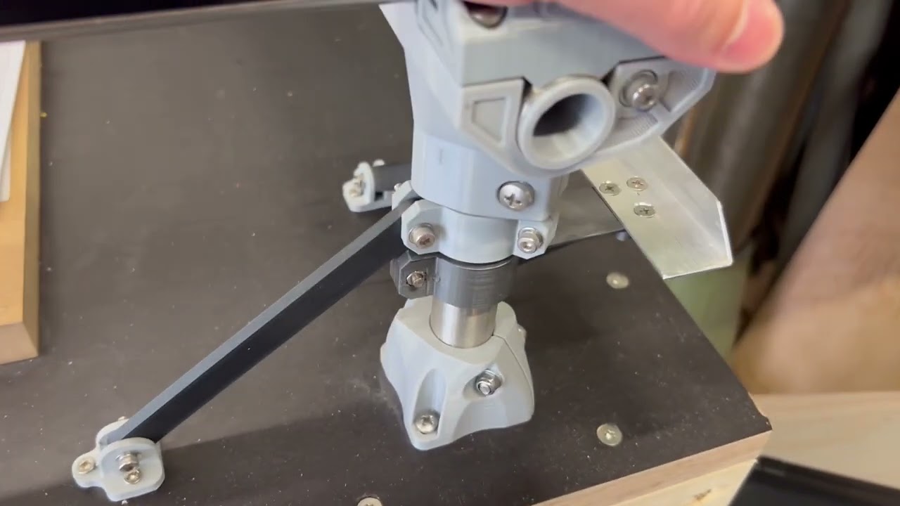

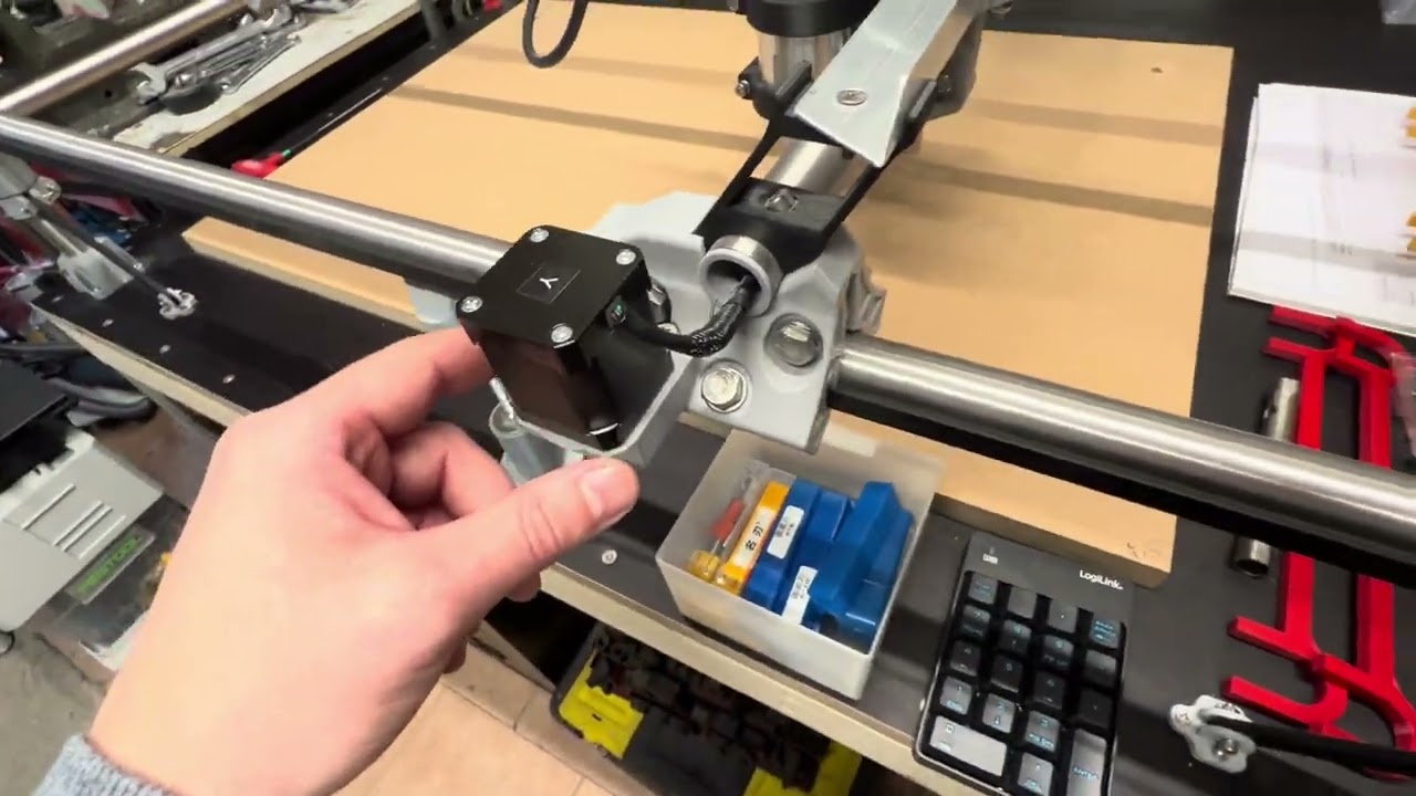

I am still very new here and am not quite sure if I write everything correctly here. Please forgive me if it should not be so. I have built a Primo and (as far as I can tell) very well aligned. Im homing the machine with 4 placeholders and I think this is working great. Now I have the following error pattern. As soon as I move the axes
This happens randomly. Does anyone have experience with this error?

here Im with the Video of my Problem.
And thats the second one:
Thank you very much.
Cheers Mr Braun
Well, in the video I can definitely hear the motors skipping, so it isn’t grub screws.
That showed at the top if Y travel, so it would be good to check that the Y rails are both straight and parallel. Check that motion is relatively free all the way across in both X and Y with the machine unpowered. It looks OK and the Primo can actually tolerate a little unevenbess there, so improbable.
Another possibility is wiring. If you have a connection between the motor wire and an extension in that drag chain, check that the problem is not when the drag chain tries to bend at that part of the wire. I had a similar issue where one of my crimps was less than great, and when that part of the wire tried to bend, I’d have a problem.
Edit: you can check by moving the drag chain around while trying to move the axis. If yoh can make it happen or stop by flexing the drag chain, you have probably found the issue
It looks great, I really like the little standoffs that stabilize the feet. What Dan says sounds pretty solid, I can’t see any problems. Did you have a look at what happens below the truck with the pulleys and idlers? Is anything on the wrong way so the belt gets stuck maybe?

Thank you very much :slight_smile: I thought so too. I adjusted the pulleys, so the belts go right in the middle of the pulleys. But im gonna check it tomorrow one more time.

  2. When you disconnected the power and pushed or pulled on the truck, it seems too sticky. The tension on the bearings may be too high. It should be easier to move it when unpowered. A lot of the rigidity comes when the motors are engaged.

thank you so much for your help. You had the right suggestions… The problem was really the screws from the pulleys. The are silver and smooth, so its really hard to check if they are soinning freely. So i draw a line wihe the marker on them…and found out some of them did not move at all.
Now its all fine. Im gonna make my firs cut tomorrow.
