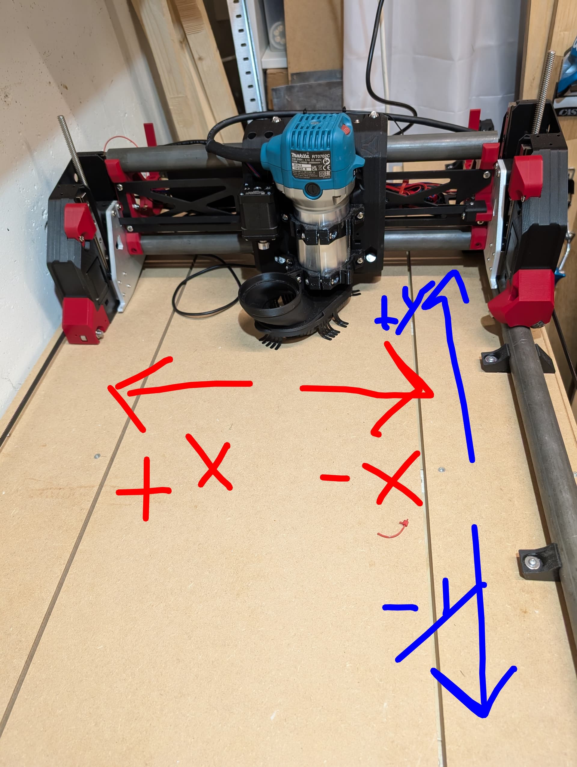

Hello I just finished setting up the cabling and I was wondering if the x and y directions are set up as they should. See pic.
Flip X.
Your +X and -X are flipped in that picture.
-X should be to the left.
0,0 should be at the front left of that picture
