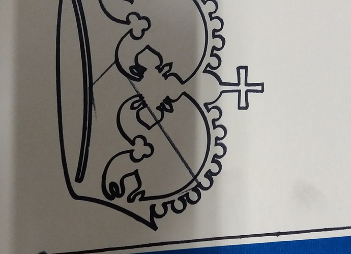

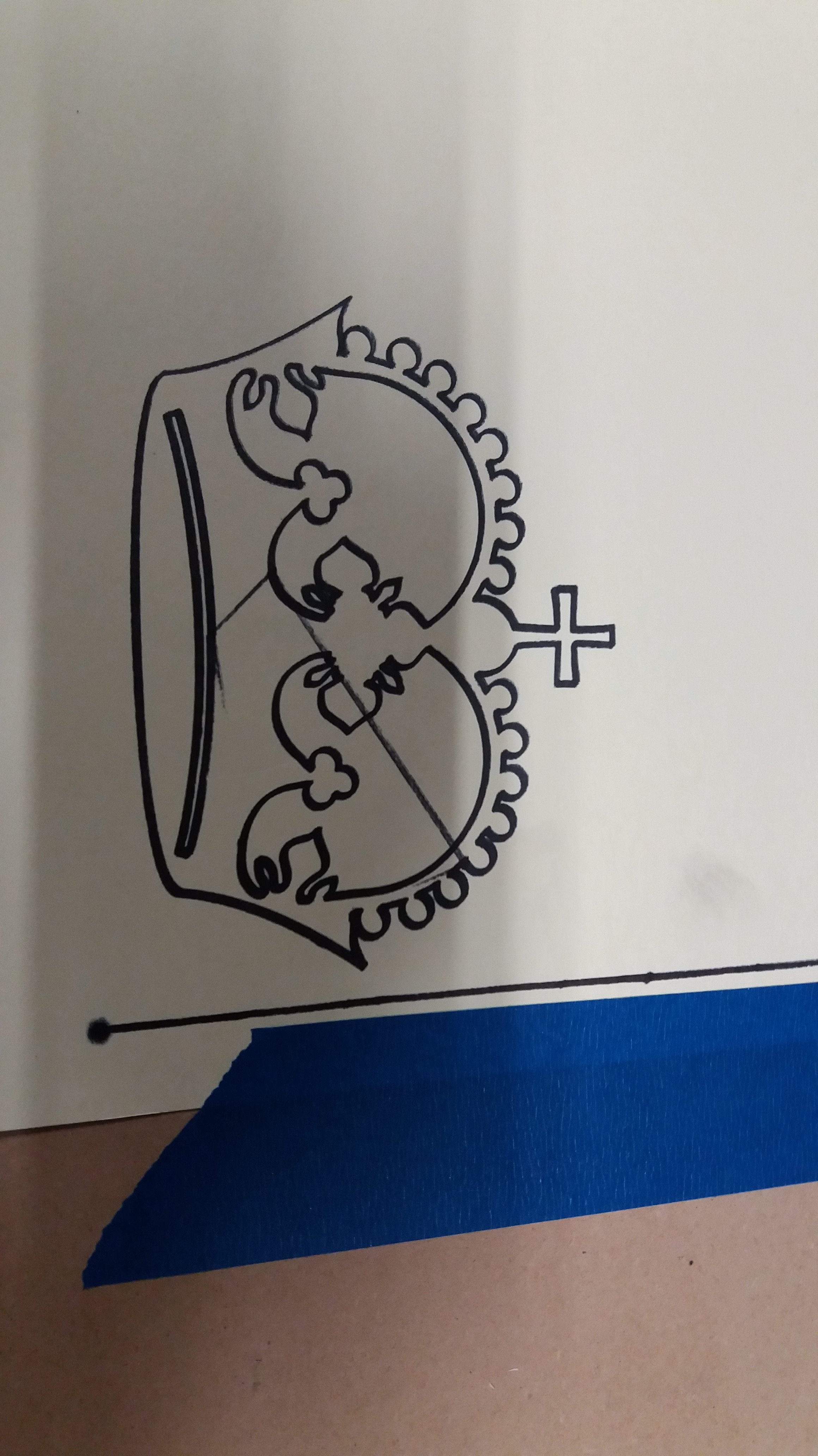

High five. The crown looks better when you’ve had to work for it ![]()
I am finally seeing all your posts together in my brain.
Looks like you do have them in series, and are cranking along. Please keep up posted on your projects. Your machine looks great.
