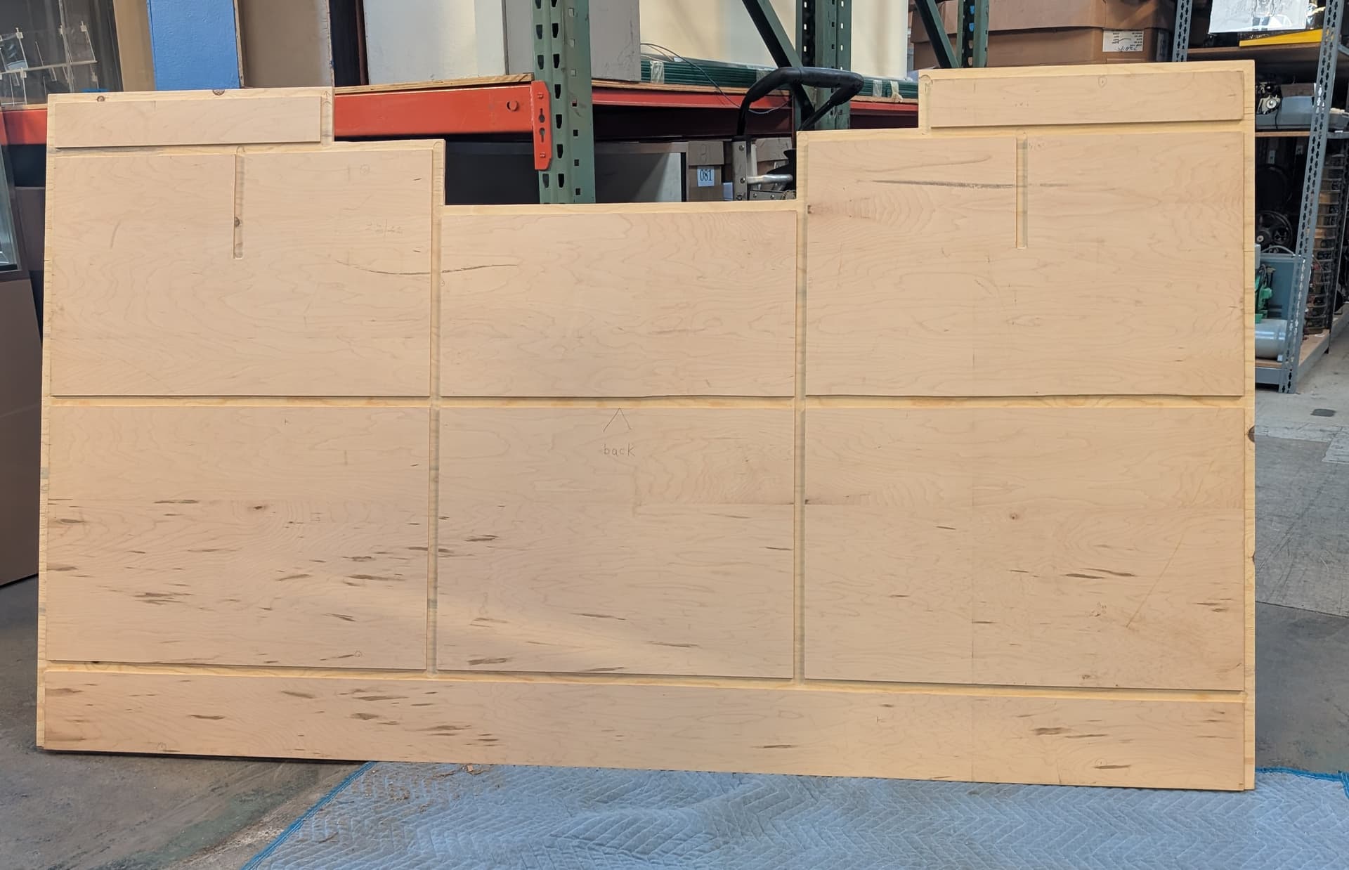

Here is the back of my miter saw bench to get a sense of what I would want to accomplish. The dimensions are 85" wide by 48" high. Plywood is 3/4" with dados being 3/4 wide by 1/4 deep, cut with either a 3/4" router bit or a table saw with 3/4" dado blade. The design is to build back to front with every piece locked in by the slots, then screwed and glued.
I still agree with the basic design and not using consumable landmarks. There just needs to be some form of secondary precision frame to allow working on larger pieces. These are mostly software/UI things, not really changing the tool requirements.
