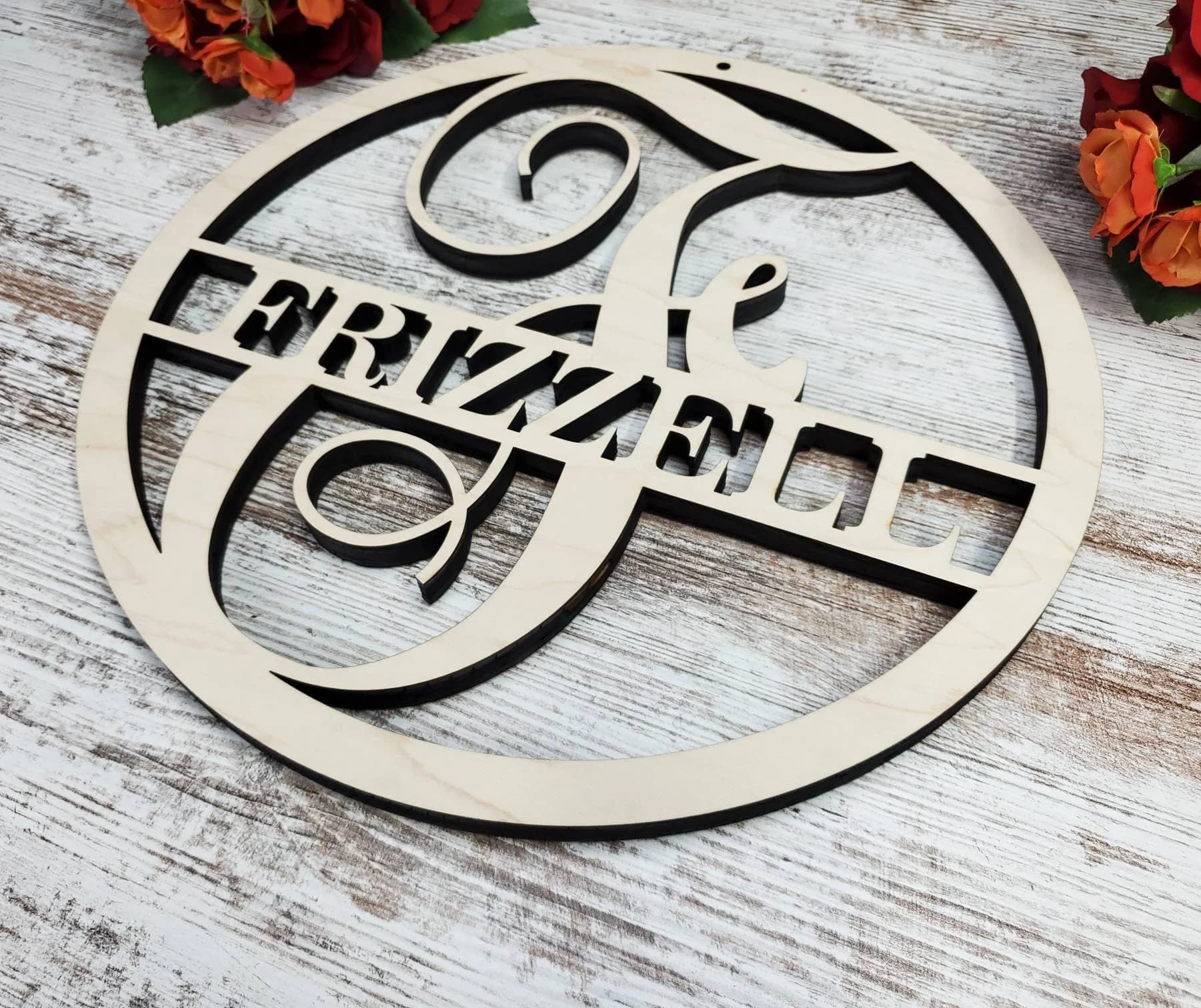

Honestly I would settle for consistency with speeds. I’m convinced that chips are myth when it comes to cutting because I’ve never seen one. Dust is all I create. The best projects I can make are monogram signs out of 1/2” Baltic Birch. Realistically I can usually do 15mm/s at 3 DOC with 1/8 single flute upcut. Some days that seems too slow, other days it’s pushing the limit. But something like this will take 1-1.5 hours for a 24” cut. I could do a shorter DOC, but it seems like 3 hours is excessive.
The big reason for the upgrade, even with the trouble, is it seems most of the things I’m trying to make get very close to that 24” mark. I’m not sure what I’m expecting from speeds, but most of the LR4 videos are showing 2x-3x of what I can successfully run and make it look easy with a 4x8 machine. At the very least, if I can obtain the performance of the MPCNC I have but with the larger cut area(3’x4’), it’s a win. There have been plenty of projects I’ve screwed up because I exceeded the cut area by just 1/2 inch.
