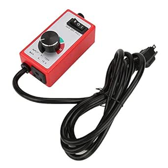

I used a router speed controller on my Dewalt with no issues at all.
