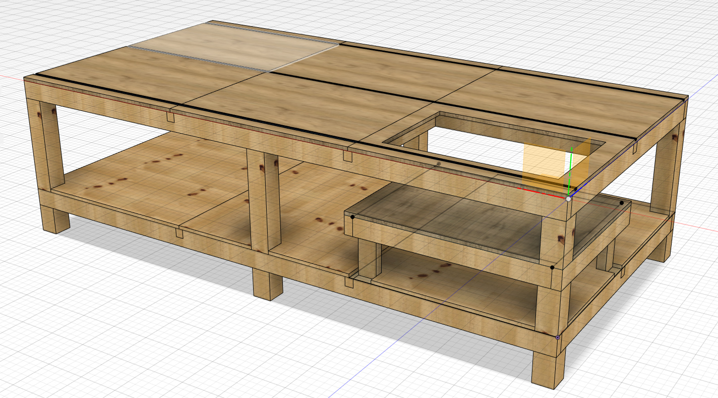

I’m about to start my build! I’ve got about 90% of my parts. I’m designing a workstation/table in fusion360. I figured I’d start this thread to document the process and get some questions answered as they come up, and post the final design.
What is the distance from the edge of the table, to the center of the roller wheels?
I will be using T-Slot to act as a guide for the wheels and also act as clamping for some other features of the workstation/table.

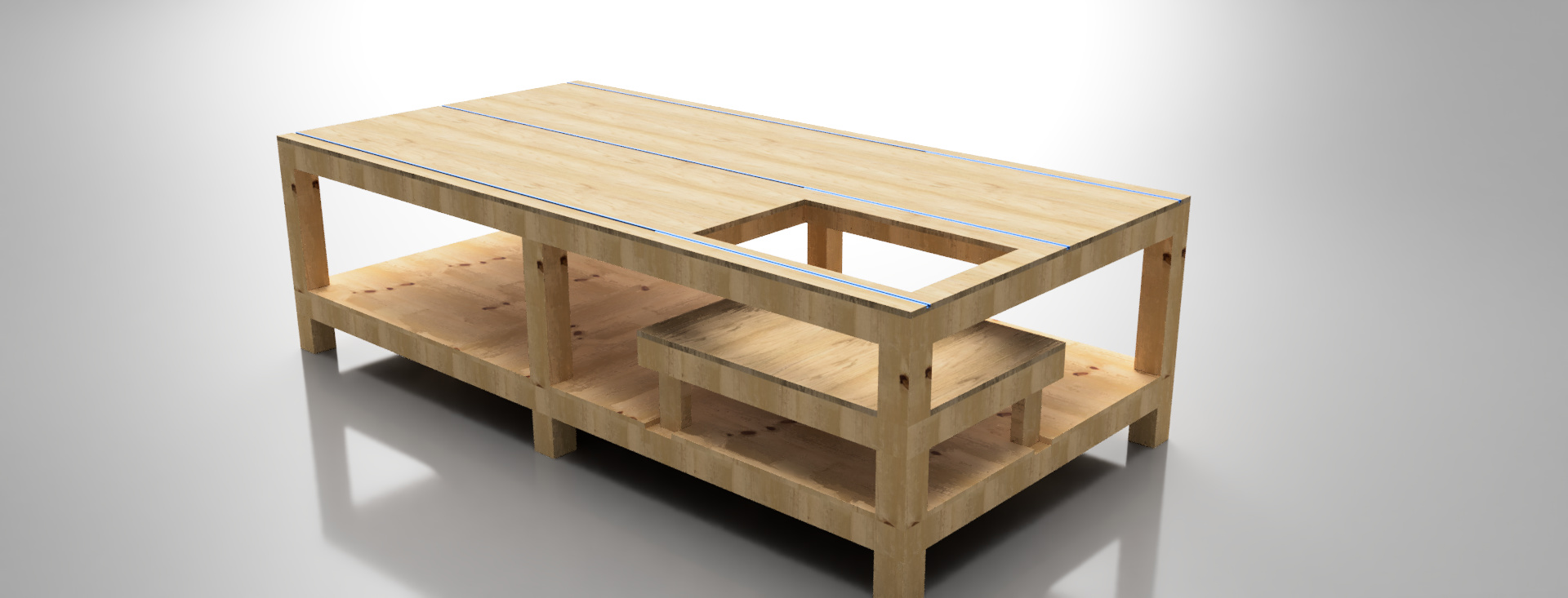

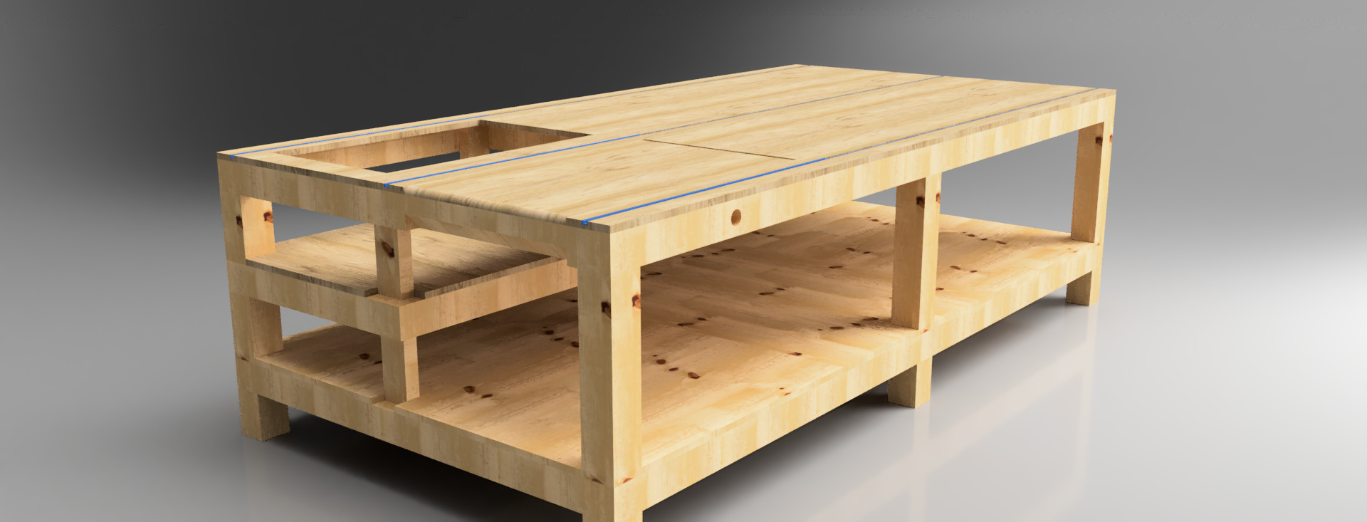

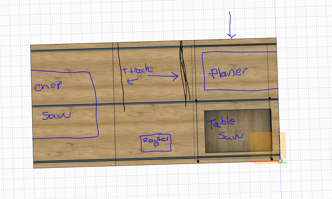

My current progress. I’m still new to fusion and its slow going. But so far I have a fully parameterized workstation, with a cutout for my table saw. I currently have it set to 5’ x 10’ but just change 2 parameters and the whole thing changes. Also parameterized is the table saw station.
The workstation top will be completely flat when all tools are folded down. They will also have “caps” put over the slots for the flip down tools so that I will have a full 5’ x 10’ table top (minus where the lowrider sits but i guess that could be removable too). When doing CNC cutting there will be a 3 - 4 piece MDF spoil-board held down with recessed bolts. The 3 - 4 piece design will allow it to be a modular, and also easy to store. While also giving me a useful workstation.
This currently meets my minimum requirements to start construction.
Additional Goals:

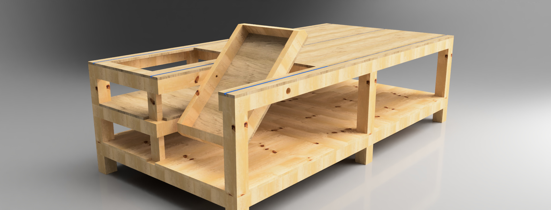

Flip down station or recessed station for Planer
Router Table slot for big router
Shop Vac Station
Drawers to store tools, parts, and clamps
More t-track
spoil-board storage
Lofty Goal:
Flip down station for chop saw
Expanding chop saw support legs

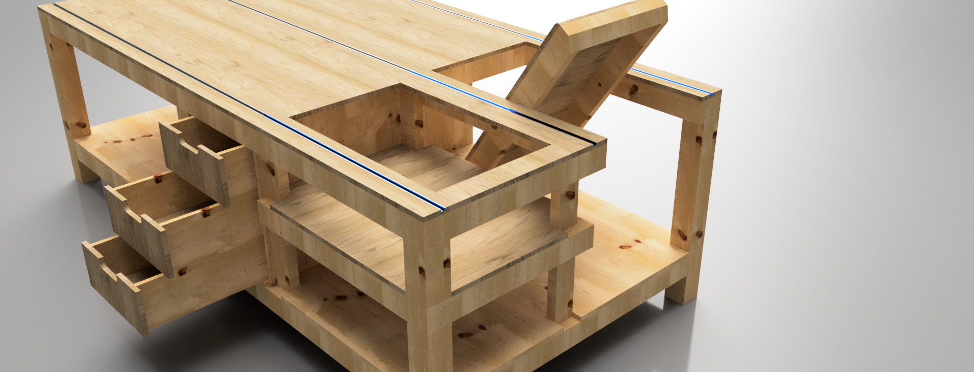

Figuring out how to do joints in Fusion360
Added Drawers.

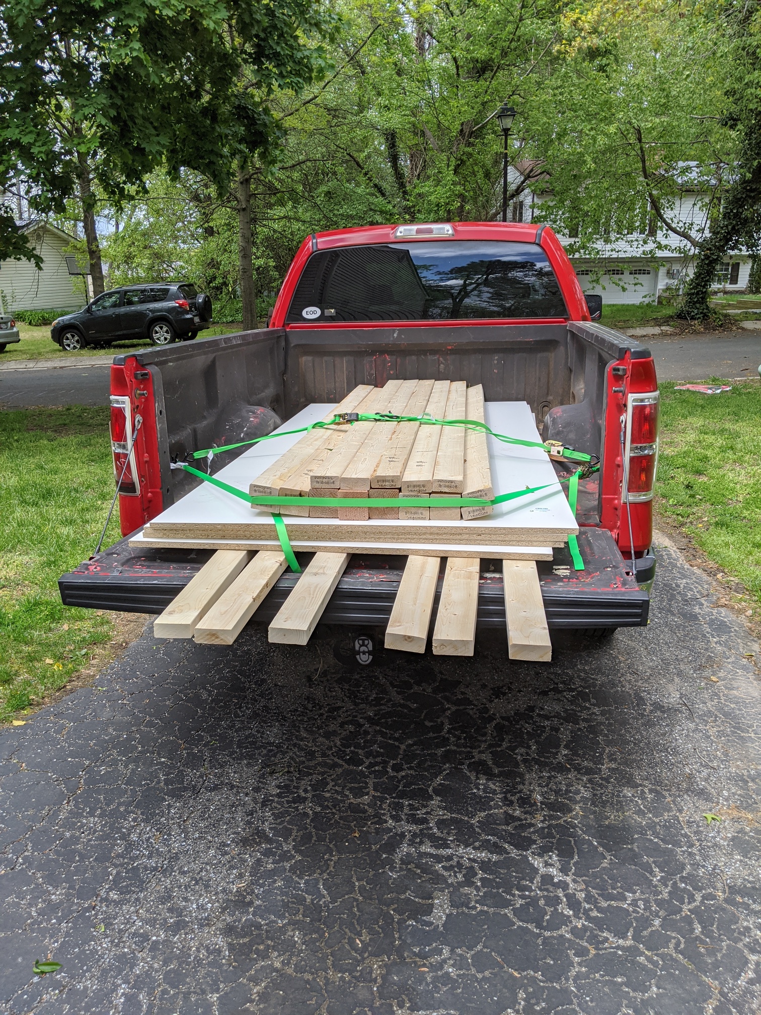

Got the first load of wood to start building.
This will get me everything except the drawers for now.
Total cost so far: $240

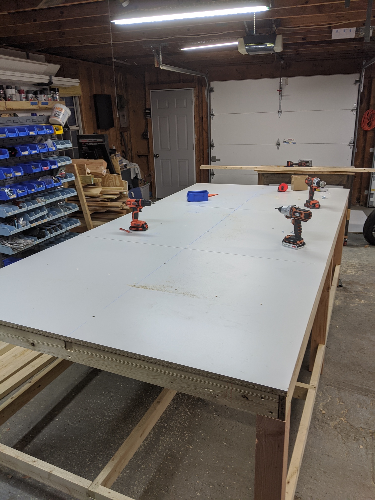

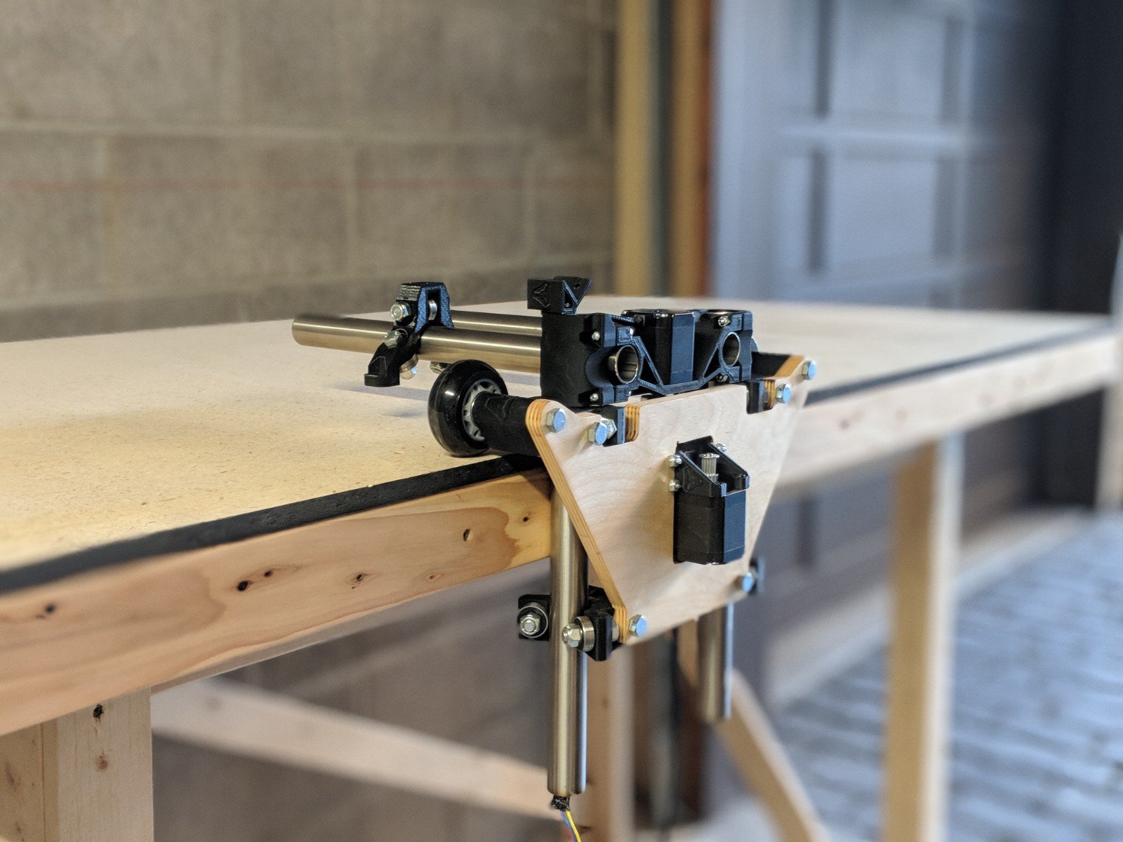

Guys … This thing is huge. Pictures don’t do it justice. Next step is putting in the table saw and some t-track. I made some adjustments to the design as I built it that will be added to the file for everyone else when I’m done.
I’ve already started thinking about how to build one with the CNC when it’s done, maybe for people on the forum to buy if there is interest.
Wish I’d noticed this earlier, but you need to leave a place for the lower Z Roller assemblies to “tuck under” the table…
It looks like the legs are flush with the edge of the top in your picture, and that’s going to be problematic.
Easy fix. They only need about a half inch of clearance, so use a 1X4 board of your choice to go around the top to dress up the table a bit, and protect the edge. Just don’t attach to the plywood, only the 2X4 under it. That way you can lift the plywood out when it eventually gets screwed up.
Your right it is an easy fix. I was planning on putting some edge banding around the side of the MDF anyway so that could be a fix. I have three possible solutions for this issue.
  1. Add 1x4 around the outside of the table
    Pros: EASY
    Cons: I wanted the table flush for features i’m adding further down the road, and this ruins that.
  2. Notch legs to give room for z axis
    Pros: Will work
    Cons: Hamstrings myself later for features I want to add. All will need the “Notch” running down them.
  3. Move T-track closer to the edge of the table, and allow the wheels to ride in that, effectively moving it further out
    Pros: Will Work
    Cons: ?? (Does the lowrider need to ride against the side of the table??)
It’s wood, for God’s sake. Go with easy. When the time comes, if your need for the feature outweighs the benefit of the edging, take it off (or take it off/section it where you need to) then. It’s not like you’re casting it in adamantium, and won’t be able to modify it once it cools…
