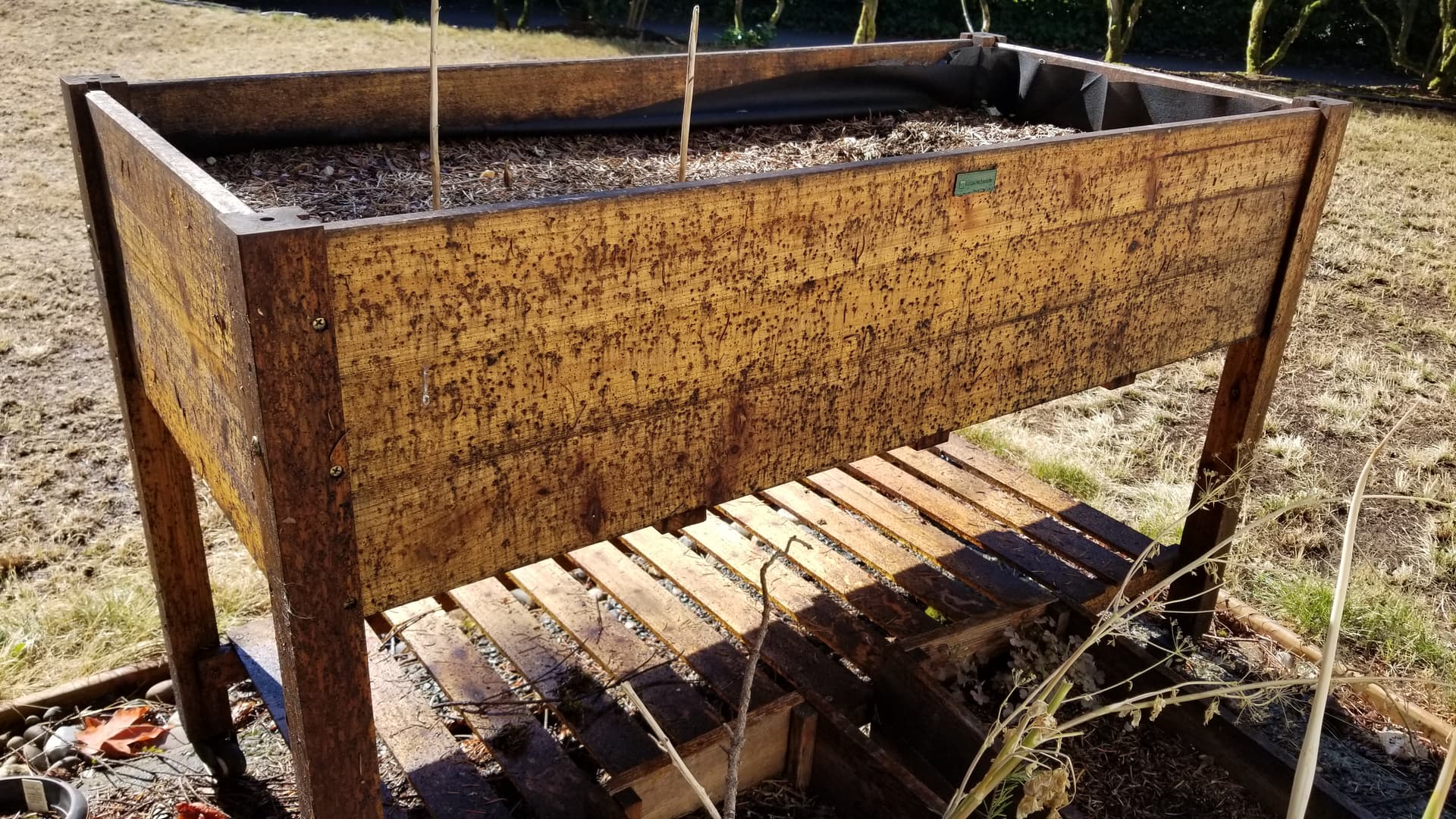

Drenched our planter boxes with thick Tung oil coats, during less than ideal temperature/humidity, poor airflow, impatiently layered multiple coats without waiting for oxidizing polymerization/hardening. Managed to achieve a sticky rancid look that’s helped avoid my better half asking me to make anymore more planter boxes… :partying_face:
Depending on what folks suggest here, am still planning to use Tung oil for future (food contacting) outdoor projects, but, will try better process than the cluster that created this mess.
