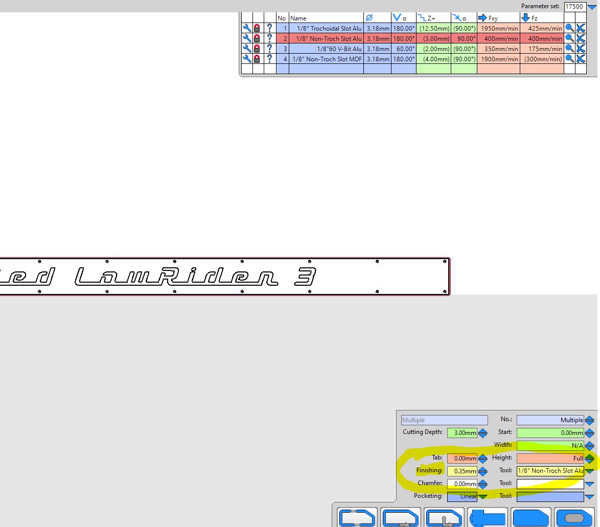

Further to @SupraGuy’s thorough explanation about “why”, for the “how”, you set the finishing pass in your CAM software. For EstlCAM, when it asks you for total DOC, there is also a section in that area to define the finishing pass:
With a 1/8" (3.17mm) bit, I use 0.35mm , or about 10% of the bit diameter.
