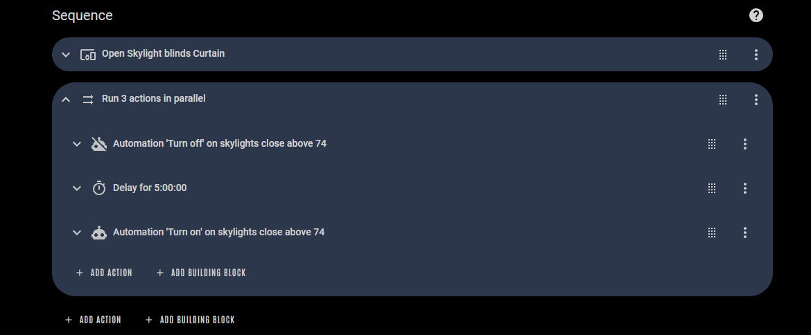

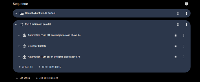

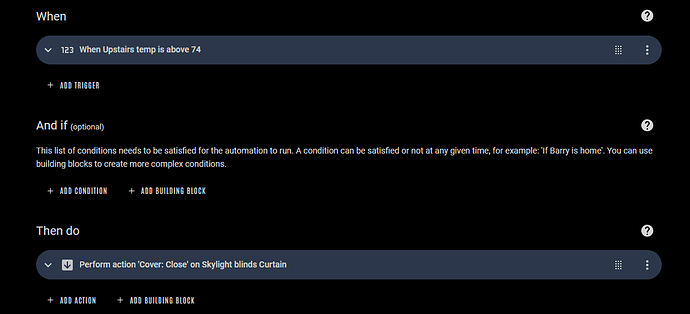

Now when it gets over 74 upstairs the skylights blinds close. Have another script so when it drops below 73 they open back up.
Nice. I tried to do this thing where our front blinds would close when the sun hits them, but only if the heater didn’t run yesterday. The goal was to only trigger at that time in the afternoon, so someone could override them and they wouldn’t keep fighting the humans. But that doesn’t work perfectly.
I changed the button on the dashboard so when you open the blinds with it, the automation that runs the temp controlled closing is disabled for 5 hours, then gets reenabled.
That’s a good idea. It’s weird it says tun those actions in parallel. That does seem like the delay would work there.
