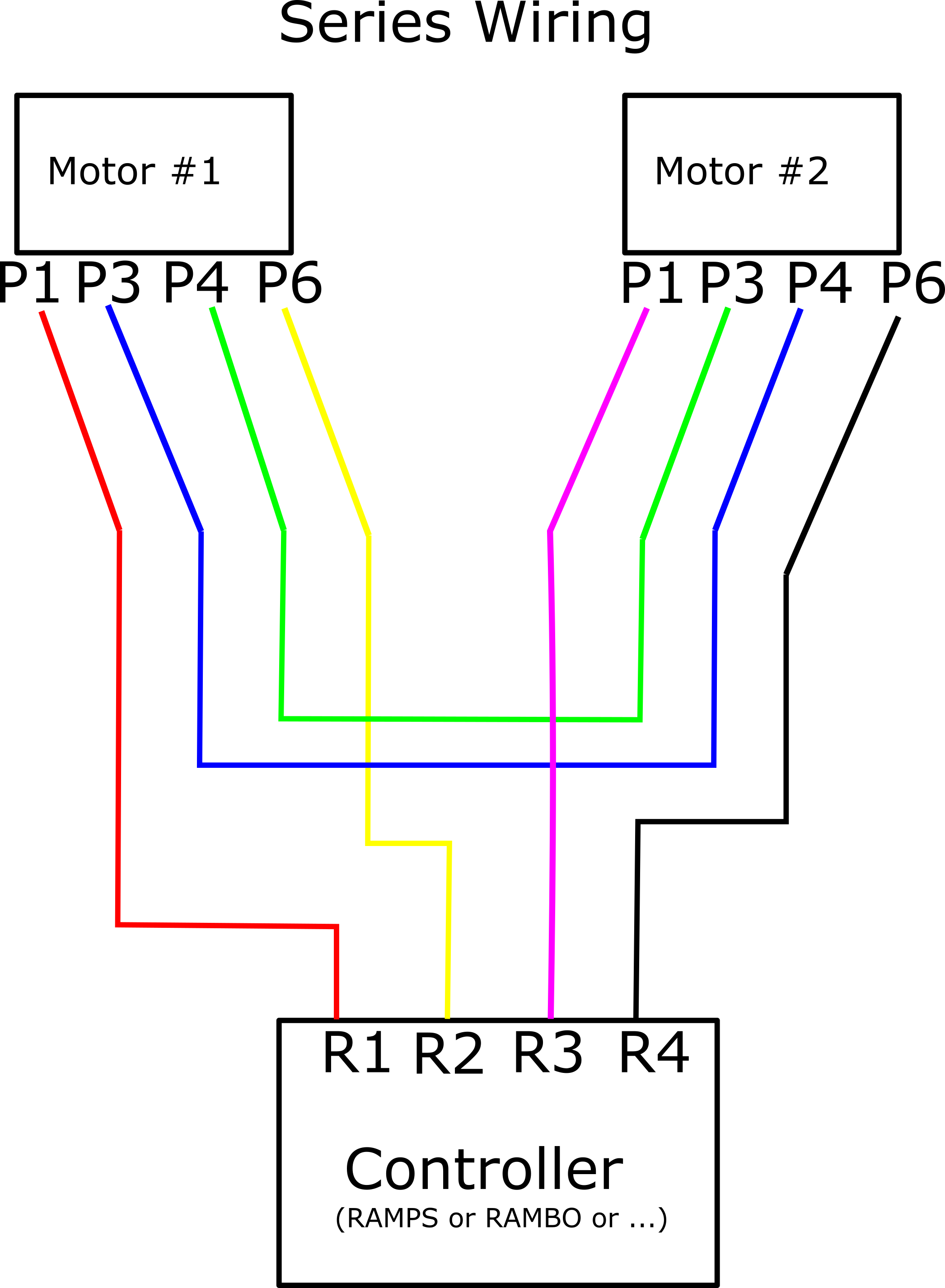

Does anyone have a simple way of wiring these damn stepper motors in a series. Steppers all have been tested on the z axis, and work perfectly fine.
By simple i mean…take motor 1 wire b2 wire it to blah blah…
  • PIN1= B-
  • COMMON
  • PIN3= B
  • PIN4= A
  • COMMON
  • PIN6= A-
For some reason my head will not compute that into a working x and y axis, and now my screen is a just out of contrast and can only be used at an angle of 175 degrees (to your eyes). I am normally good at this shit, but wtf i cannot seem to put a square peg in a square hole anymore.

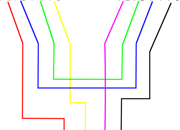

I think you need
ramps pin 1 from to stepper 1 B-
stepper 1 B+ to stepper 2 B-
Stepper 1 A+ to ramps pin 2
stepper 1 A- to stepper 2 A-
stepper 2 A+ to ramps pin 4
I’ll give it a shot. First, ignore the commons. I’ll assume your motors are all wired the same way and use the convention you have above (M1P1 = motor 1, pin 1). There are four pins on the ramps board (call them R1, R2, R3, R4) - the order doesn’t really matter because you can just reverse the connector to change 4 to 1 and 3 to 2. Here’s how I’d wire it for series:
  1. R1 to M1P1
  2. M1P3 to M2P4
  3. M2P6 to R2
  4. R3 to M1P4
  5. M1P6 to M2P1
  6. M2P3 to R4
Hope this helps[attachment file="series wiring dwg.png"]
