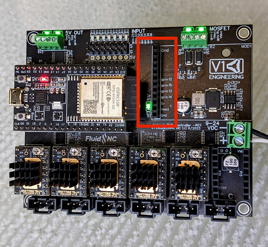

I don’t think that will work, but Bart makes a 0-10v Spindle module that works on the Jackpot
If the Jackpot can control a spindle, it can control the AMB, can’t it? I am using exactly the one you want to use (AMB 1400 FME DI) albeit with another board. It is important that the 10V can be hit pretty exactly do have the correct speed and I do not see the little screw to change the voltage on the Jackpot. So maybe not possible after all?
The module @srcnet linked has got exactly what you need, also the little screw for the voltage (R2, right side). So maybe get that module if it fits on the Jackpot and you should be golden.
We’d need to create the correct config section in config.yaml. Jackpot has only a single expansion connector compared to Bart’s 6-pack board (which has 2), so we might need to do a bit of experimentation to get the config correct.
Also check if your spindle has an RS-485 mode instead of just 0-10V. I’d think the RS-485 interface would be preferable, but that’s a different module than the 0-10V one.
Can you explain how this would wire in? I purchased a Daedalus 500W brushless spindle with a 0-10v PWM requirement and I’m facing the same issue and RS-485 mode is not indicated as available.
You would need one of Bart’s 0-10V modules, which you’d install on the jackpot expansion connector. Then you’d need to hok up the 0-10V signal and GND to the box shown in your diagram.

Are you talking about this little guy?
Yes, that’s where the add-on modules for the FluidNC boards go.
You’d need to get the 0-10V module, and a standoff to mount it on the jackpot board.
