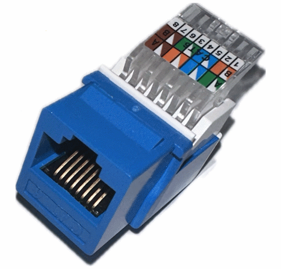

Agreed - cat5 all the way. Problem is the keystone cat5 jacks that I use on the MPCNC are designed for solid wires. How well do they work with stranded wires?
The jacks look like this:
Problem is my stock of ethernet cables are all solid.
Probably be okay. Never seen tooless keystones before. About half way down you can see how I wired mine.
