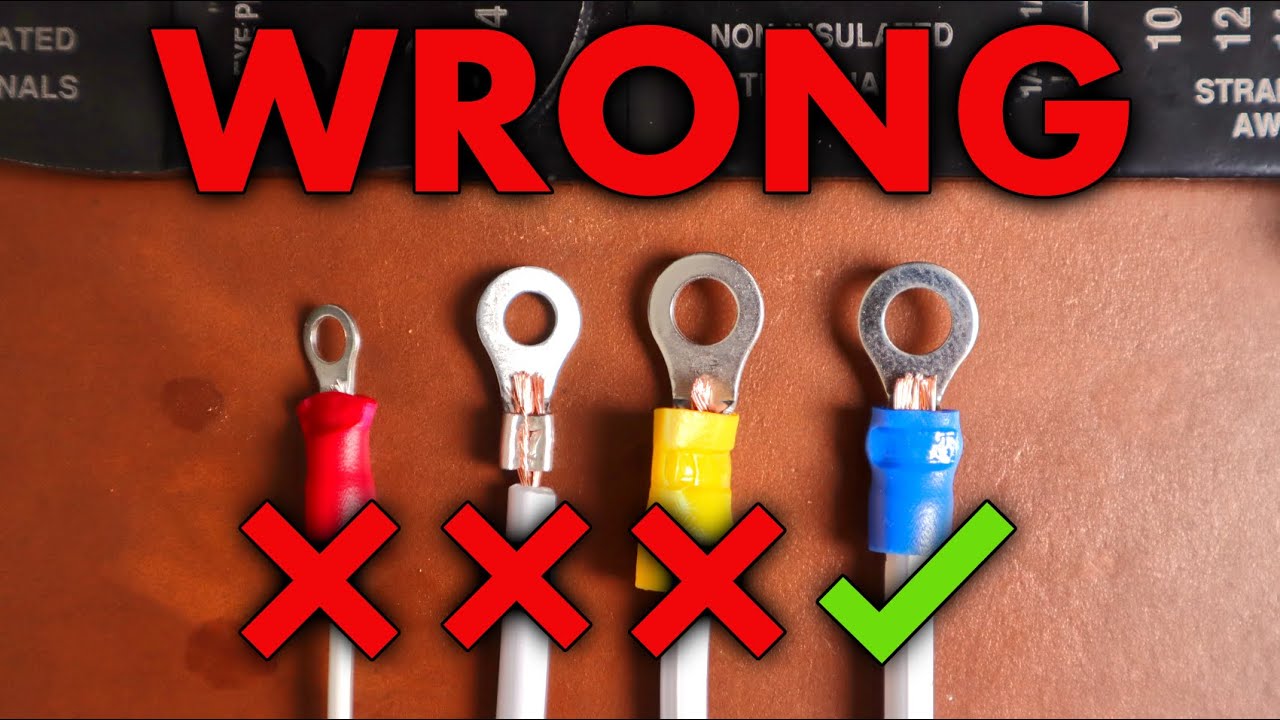

This video makes a good point about the right direction (seam split facing up or down) for non-insulated terminals, but this video makes the mistake of assuming that the same approach always applies to insulated terminals, when in fact, good crimper tools have different tool sections for insulated versus non-insulated terminals; one crimping area for non-insulated and a different crimping area for insulated terminals, so that the upside-down / upside-up rule does not carry over to the insulated terminals. If one has no choice but to use a tool made for non-insulated terminals on an insulated terminal, then presumably the Up/Down logic still applies, yet it is not the prescribed tool usage approach.

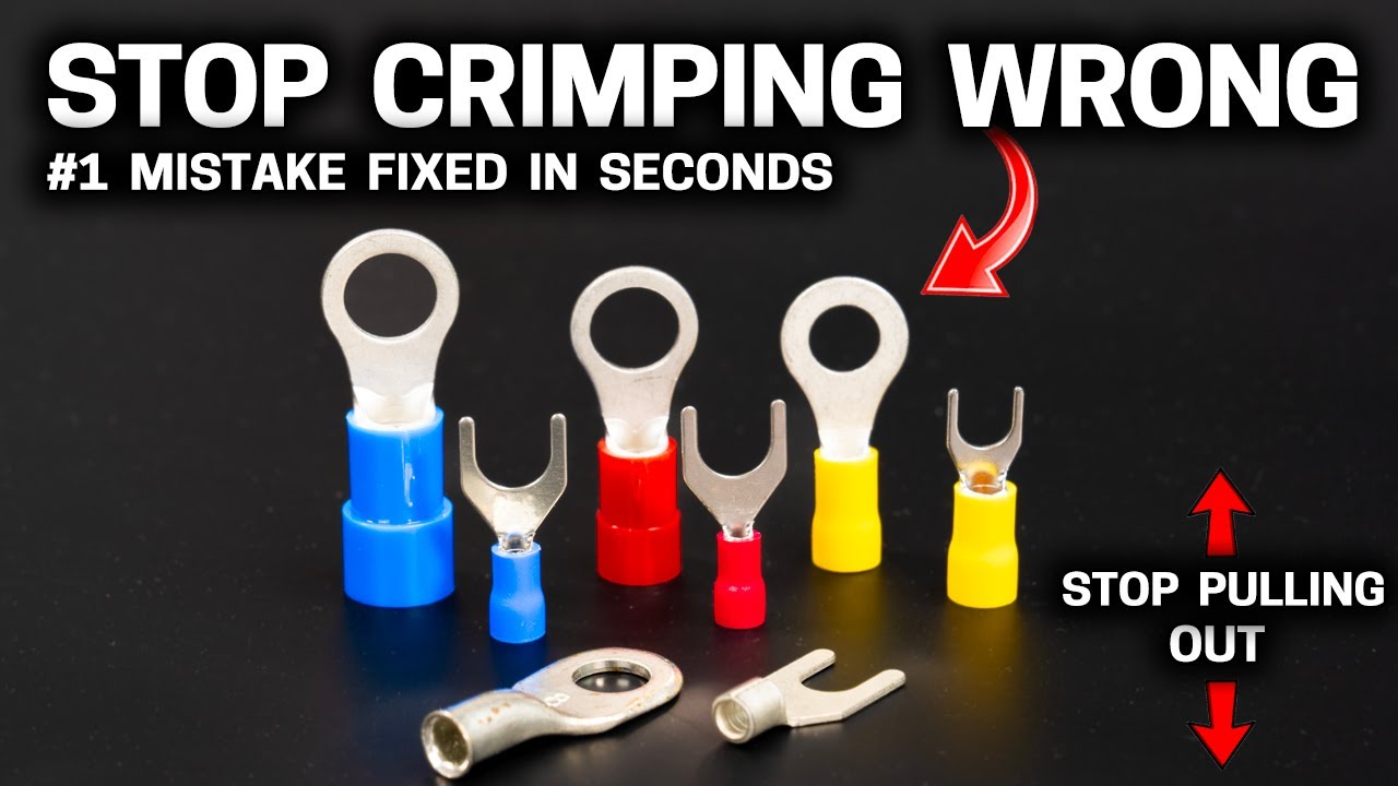

This video correctly calls out the issue of facing up or down, but also properly explains that there is a different section of the tool for crimping insulated terminals - such that the Up/Down issue is not applicable.
