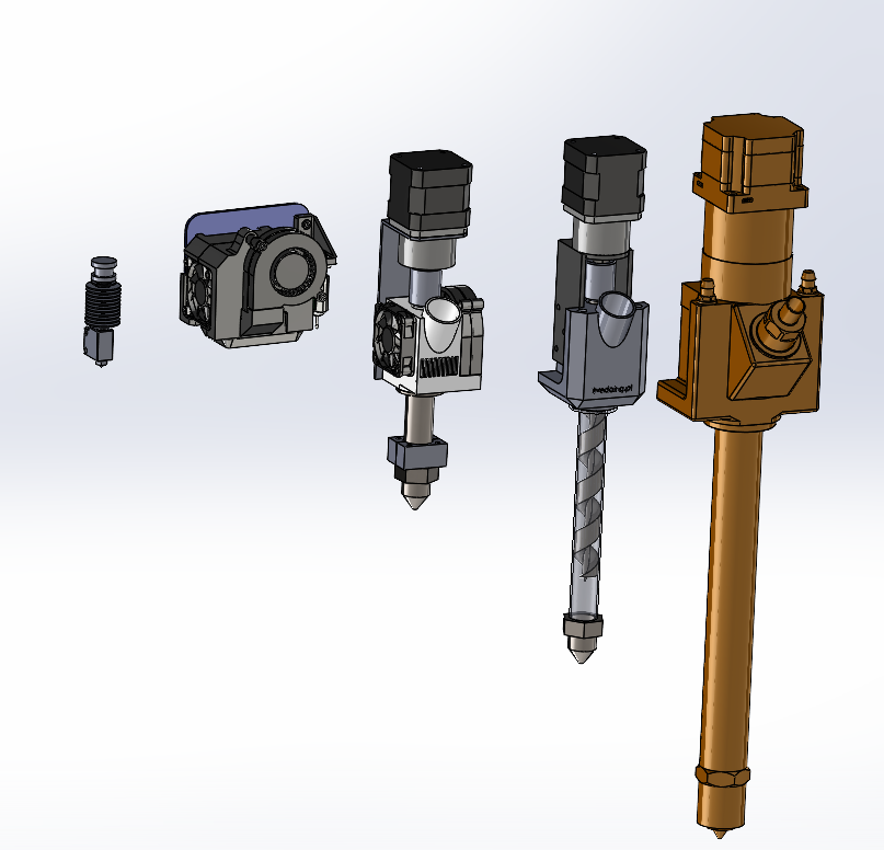

hello I am developing a new type of hotend fo shredded plastic .
I will be from time to time pst about it something over here , if someone wants to help on that project . please contact me :
my site : www.shredding.pl
thingiverse - files to print : https://www.thingiverse.com/thing:6619967
email : szabla88@gmail.com

Back to the original post- @malyboa do you have this running on a machine yet? Any machine?
Hello , I´ll post the updated design of it soon, afterwards - try to build the first prototype. But tommorow I am going on holidays. After i will be back ill start to work on it.

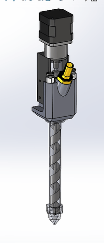

Hi , I heve been talking to a friend and we decided to - try in the begining coolling it with air . that is the first - version of air cooled hotend.
The barrel will be smaller and shorter , aluminium block ( heating unit ) - as well as small as possible , maybe - nozzle smaller.
Questions:
  • how will you avoid entrapping air in the auger section?
  • How will you ensure thermal isolation between hot end and pellet auger?
  • What parts exactly are going to be heated?
  • Have you estimated the total heater power needed?
  • Have you estimated what sections need cooling and how much heat rejection you will need for those?

to your questions i will provide soon proof of concept - because i am at the moment estimating .
that there should be no air entraping by making it - ( loose )
thermal isolation should be secured by placing heating block close to the nozzle and in the upper sections 2 air fans.
heated will be the barrel abowe the - nozzle .
total heating power should be less than 100w
i will try to figure the last question out first when ill have my prototype buildt . and that should be soon .
