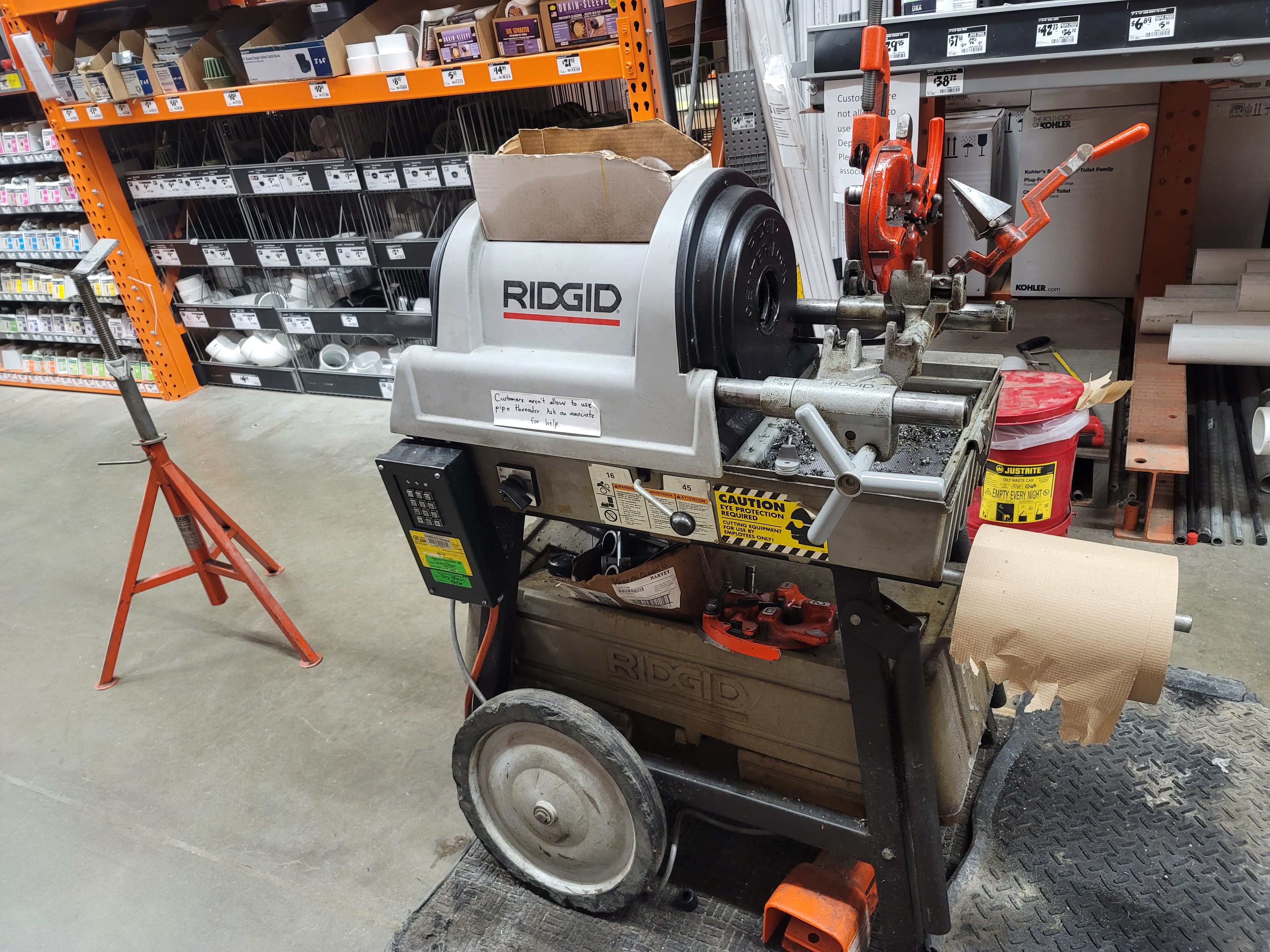

I am actually at home depot now and my local HD is awesome! See what they did for me for free. And super precise!
They used this machine for it.
Good stuff! Glad it worked out
I don’t know if it comes from relocating or if their policies have changed but I’ve found the folks at my new to me local HD far more helpful than was the case in my previous local store.

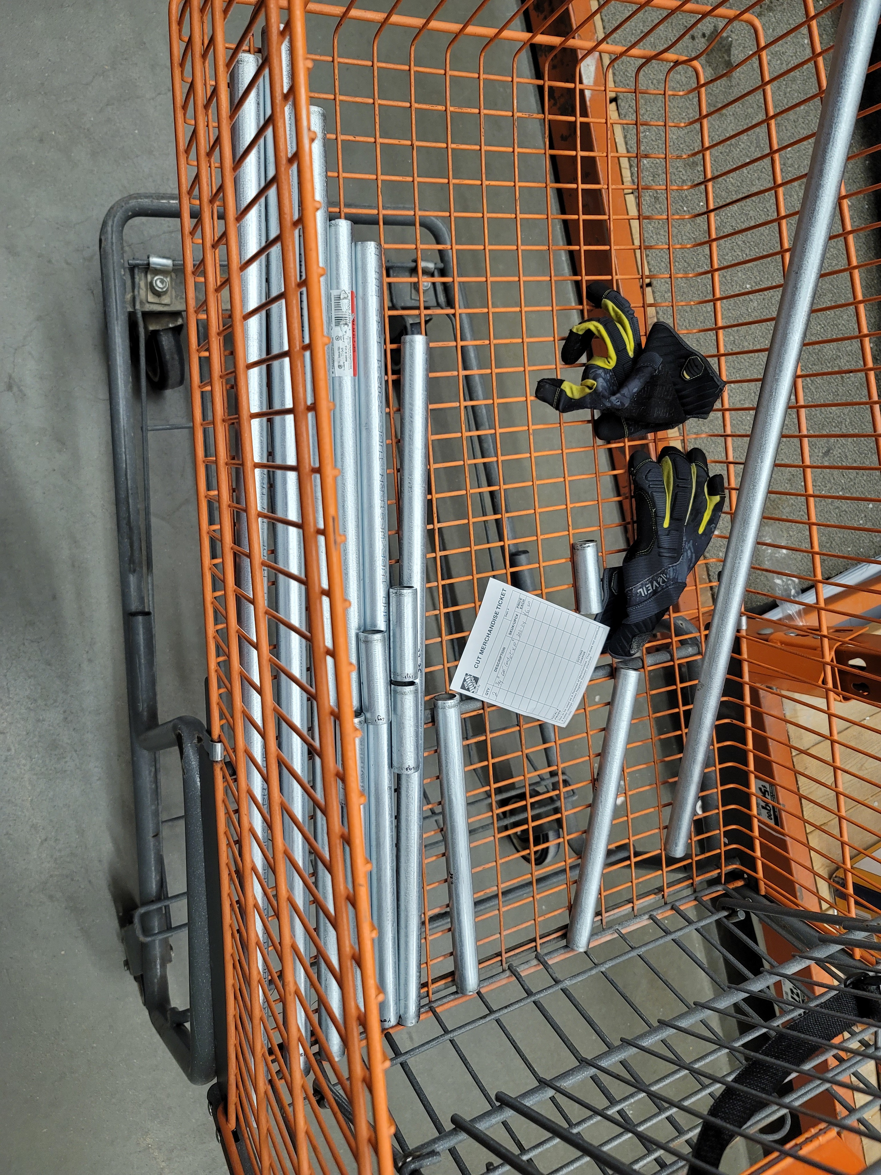

My local homedepo was awesome enough to do it for me. I was on verge of purchasing the blade myself for the grinder. I’m glad i asked the store first. I highly recommend to ask the point of purchase about it. It’ll be worth time.

Lol, i must be lucky then. I stood there with him watching him do it. He took extra time to ensure that all the little lines that i had marked on the conduits lined up correctly. I told him that it was an engineering/scientific experiment in layman’s terms, and he took it seriously.
