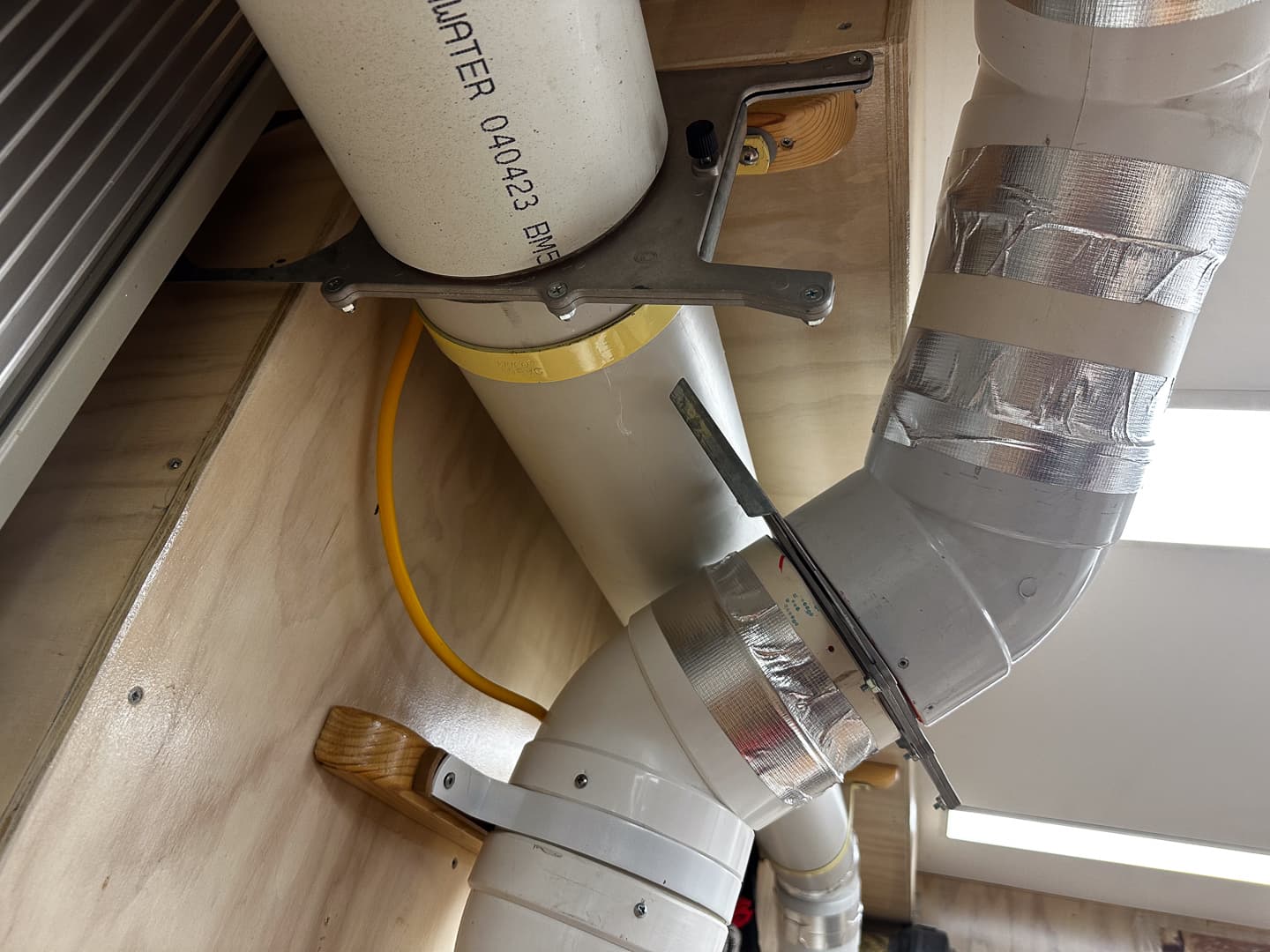

My dust collection system has 5 blast gates, shared by seven eight machines I forgot the router using my magnetic connectors, all within a couple of steps of the switch (and my workshop isn’t very large), in addition there are six machines with vac connections (using my camlock setup), two exhaust fans, and a filter fan.
Swapping between machines keeps me fit, but with all that swapping, automation isn’t possible.

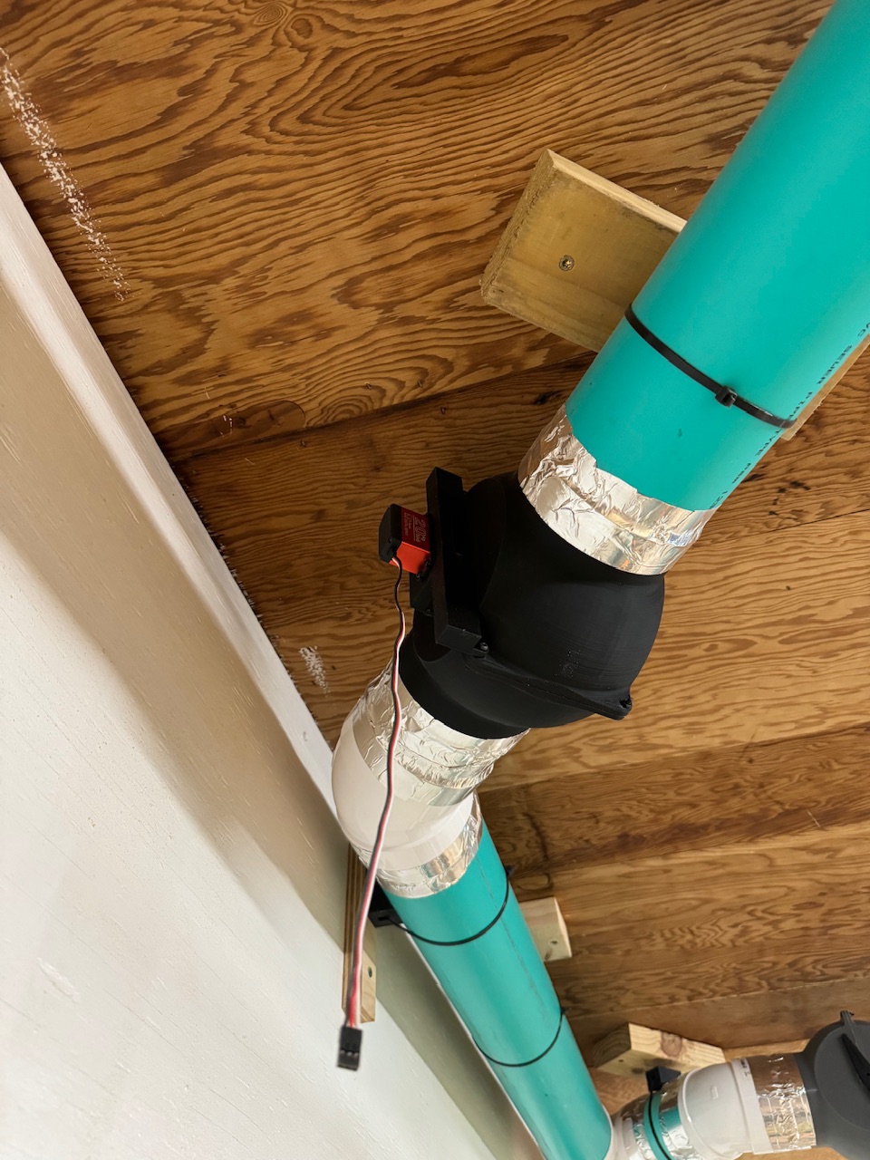

My one-day-will-be automated motorized Ball Valve blast gates beg to differ :slight_smile:

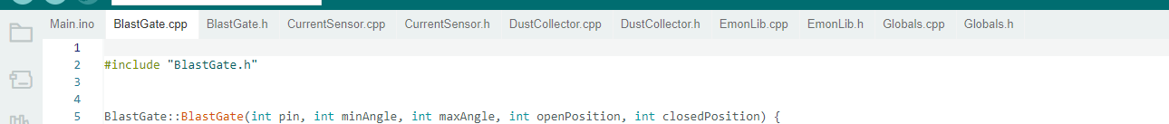

I looked into automating them with the use of current-sensing, etc, but decided I’m just going to put a toggle switch at each tool station, and manually activate the signal that will automate all of the routing.
Probably the only one that will be automatic will be the one coming from the Jackpot.
I had a bit of the code already done, as well as a bit of the all the electronics planning…then I ran across some website where people were building CNC machines…and well…it lost priority lol

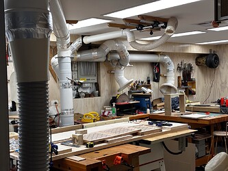

I didn’t mean impossible - just not practicable for me because I already have to move some machines before connection anyway, and my space is a little bit… squeezy AND I have 6" ducts just to add to the degree of difficulty! The prospect of using model railroad software is intriguing though…and it’s not as if it hasn’t already been done. :thinking:
Here’s 6mX3 (10 x 20’) viewed from the corridor outside. Top right is the very corner of my Jet filter, below it in the background is one of the exhaust fans (there’s another out of shot to the left - they work independently depending on which is the best air direction to clear the shop, and provide a negative pressure to keep dust and fumes from the house) - That little dash of orange is the LR3 without its fenders.
All gates for the DC can be reached within one step of the power switch. Now you have me thinking about automating the exhaust and filter though… the filter already has a remote that I don’t use.
If you can squeeze an actuator between my solar inverter and the ducting you might have me convinced! :smiley:

I always like seeing those massive bell ends in your pictures.

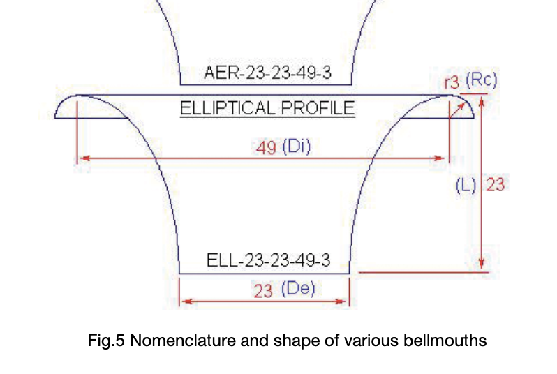

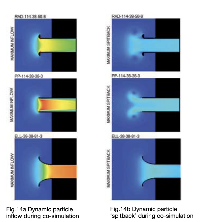

What kind of cfms are you pulling through there with those massive pipes?
From memory, the 2.5hp machine is only capable of 1200 cfm, but with the 150 pipes and bellmouths, you pretty much can rely on that - but it drops rapidly with longer runs and smaller hose. Note that my runs are short and the 4" flex is always less than a few feet. The efficiency of the bellmouth hoods is quite amazing - the (black) extractor fans have a dust covering from the vortices they create (I’m going to fix that when the Mk$ gets here!) , whereas the bellmouth hoods pull from just a little aft of side on.

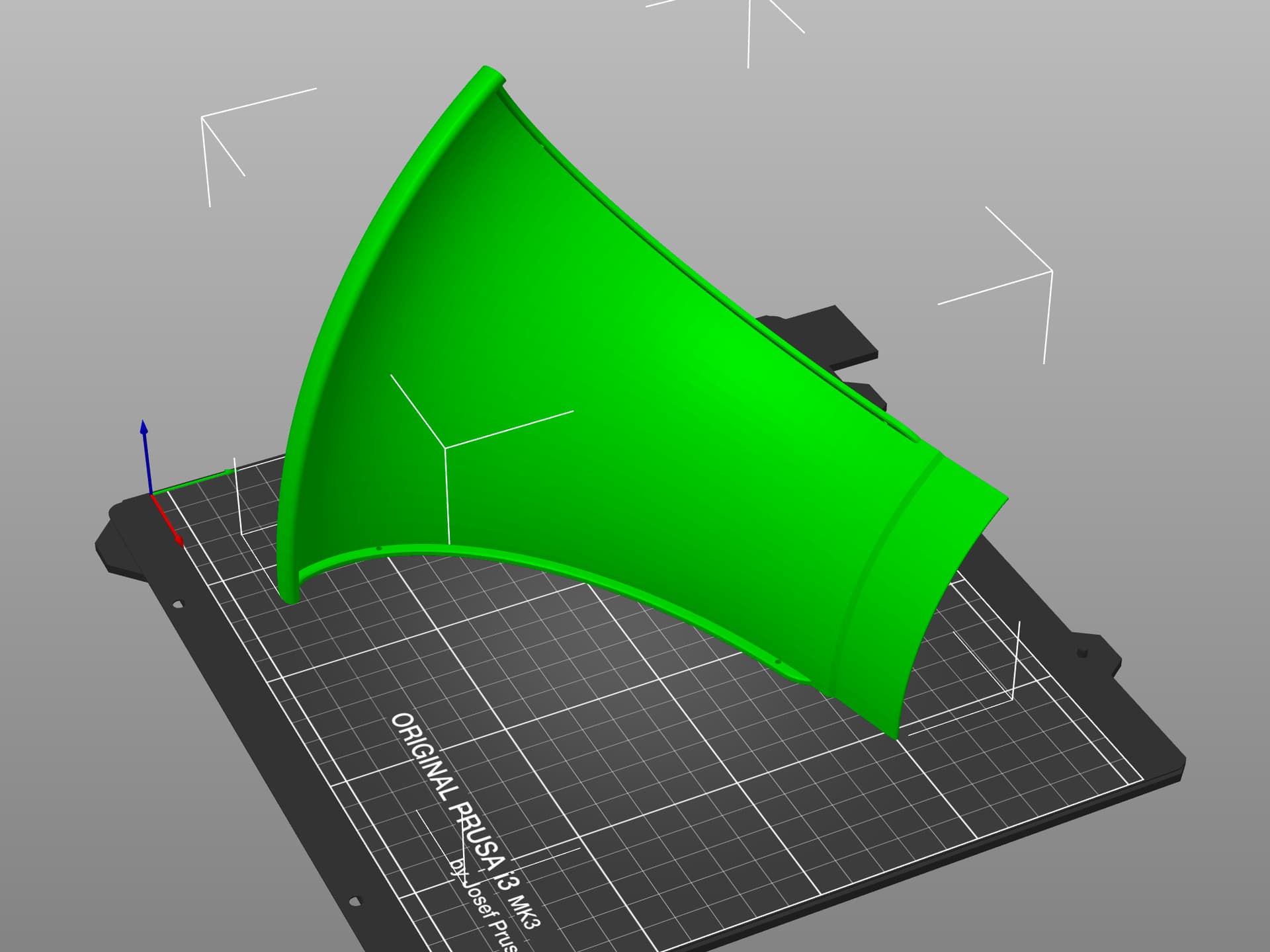

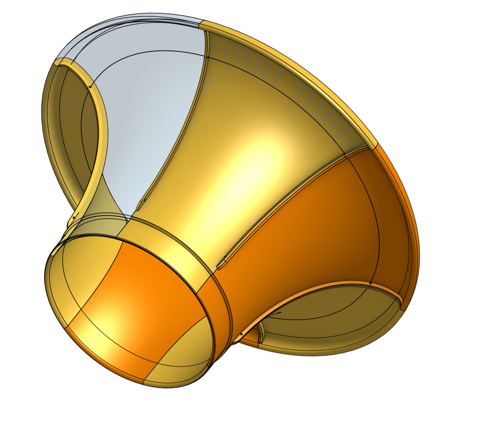

Here’s a bit of theory and the profile I’m using.
I have a full parametric version which works from 60mm to 200mm duct diameter (for a 250 printer plate) but I am waiting to build one before publishing.
Besides - they look as though I know what I’m talking about, and looks are everything!
Just FYI here’s the sketch and how they fit on the print plate (160mm duct size shown) - there are a couple of little holes in the ribs to locate with a bit of filament during assembly.
