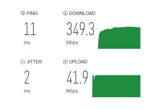

Little update, still crimping some of the new hard wires I have ran through the house. But seeing this ping and jitter on the computer that is on the second-longest Ethernet run, through a switch then to the router…then to the modem. Shoot I have not rebooted or anything I wonder if it can get any better..
Some of my best pings from this same computer on wifi were 65ms and a 4ms jitter, all the way up to 150/40, very hit or miss. I know that is pretty good but very satisfying feeling of getting better numbers after doing the work of running wires.
Nice result. Speed tests like that also seldom tell the true story. You really need some pretty serious monitoring stuff to see the actual packet statistics over a wifi link.
