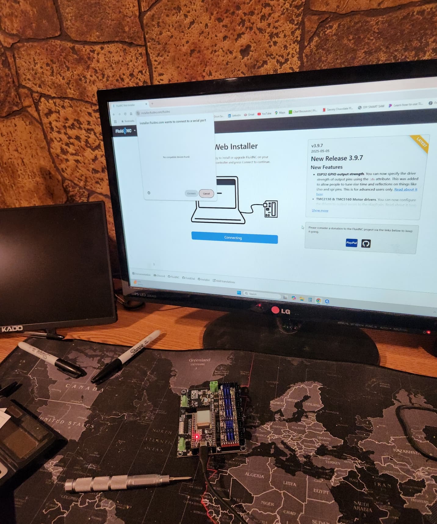

You can use the web installer to connect with a usb cable. Then you can check your Fluidnc configuration and update or change the wifi settings from there.
https://installer.fluidnc.com/
if the esp 32 is connected to the jackpot controller my computer doesn’t recogize it. Also if the esp32 is connected to the jackpot controller at all i cant connect to it wirelessly either if it isn’t connected i can. Any clue whats going on
What do you mean by this? If the ESP-32 is plugged into the socket on the Jackpot, your computer doesn’t see it when you plug in the USB cable?

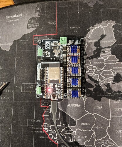

If that, can you post a picture of the ESP-32 on the jackpot, with the cable plugged into the jackpot and computer, but with the Jackpot VMOT power off?

Right if the esp is physically plugged into the jackpot controll board my computer cant find the signal not through connecting with usb or wifi or ap mode but if its unpluged from the controller it is found and connects just fine both connections usb, ap, or wifi they all act the same

Some more things to check (I can’t tell from that picture)
Be certain that the heat sinks on the TMC2209s aren’t touching any of the header pins, this can cause a short that will disrupt operation of the system.
