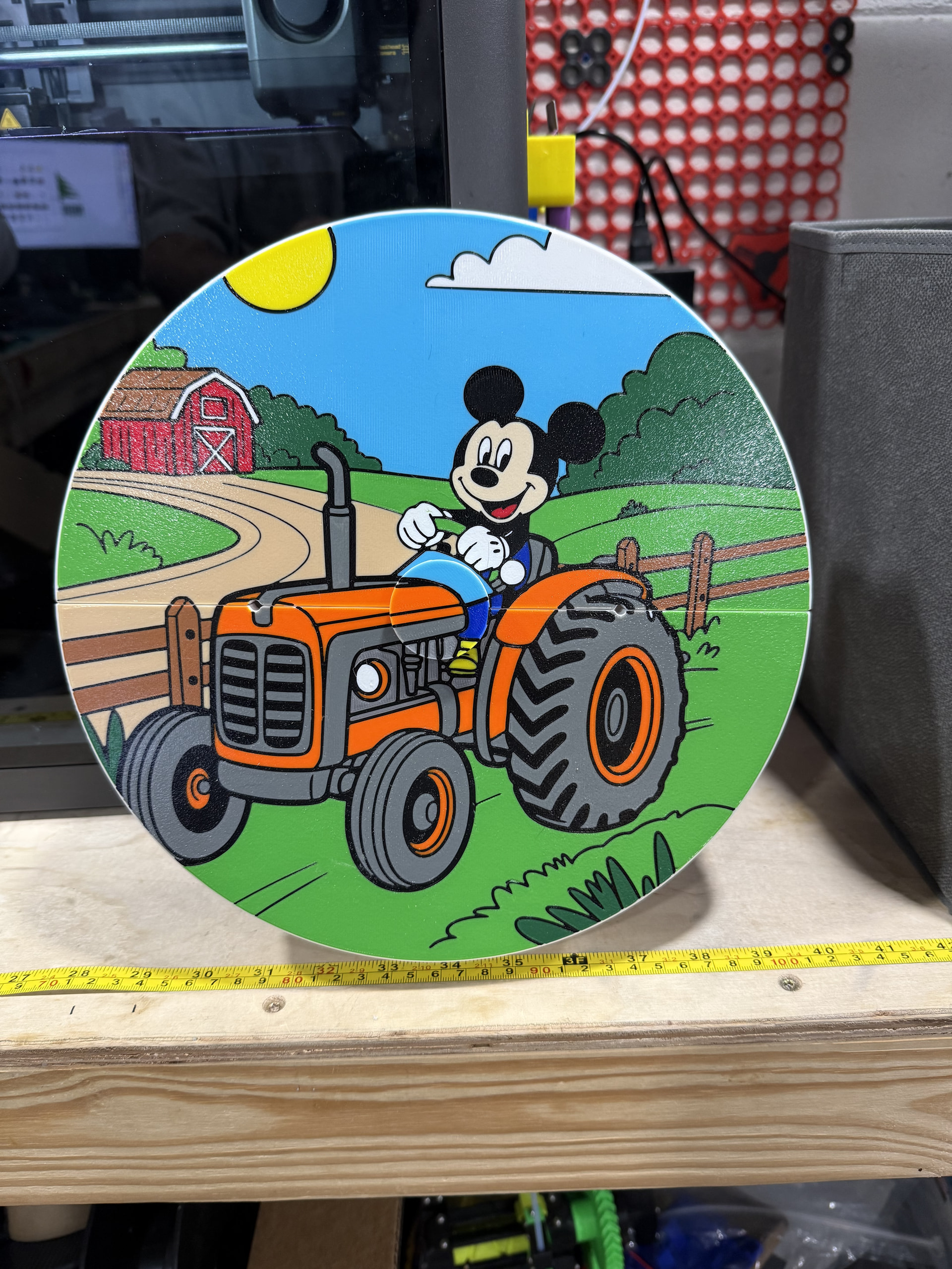

Curious about the wheels, was seriously irritated how bumpy the ride was for my aunt’s stock wheelchair. Felt like compliant TPU tread-rim sections, and CNC’d hubs could help balance fabrication time and improve ride comfort. fwiw have some sinusoidal shark wheel inspired openscad based wheel generators somewhere, the sinusoidal wheels use less material (Faster print …) than typical wheel, and help deflect small debris, skaters seem to like them for smoother ride.

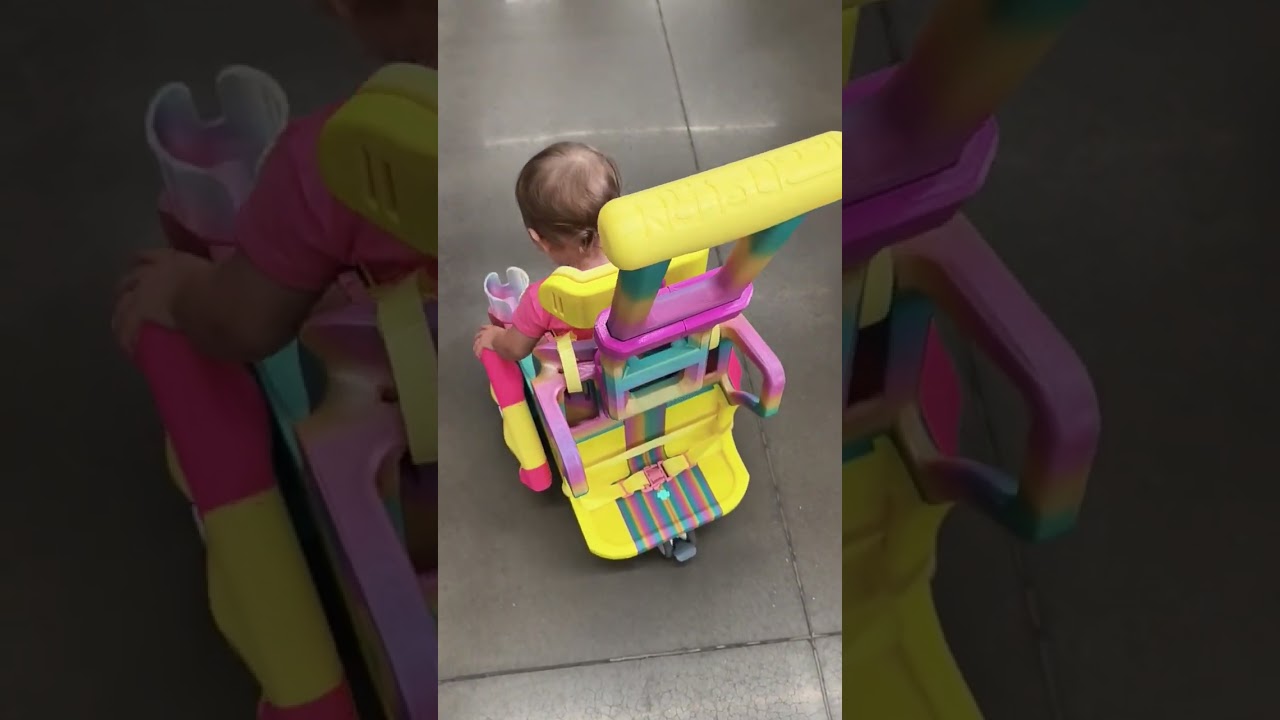

The one I delivered yesterday and before we could get home the family sent me a video of the little girl pushing herself through walmart lol. No complaints of a bumpy ride. How you print the tires can effect it though. Too soft and they will bump at the transitions between the pieces. But for the most part it’s pretty good.

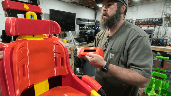

Also I will throw this out there. This beta is not to reinvent the wheel (no pun intended). This really needs to be a follow the directions build. The system MakeGood has set up offers liability insurance coverage to every vetted maker in the world (where laws allow) and because of that we do require things vital to the chairs function to stay “stock”. What we are proving with this beta is that the files can be taken by users other than just Myself and Ryan, cut on their machines and assembled correctly with the prescribed parts. All of that being said, throwing out options and all is awesome and will for sure be taken back to the team to be looked at and vetted.

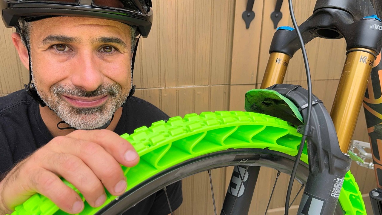

Maybe the project should reach out to this guy and get a version of his MTB tire made for it…

once the base works, the next goal is a cnc tpu wheel. so maybe more specifically right now the focus is going to be on the chair, cushions, and chest harness system.
currently it is using the current printed wheel and tpu tread. but if the chair works out, next up is the wheel. I am sure we all already have ideas for that.
I for sure like the idea of the CNC wheel, But do hope we can keep it to still work with the 3d printed wheel as well. The customization on them is 1/2 the fun!!! and that’s the only thing left to do haha.

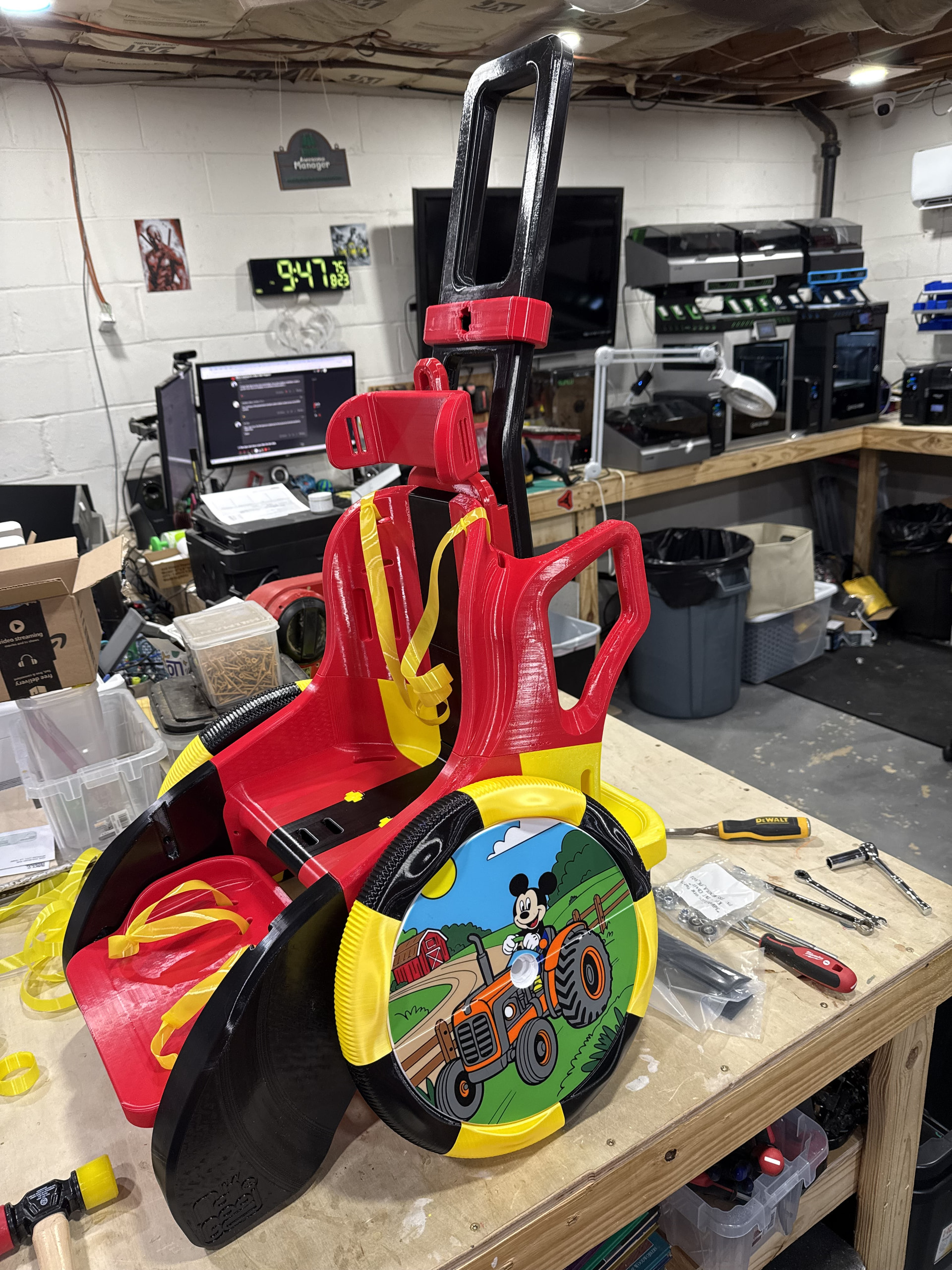

Latest one we are putting together tonight… #27
