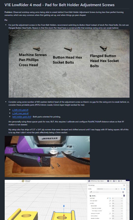

Shared some observations and .stl for small LR4 mod I use to reduce how often my switch swing arms bind, bend and/or pop-off into the garage ether… v1engineering-mods/lowrider4/mods/belt-holder-pad at main · aaronse/v1engineering-mods · GitHub
This is working for me, but curious to learn about alternative/better approaches?

I saw it catching on mine in unpowered testing and figured this is a problem waiting to happen. So I wrapped my screws with cable ties, now the limit switch no longer catch.
That is a slick idea as well.
