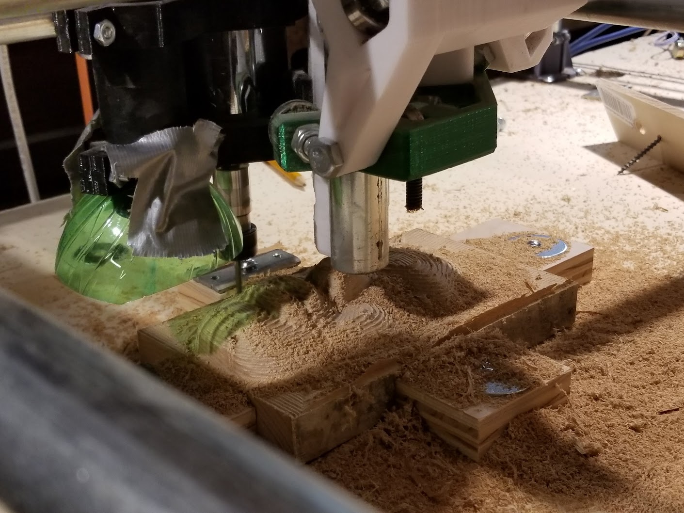

I have a 500watt spindle that I’m still waffling on swapping back to the dewalt 660. The spindle is really just an electric motor with a collet holder bolted on. Because of the collet holder, it has a really long shank. This acts like a lever, even with the spindle mounted as high as I can get it, I still have issues. I do like the quietness of the spindle though.

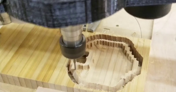

I read somewhere that a 500 Watt spindle wouldn’t have enough power to cut hardwood, any truth to that?
I highly doubt that. The 500W import will most likely not be 500 but even then, I can’t imagine wood giving it a hard time.

I have a 500w spindle and noticed the ‘hang down’ issue. I found that the spindle has 4 mounting holes in the base. I have made a 1/2 inch mdf spacer to glue to my base plate and screw the spindle to the base plate. Only the collet and enough of the flat section of the shaft for a wrench are below the base plate. I am hoping this will work. I will let you know.

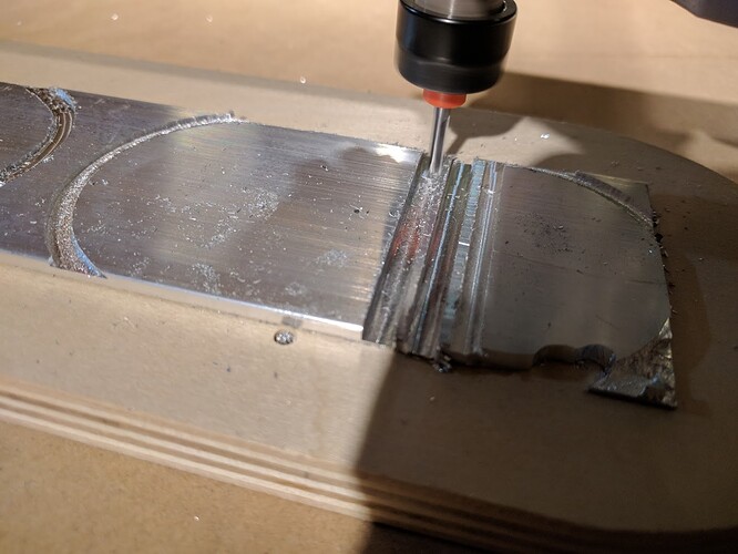

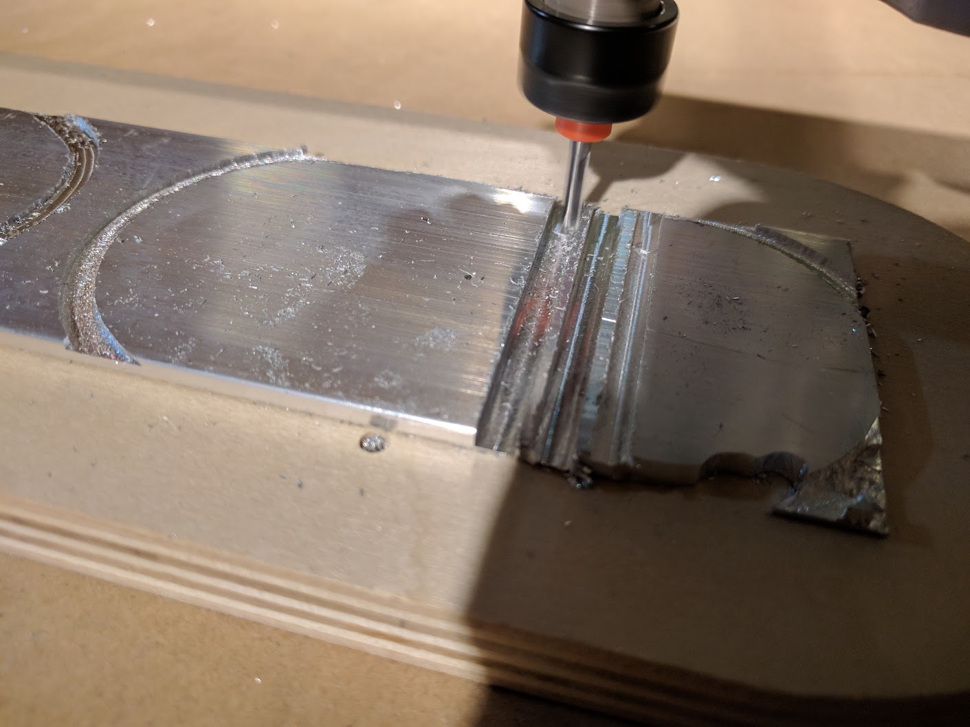

This is a 500w spindle milling aluminum. Hardwood won’t be an issue.

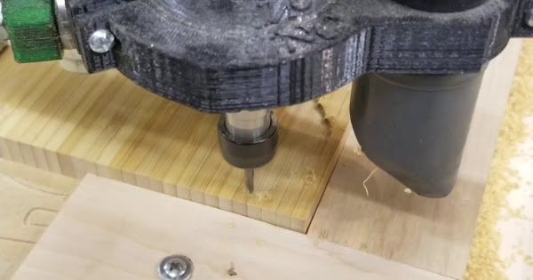

Oh, this is bamboo, which is harder than a lot of hardwoods.
I’m still running with the spindle! Decided it wasn’t that big a deal after hitting the bottom of the Z tubes on a 3d profile.
