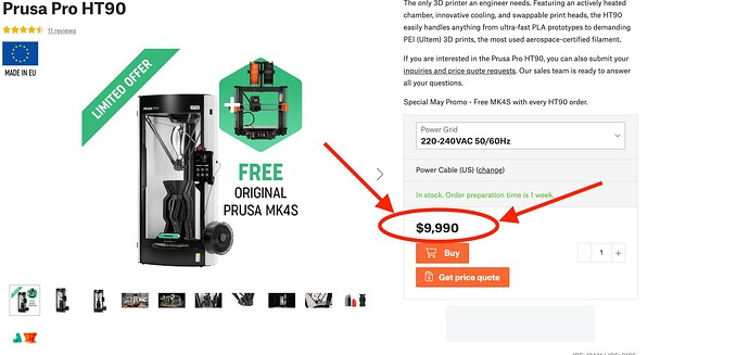

The Prusa Pro HT90 comes with a free MK4S right now. :laughing:
At that price it better come with a free space shuttle!

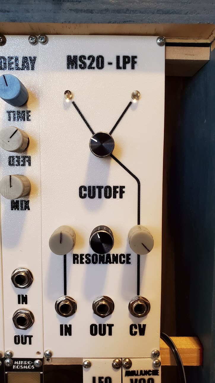

With the textured print bed and multi-color I really like making control panels and such:

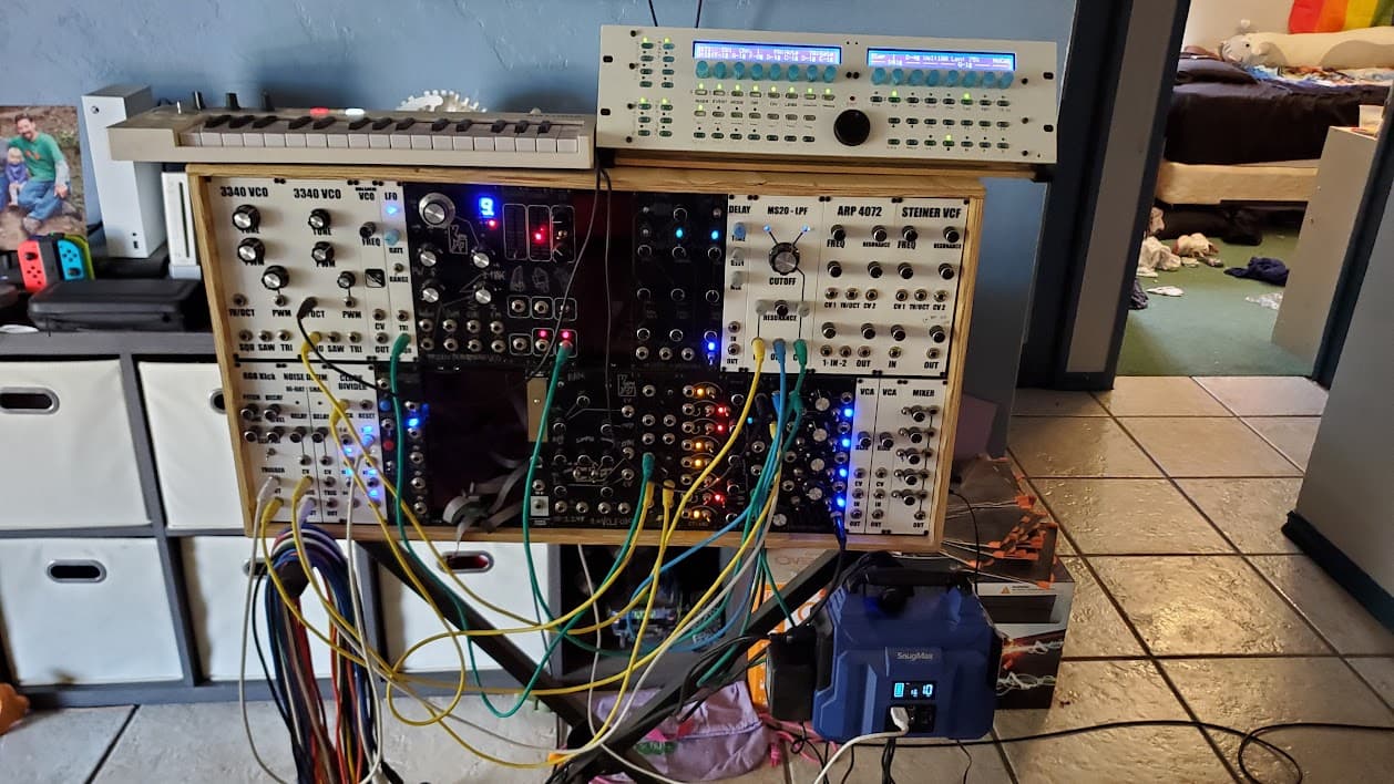

All the white panels on my Modular Synth were 3D printed with MMU labels:

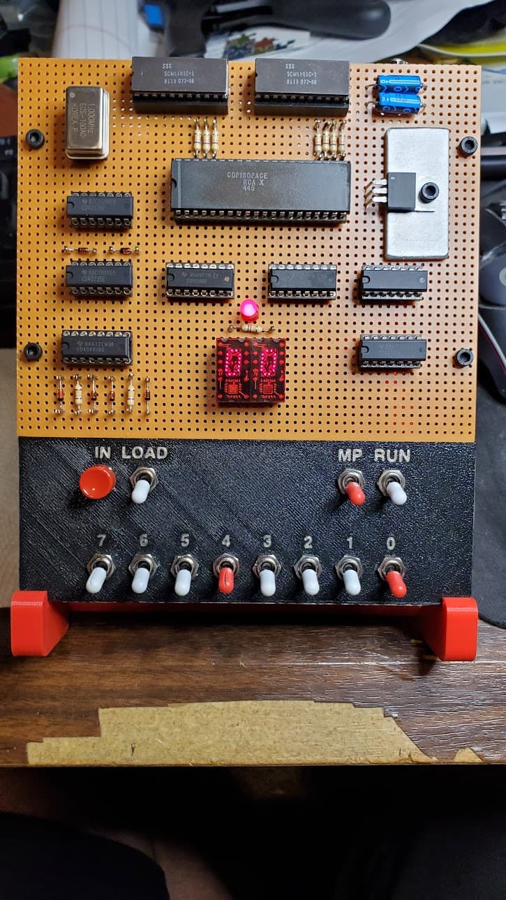

The biggest limit is you can’t really get very detailed - the labels on this Cosmac ELF are pushing the limits for how small this works without going to a smaller nozzle:

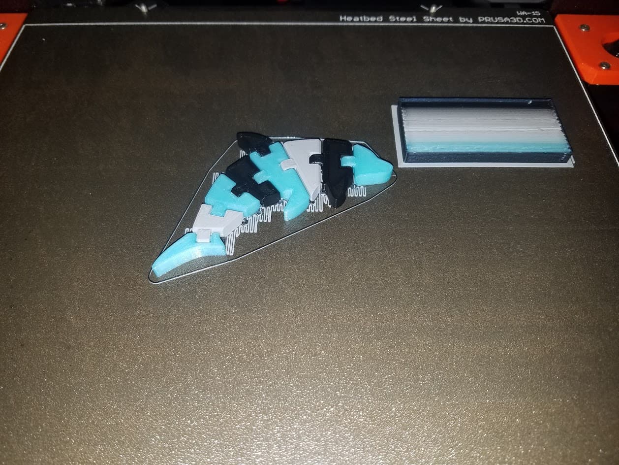

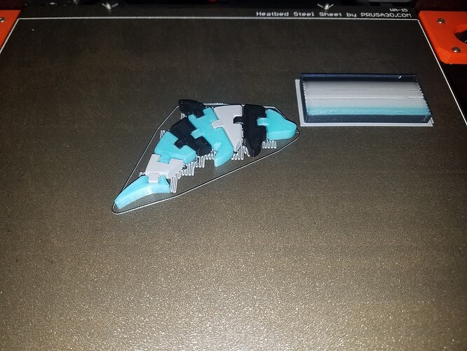

The purges suck. On the few real multifilament prints I’ve done the wipe tower weighed as much or more than the finished print. I just can’t bring myself to waste that much plastic.
This was my first successful multi-material print…the print was 7g - the wipe tower was 9g:
And - with purges you can’t do true multi-material like that Bellows - because the same thing that makes that work - makes the wipe tower fail.

That was the problem…with white on black a single layer doesn’t work - the white is too translucent. So you have to do at least 2-3 layers for the labels to come out decently. Black on white is better - but it still works best if you do 2-3 layers. And I can’t be bothered to swap filament manually that many times.

Ah, I just emboss the text, so it can be as many layers as I like after the single change. Your design is cleaner, but yeah, probably not nice with manual changes.

Three layers is exactly right and involves only two colour changes, start with the white lettering and the first is only a few minutes from the start, the next will depend on how much your other colour first layer is, but then two layers of lettering only takes a few minutes and you can leave the print alone for the rest of the time it takes.
