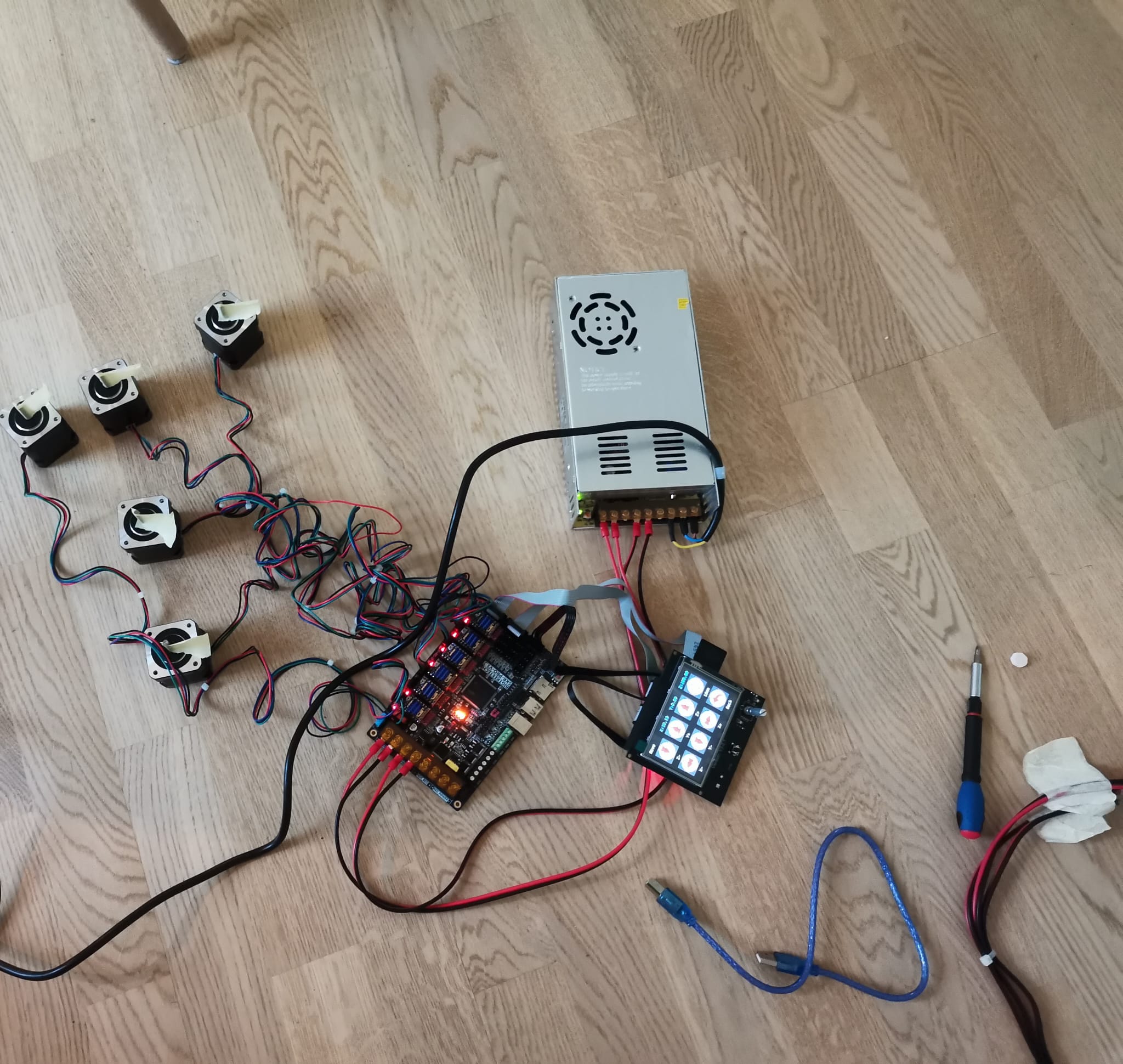

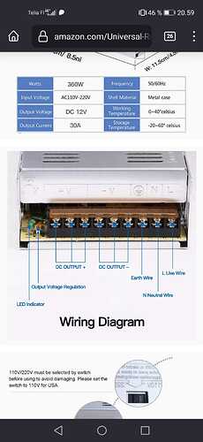

If you have 30A avaulable, you’ll be fine. So you need PC9 to the laser PWM, +12V and ground from your supply.
electronics is defently not on my field. So here is pics how did I wire these
On the Extension 1 header, ground and PC9 are right next to each other in the corner (top right if the USB header is pointing down, IIRC.) A 2 pin Dupont connector there. That should go to the PWM and ground connection on the laser. These can be thinner wire (24-26 AWG ok) since they dont carry much power. Sonce you are running the laser from the same supply as ground, it would be a better idea to leave the ground connection off. Installing it here makes for a possible ground loop, which can pick up all kinds of EMI problems. This ground is only necessary if your power for the board is separate from the laser power, so a single Dupont pin on PC9 is better in this situation. Double if you use a separate power supply.
From your power supply, I would connect to an unused pair of power and ground and run 2 wires there to +12V and ground at the laser. Here I would want to use at least 20 AWG wire, and I would probably use 18 AWG wire. Thus is a bit harder to get to a JST XH connector, but worthwhile. NEJE lasers have that connection board which has spade terminals, which is nice.
If your laser only has 3 wire connectors, run power and ground from your power supply, and the PWM to pin PC9. In this case with a separate power supply, I would double the ground back to the pin next to PC9.
Some of this doesn’t apply to you specifically, but I include for others who may read this.
