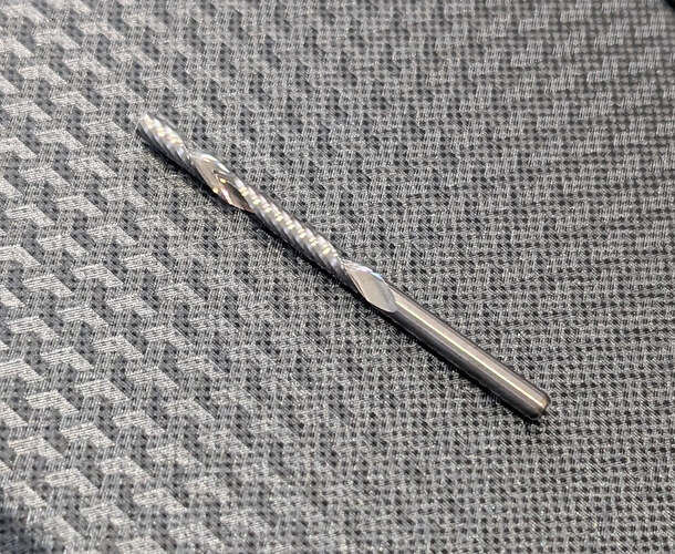

Which endmill for 100x 20mm holes in 1" thick stock?

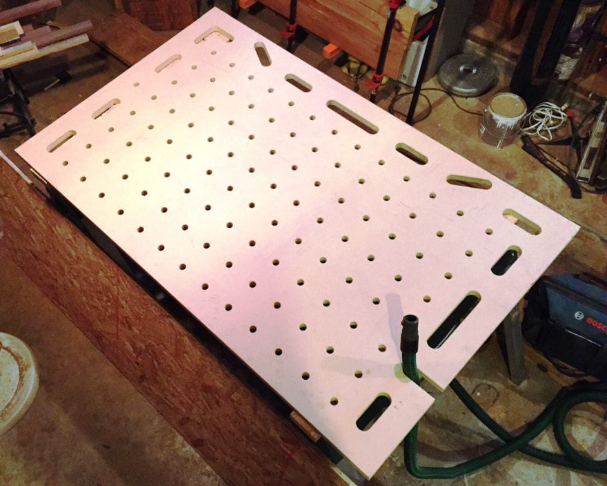

I’m building my first LowRider! As a home workshop outfitter, I’d love to use it to make work bench tops similar to the MFSlab (but custom)
This will involve a lot of holes and some slots & cutouts…typically in 3/4” to 1” Baltic Birch or MDF.
What do I need to know about endmills or an overall strategy for making something like this? I have the Makita router.
I used this to cut out a chair from 3/4” maple plywood. It worked great.
great, I have 10 of those in my cart. With the # of holes and amount to remove, is there any reason to go for a 1/4” bit? (or stay away from it?)
I didn’t try a 1/4” on the plywood. It might be worth a try. The 1/8” worked well since all the cuts I did were profile cuts. I didn’t do any pockets.
