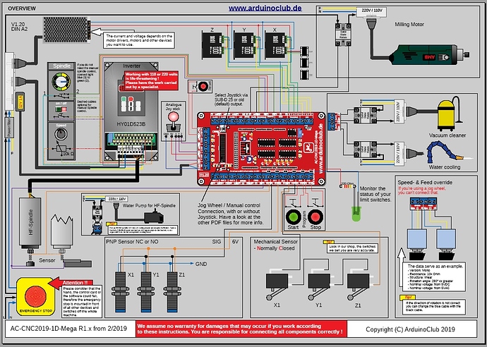

I would disagree with earlier posters and would like to redress the balance of opinions expressed here thus far. GRBL is not the ā€˜second best’ option as has been expressed so far , GRBL is, in many ways, much better suited to milling operations than Marlin. Marlin is primarily a 3D Printer firmware, written and developed to deal with the peculiarities that 3D printing throws up, whereas GRBL was designed and developed specifically for milling machining in its’ various forms. The display you are presented with from Marlin is heavily biased towards 3D printing with icons for heating, extrusion levels, fan control, bed levelling and LED lighting, all of which is totally useless to milling. what you need are options for different workspaces, a single probe, spindle speed, adjustability of cutting speeds, coolant flows, tool changing and emergency stops! Historically control over the mill has been achieved by a computer attached to the mill, using the screen of the computer as the display and there are many software offerings that offer the correct mix of controls - GRBL controller, Universal Gcode Sender, OpenCNCPilot, Estlcam to name but a few, most have an option for either a pendant (a remote device for controlling the software - like a mobile or tablet) or will support the use of a game joystick pad.
As you have decided to go down the Arduino road I would urge you to look at GRBL instead of Marlin. EstlCam is popular, if you are looking for something to build take a look at https://www.arduinoclub.de, the site has an English version, and is much more geared towards machining rather than printing.

From the diagram it implies that joystick control is implemented.
Spindle speed control?
Program run / program stop capable of resuming after stopping?
Feed and speed override responds quickly instead of Marlin’s which applies only after 16 movements?
Multi-axis? Marlin has to abuse E and has no concept of A or B.
Probing corners or circles?
The CNC shield I’m using runs on grbl and supports a hardware ā€œcycle pauseā€ button that appears to be instantaneous.
