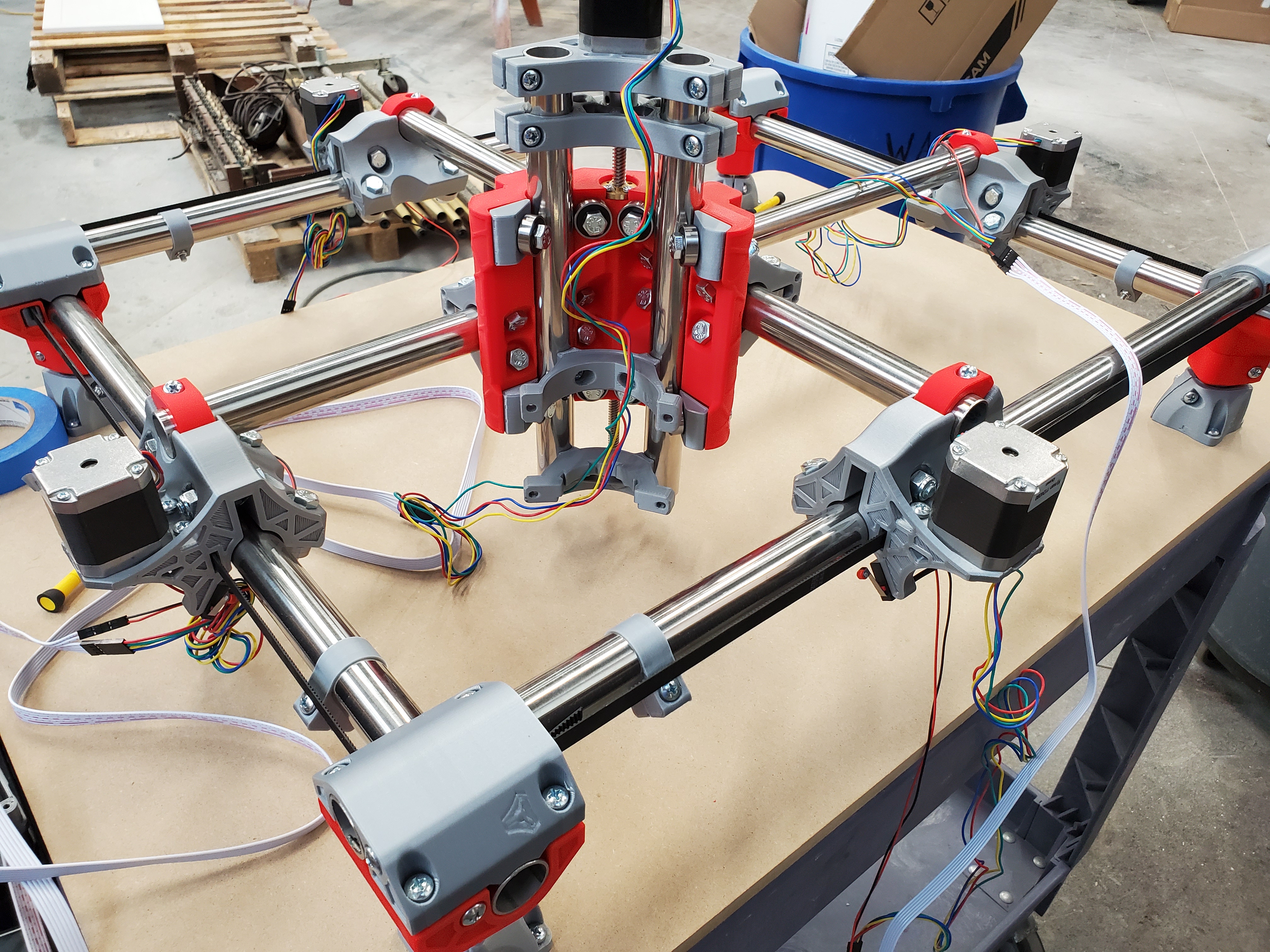

I feel like I have searched everywhere and can’t seem to find where and how, without designing brand new parts, I should be attaching the limit switches to my MPCNC Primo build. Pictures and/or links to better stop blocks outfitted with ways to connect limit switches to it would be greatly appreciated

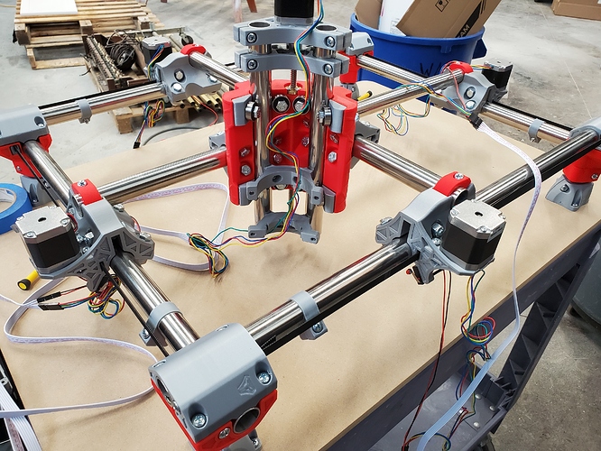

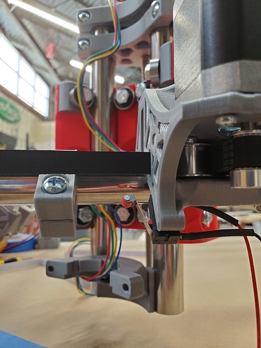

There are specific holes on the x and y trucks that the limit switches connect to. I believe you use m 2.5 screws. If you go back through the Primo build instructions you will find a reference to installing endstops if you have them. I believe it is in the truck assembly section.
You can see in my second picture the four plastic endstop pipe clamps. That should give you some direction where the corresponding end stops go.
Totally Overlooked that step. Thanks so much! Epic Pics, amazing lighting. Your machine looks AMAZING!
