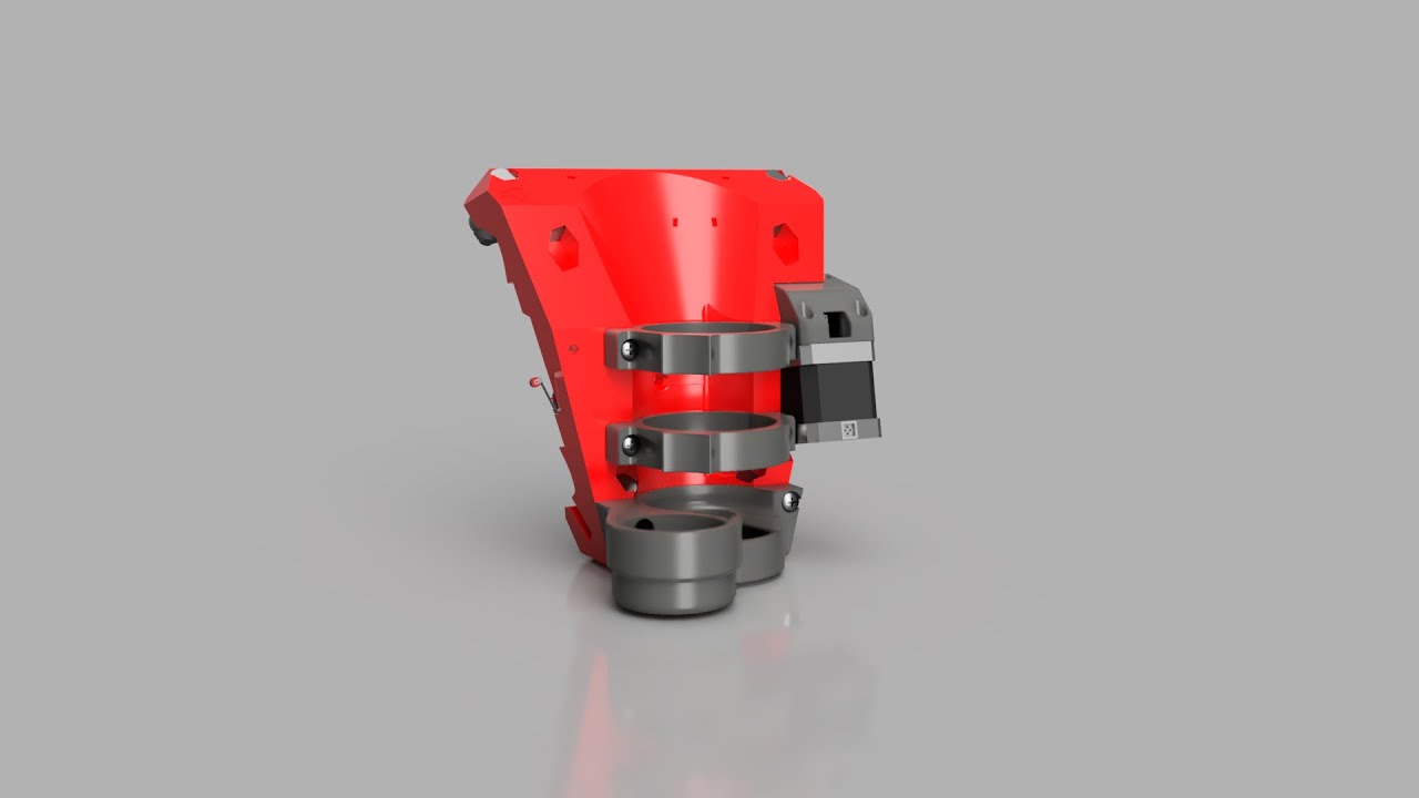

Thought of another couple things that would be nice in a LR3.
  1. a bit of an edge around the center x plate for mounting dust shoe/skirt.
  2. being able to take it off the table without taking off the y belt mounts that go into the table.
that last one might just be me with how i did it though.
Umm, well both of those are covered, but not exactly how you are asking for.
Want a peek?
There is a loaded question! :rofl: :joy: :rofl: :joy:
Oh come on now!!!
Since this might be the only animation I do for the instructions…

I’m in love. Following eagerly.
I just saw the Patreon sneak peak… Looking good.
Can’t wait! Are we nearly there yet, are we nearly there yet?
