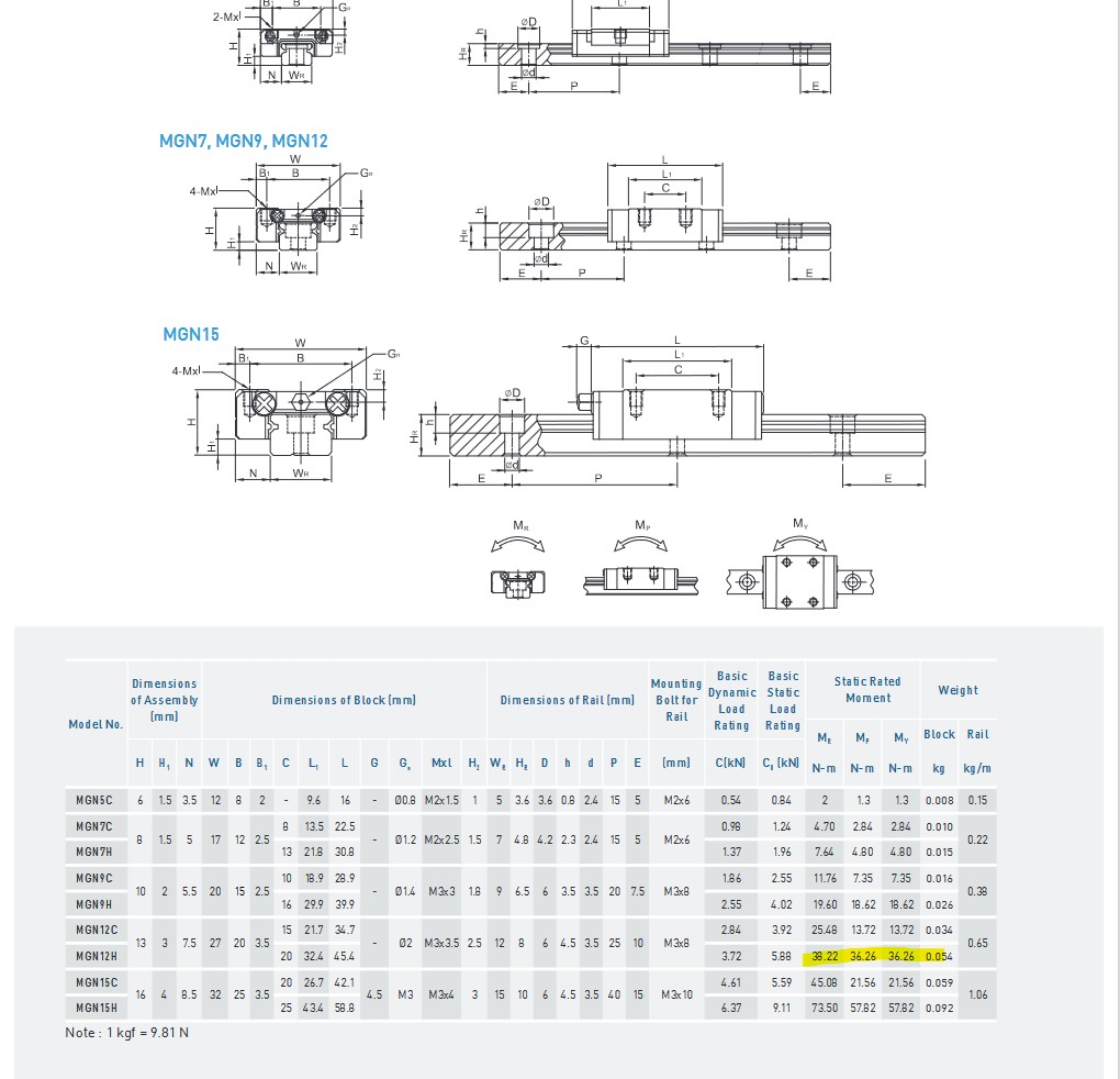

The rated moment of a 12H is 36N-M (26ft/lbs) ummmmm I guess 4 per side was overkill. Lets cut that down to two per side. Even a knock off should be plenty capable as a pair to handle the full weight of the LR under full cutting loads. That cuts $50-$60 off the BOM right off the top. Niiiice…
Anyone see anything wrong with that??? Think in terms of just swapping the current LR Z rails. (it is not that but if that would work so will this)

What do you figure the moment is during a sensible cut?
Rather, during a reasonable maximum cut load on a reasonably large sized table… reasonably speaking
Do you need to install every screw to reach those limits :slight_smile:
I always have like 9lbs max load stuck in my head, I am not sure where that came from but I know that is very high from an average cut. That 9lbs is extremely close to the blocks. As 2 inches delta Z almost directly in line with the front block. The entire mass is centered betwean them pretty evenly (as far as I can tell in CAD). So we have the mass and the load.
You know I will have to include all the screws or I we will never hear the end of it.
Dang this changes everything is such a good way. So much more room.
Yeah. 2 rails per side should be more than enough.
Two bearing blocks per side. instead of two per rail.
The only issue I see is now there is a large pivot point on the parts. I will stagger the blocks to try and help that a bit.
Oh. My missunderstanding… I was trying to figure out why you’d think you’d need 4 rails on each side :slight_smile:
Not sure about only two blocks on each side, though. I think even if you offset them from each other, you’d still have a single plane of rotation, it’d just be at an angle instead of straight across.
