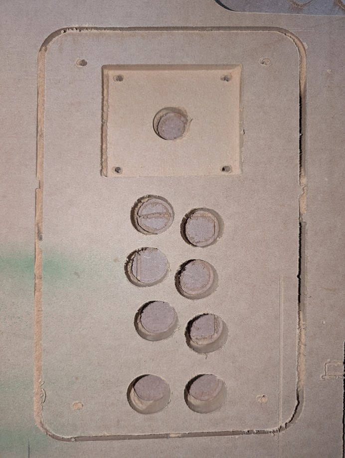

What would cause these cuts to not be round?
Well, after tightening, it looks much better!
Not sure why the outline didn’t cut all the way through though. In some spots it was the whole 22mm, in others, it only went down 4-5mm.. It was quite odd.

Also, to be clear, the cutting depth was 22mm, and those cuts were maybe 4-6mm, so it wasn’t just a case of it not going through.

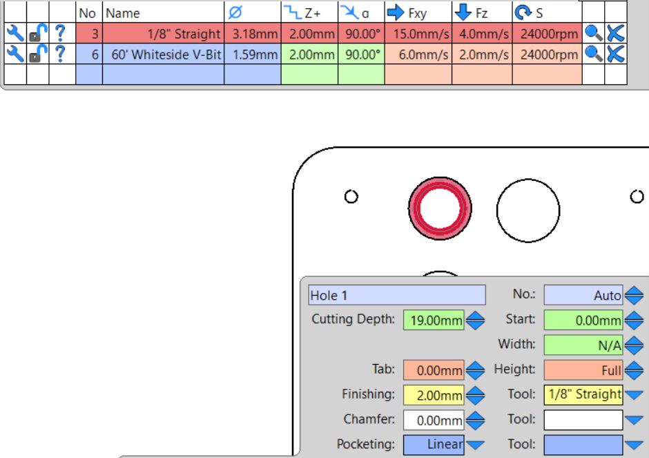

Have I done this right for a finishing cut?
I measured my MDF and it was 19.5-19.6mm thick. I noticed that my holes are the right size on the “top” side where the cutting started, but on the bottom side, they are wobbly (i.e. my arcade buttons won’t fit all the way through).

Reading your gcode file:
Holes: 1-3-5-7-9-11-13-15 pocket#17 are set to a 2mm max Depth Of Cut
Not even 6mm. I would suggest you take the time to resolve all mechanical issues: core wobble, re-square and do z axis level and surface your spoilboard and make some tests from there.
You’ll want your cutting depth to be 1-2mm more than the thickness of your material to make sure you’re cutting all the way through. So if you measured your MDF as 19.5mm thick, set your cutting depth to something like 21mm. You’ll also want to make sure your endmill has a flute length that is at least this long if you are also using the same tool for a finishing pass.
I see you have your finishing pass at 2.00mm- that is not referring to depth, it is referring to how much material to remove laterally during the finishing pass and normally you’d want this to be around 10% of your tool diameter. So if you’re using a 3.18mm endmill you would set this to something like 0.3mm. In addition to setting the finishing allowance in terms of bit diameter, you can also edit the finishing depth in the edit tool menu (normally it defaults to whatever you set as the depth per pass). I like to make one full depth finishing pass and to do that you’d go into the edit tool window and change the finishing pass to the same as your overall cutting depth (so 21mm in this example).

That’s weird. When I was clicking on my Estlcam, I noticed there were 2 holes for every hole, which was odd. One was set to 22mm and one was set to 2mm.

the estlcam ui is a bit tricky to use. it is very easy to accidentally put several operation on top of each other. click on each hole in estclam. if it shows a popup then you have more then one operations. just use the preview to inspect the gcode to make sure that it is going to do what you want. verify that number of holes that is going to cut matches the number of holes you want to cut. or just use an external tool like CutViewer to double check the gcode.

you have another problem. you are trying to cut a big helical hole with a small endmill
the endmill wont cut everything inside the hole and will leave a stub in the middle that can get stuck or fly away
you should really use pocket operation in that case to remove all the material

i do not think you can do tabs on a helical hole. I would just do a pocket operation and clear everything inside a hole. a little bit more cutting but more predictable. 20mm with 3mm endmill for slotting is quite deep. and if the tram is not great that could cause even more issues
I’m familiar with tabs, but I didn’t think you could do it with a circle (which someone else said you can’t, c’est la vie). But I’ll try pocketing them to see if that works better.
