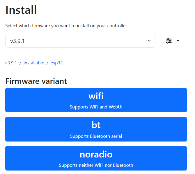

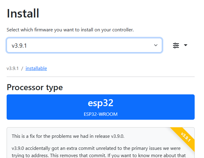

That is v3.8.0. I do suggest a full wipe, flash, and reload of the 3.9.1 and the V2 files.
actively attempting…Im in the fluidNC web Installer…How do I do a full wipe?
Note that before doing this, you should backup anything that is on Flash memory (like config.yaml).
When you select “Install FluidNC”, select v3.9.1 and click on “esp32” for the Processor type.
Select the “wifi” firmware variant:

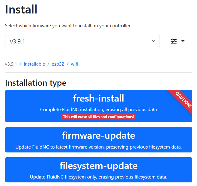

To do a full clean install, select the “fresh-install” option:
Lol, yes, :100:. I fluffed this up over the weekend, am backing up flash ‘files’ snapshot like config.yaml to GitHub now before I update firmware version, and/or incase the ESP32 dies…
