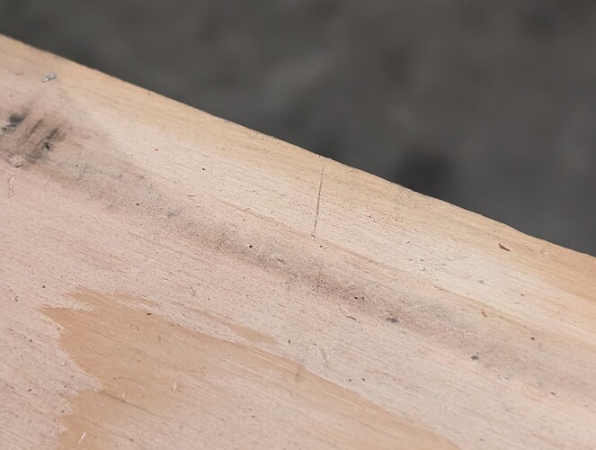

So my 3/4" plywood table is starting to develop some fairly serious ruts where the non-rail side Y bearings ride on the (soft) table surface. Picture doesn’t show it well, but they are already >1mm deep after only a few movements of the machine.
e2e78bcee13809acdf6cf4b75b81986d6ee69159_2_663x500
My plan has been to use a strip of some harder material on the table surface for the bearings to ride on instead of the softer plywood. The only question is what material to use.

My full sheet LR3 has been riding on MDF since I originally built it and its been good. There is a seam in the middle and it has never caused me any issues. If you have enough hard board to run down the bearing side and under the Y rail clips that sounds like a winner to me. That way you are lifting the same amount on both sides.

I wonder if the wood was finished with a varnish would that help? You must really be racking up the mileage!
I’m assuming it’s not really wearing but compressing so I’m not sure it would get much worse. I wonder if you can just patch it with wood putty or something and sand it smooth.
Yeah that sounds like it would help.
Wood putty tends to be fairly soft.
Autobody filler is hard and durable. I might run a router down the side to dig a groove to fill with it, (I bet most of us have a serviceable trim router, :rofl:) then work it smooth before it fully cures. Somewhere between 3 and 6mm deep (1/8"-1/4") is in a good range for bondo, and maybe 10-12mm wider than the bearing wheel to distribute load. A small can of body filler would be enough, and not too spendy.

Not really. Only a day or two of use, but the gantry is quite heavy (1" 0.120 stainless tubes x2, 1545mm long), and the plywood is fairly soft (can leave a deep mark with my fingernail)

Body filler is not going to hold up very well. Its also designed to be easily sanded and not structural.

I used hardboard for mine, and to keep it level I put it under both the rail clips and on the roller side. Since mine is ~10ft long and all the hadrboard panels I had around were 8’, nine has a seam as well. With a tiny bit of care (basically making sure both ends were square and clean) the seam is visible but you can barely feel it with a finger and the bearings don’t notice it at all.
