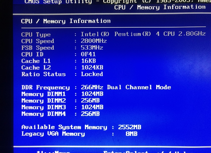

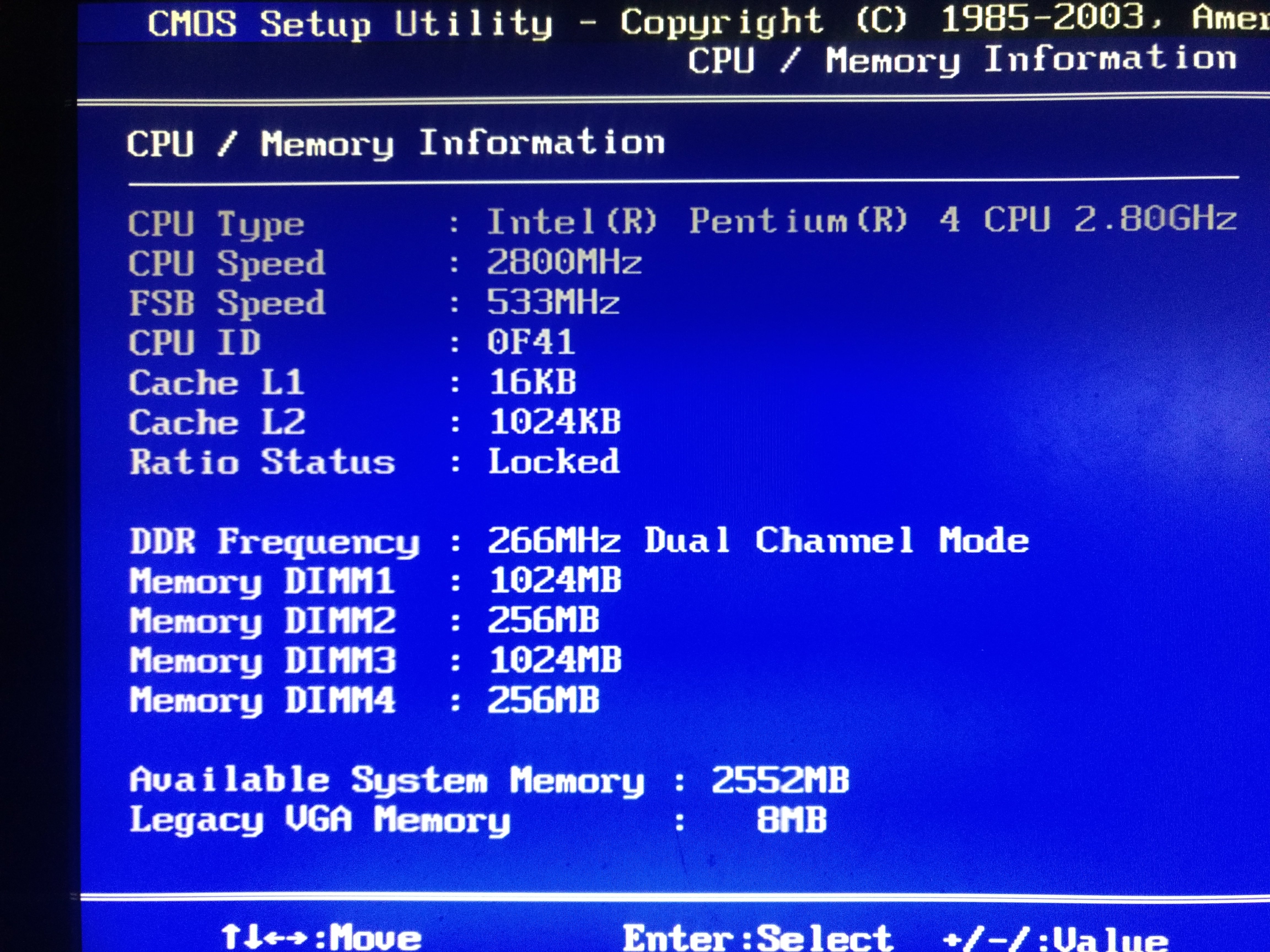

Otto, That is very generous of you but not necessary. I have a pi Zero running JeffB3’s image of Octoprint right now. I am more interested in learning linuxCNC or cnc.js . If I can use the old desktop to run the MPCNC it would free up the Rambo1.4 for something else( like a ZenXY or a MP3DP). I attached a picture of the memory installed from the BIOS screen.

That’s a wierd number for ram. That’s like 2.5gb(can’t visualize the sticks in my head) but it should be enough for processing gcode. Like Barry said you can’t directly control the machine out of the box with it, but you have some other fun options if you aren’t worried about power consumption.

Edit: looked a little higher in the picture and see the configuration right now. Sorry, I’ve been drinking
