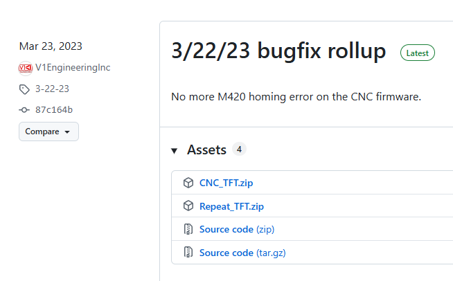

Thankyou both. Connectors are wired correctly but the TFT35 is boot looping. I’ve had a look at the documentation page but I’m not fully clear what needs to go on the SD card to be flashed to the TFT35. The latest entry is this:
I’m a bit confused as to why there’s two packages; do I need the contents of both CNC_TFT.zip and Repeat_TFT.zip, or only one?
No, the CNC_TFT is the one you want.
The other is if your are building a MP3DP Repeat 3D printer.
Aaah, daylight dawns inside my ageing mind. Thankyou very much!
