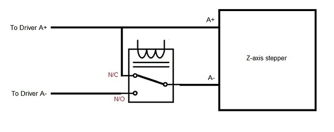

When you short out one of the sets of coils on a stepper motor, it becomes much more difficult to turn. So, I’m wondering would it be viable to set up a pair of relays which shorts out a set of windings on each Z-axis stepper when you power the machine down? If not, why? This is the sort of thing I’m thinking of. The coil of the relay would be powered whenever the machine has power thus connecting A- on the motor to A- on the driver and and when the machine powers down, gets disconnected from the driver and connects to A+. As drawn here, it’s in the powered down state.
Ryan has such stepper brakes in his store. I don’t know why nobody ever talks about them.
https://www.v1e.com/products/orobs-stepper-brakes
It could be that (maybe) it blows up stepper drivers during the switch. :thinking:
Okay, that looks quite similar to what I proposed. :+1:
It only switches when it powers down so I can’t image why would do any damage during the switchover
Those were designed for the MP3DP. On that you can have klipper unlock the brakes before the Z ever tries to move. I am not sure anyone has tried to make them work on FluidNC. The bed falling 300mm+ on a MP3DP that has a belt driven Z is MUCH more violent than the gantry going down when you unplug it. So much so that it has claimed the life of a few SKR Pro boards (2 of mine) so the brakes are very much needed there.
Under normal circumstances, the Z-axes on the lowrider would never drop when the control board has power so, don’t see the need to have the braking relay under software control, just power up the relay when you power up the control board.
Very true. BUT how far will it drop from the time it gets power to the time the stepper motors engage? OR is there enough time to remove the short from the motors BEFORE the drivers energize so they don’t error out?

The brake board works by shorting one or both of the 2 coils to itself. It doesnt blow up stepper drivers, but if you dont have it and you turn the motors really fast you can blow your control board. The 2209 drivers throw an error if the motor coils are shorted when it tries to power on. I powered them many many times with shorted coils when i was developing that brake board for the mp3dp. folks were frying boards when the bed would drop. I put brakes on my lr4 and it doesnt stop the drop. Just slows it down. I think a block is a better option.
