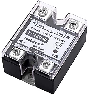

I know you didn’t want Amazon, but I picked up a Solid State Relay on there for 12USD or so. You can get them from other places as well. It takes 3-32VDC on the control side, and switches up to 480VAC @ 15Amps. Haven’t had a chance to get it installed yet as the CNC is currently buried from a shop cleanup. Got the idea from someone else on the forums who was using several of them to control various aspects of his tricked out MPCNC.
If you are looking to avoid Amazon, I found similar items available from DigiKey. They are standard parts, so locating them elsewhere shouldn’t be too difficult.
Also don’t forget to take into account that solid state relays generally fail closed. So when they fail, whatever is attached to it will stay on.

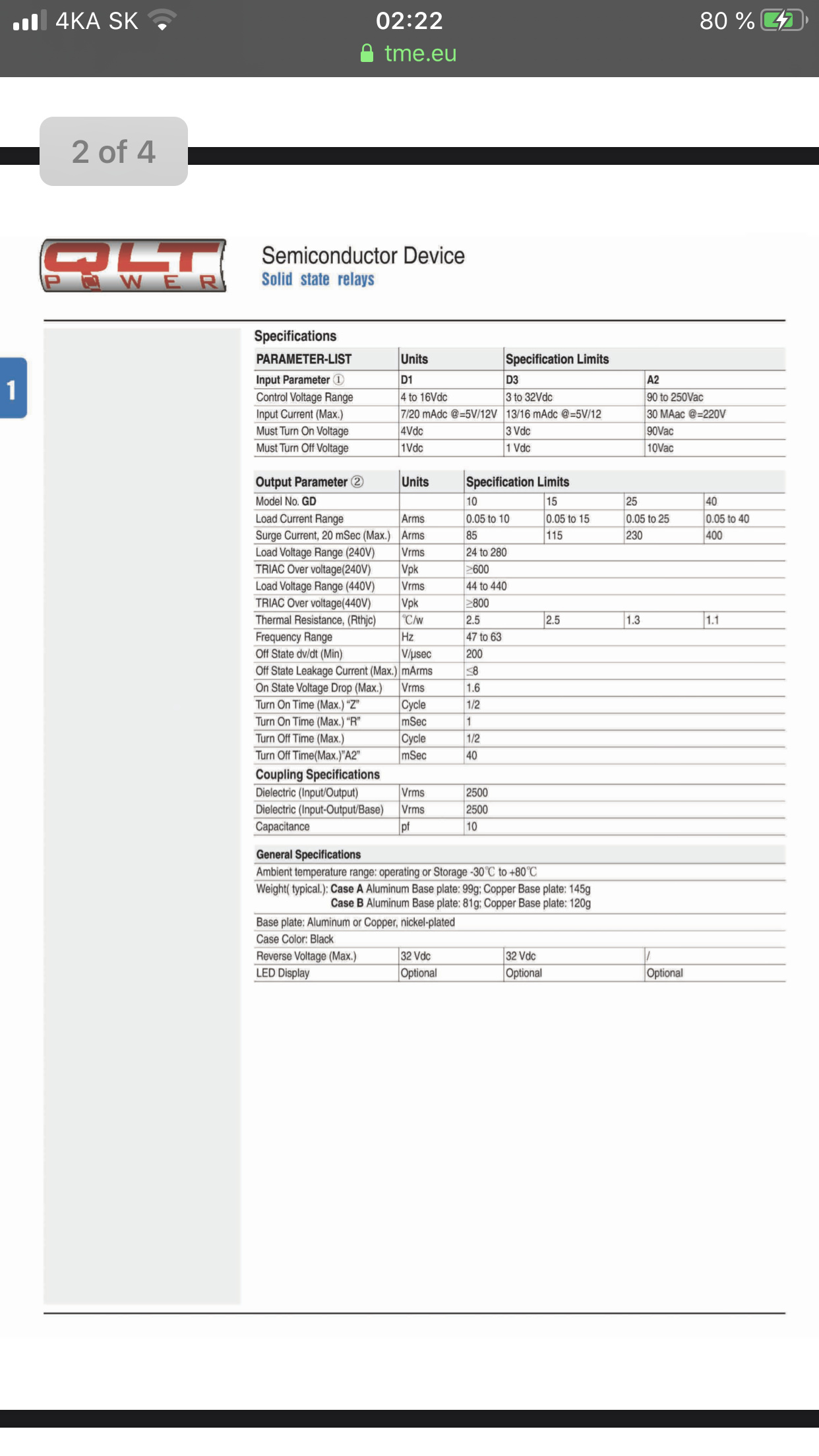

Hey thanks I found it in local electronics store here. Sorry for being total noob in this but where do I have to connect 32V ? Do I need some kind of voltage regulator/booster because my power supply is only 24V and 12V secondary
Edit: never mind I didn’t see 3-32V :sweat_smile: thanks

Don’t buy them on aliexpress. Make sure it really has a CE or UL approval.

Can I order this one ? One will be for my compressor and anotherone for spindle.
