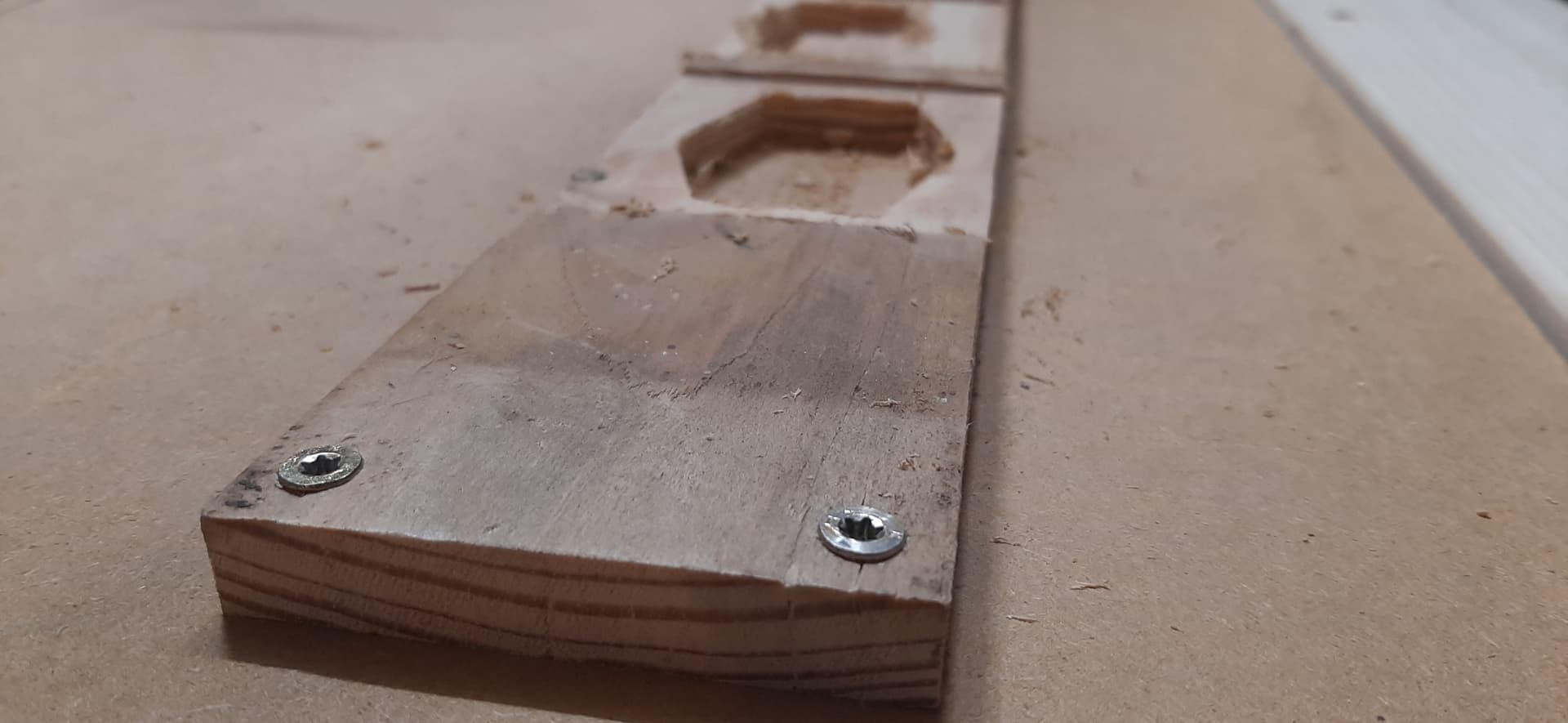

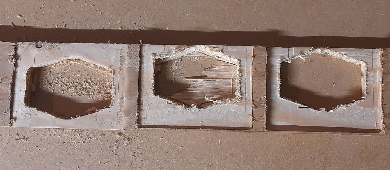

What problems can you recognise from this piece of wood?
Hi!
This morning I was trying to cut something small out of 10mm thick piece of wood, and results are not great. Can you tell me what can you see here?
I already noticed I didn’t do finishing passes on those cuts, so that’s probably why it looks so bad…

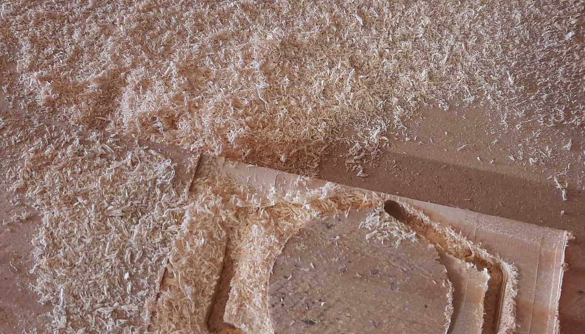

Chip size look ok to you? I can’t slow down more on makita… :frowning:
Why this flattening is no uneven in this marked place above? Is this normal in the roughing pass?

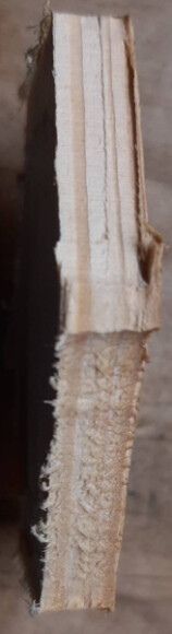

Maybe the camera angle,it appears to me that rhe bad cut is really a poor lamenation of the plywood. Your chips look great , you might geat a little less tearout of the plywood reducing the load. Is the bit sharp?
Funny! I though the same thing: this plywood looks weird! Oh wait! It’s wood! :smiley:
This is just soft wood, pine I think. Bit is new!
REALLY appriciate “your chips look great” comment, coz I desperately need proof of doing something right today! What a day…
I’m just prepared to go and have another go - last one today. Let’s see how this will look like with finishing passes and less DOC and feedrate.

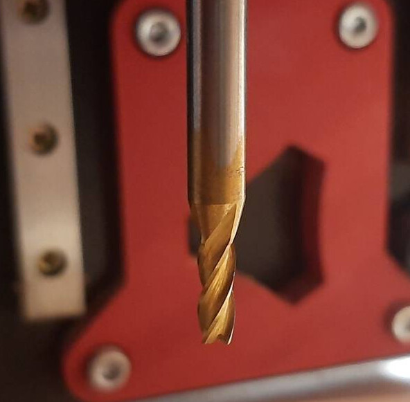

You should show a picture of your endmill or provide a link to the one you have, How many times have you used it?
Ply is a horrible test subject as the glue layers are incredibly inconsistent.
Goodness me, guys, I lost faith in myself! Maybe it IS plywood?! Gosh!

It looks, to me, like you’re a little out of tram… causing the (not!) plywood looking steps in the side of your cut, and the ridges in your surfacing.
I don’t think it is tram, that would be very consistent ridges. That surface being odd just seems like debris on the table under the wheels or something.

Photo of the bit:

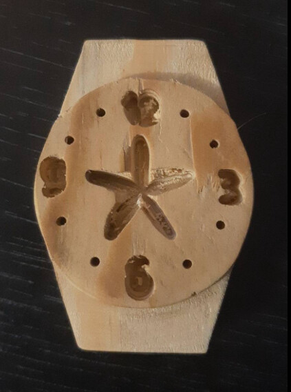

This time dust collection started without problems, feedrates much lower, placement of tabs changed and most importantly finishing passes added.
On the left most recent iteration (but also sanded a bit before cutting out, so not great comparison).
This last one try today was the first time I ever changed bit during job and first time I ever used bit other then endmill! It was 6.3 deg bull with 1mm end, but I went too deep for nice results. Also I have to do this first next time, and then cut out the part, because it was moving while cutting numbers.
Too many watch hands, I know!
That looks like a 3 or 4 flute bit. Ideally, you’d use a single flute.
The mill you have pictured looks tapered. How long are the flutes? If you are using that mill to cut into 10mm depth, it is always cutting full depth and widening the cut all the way down. If the flutes aren’t as long as your deepest cut, the chips won’t evacuate well.
How is that not plywood?
Yup for our routers you need less flutes not more. To use the one you have you need to have minimum rpm on the router and 4x the normal feedrate we use.
You will be much happier with a single flute endmill.
I never thought I will start wondering if I know what plywood looks like and am I able to recognise it from wood!

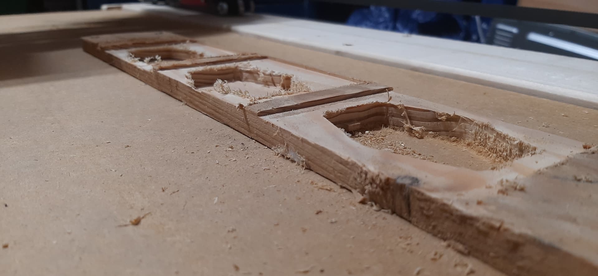

Here is more photos of the thing.

Plywood vs Wood
FIGHT!
How are you holding down the work? How thin is the work where the flattening happens?
I have had similar flaws with material held down at the edges with an upcut mill. That mill looks pretty aggressively upcut, too. For me, I traced the problem to the upcut mill pulling the material up from the spoilboard at.certain.places. in wood, this sometimes is because of a variation in density getting a “better grip” on the material. This is less prevalent in something like MDF, but that has issues too as it gets pretty flexible when it is relatively thin.
Some things that have mitigated the problem for me have been more hold-down locations, closer to the cut, and the use of woodworking tape for large surface areas where the middle wants to come up, and a screw isn’t an option. Straight flute router bits or downcut bits also deliver good results for smooth bottom cuts.
Dan, thank you for this. This is one of my problems for sure. Check out photos in other posts! I have, indeed, installed material just on 4 corners, even though it’s around 40cm long.

I have found 1f downcut bit and it is indeed much better now. I didn’t have time to run whole project again and I’m going away for a week , so for now… Thank you all it has been very helpful.
Ideally a single flute upcut bit with a large enough cleanup pass will be much faster and not tearout the surface.
Downcut bits are very slow.
