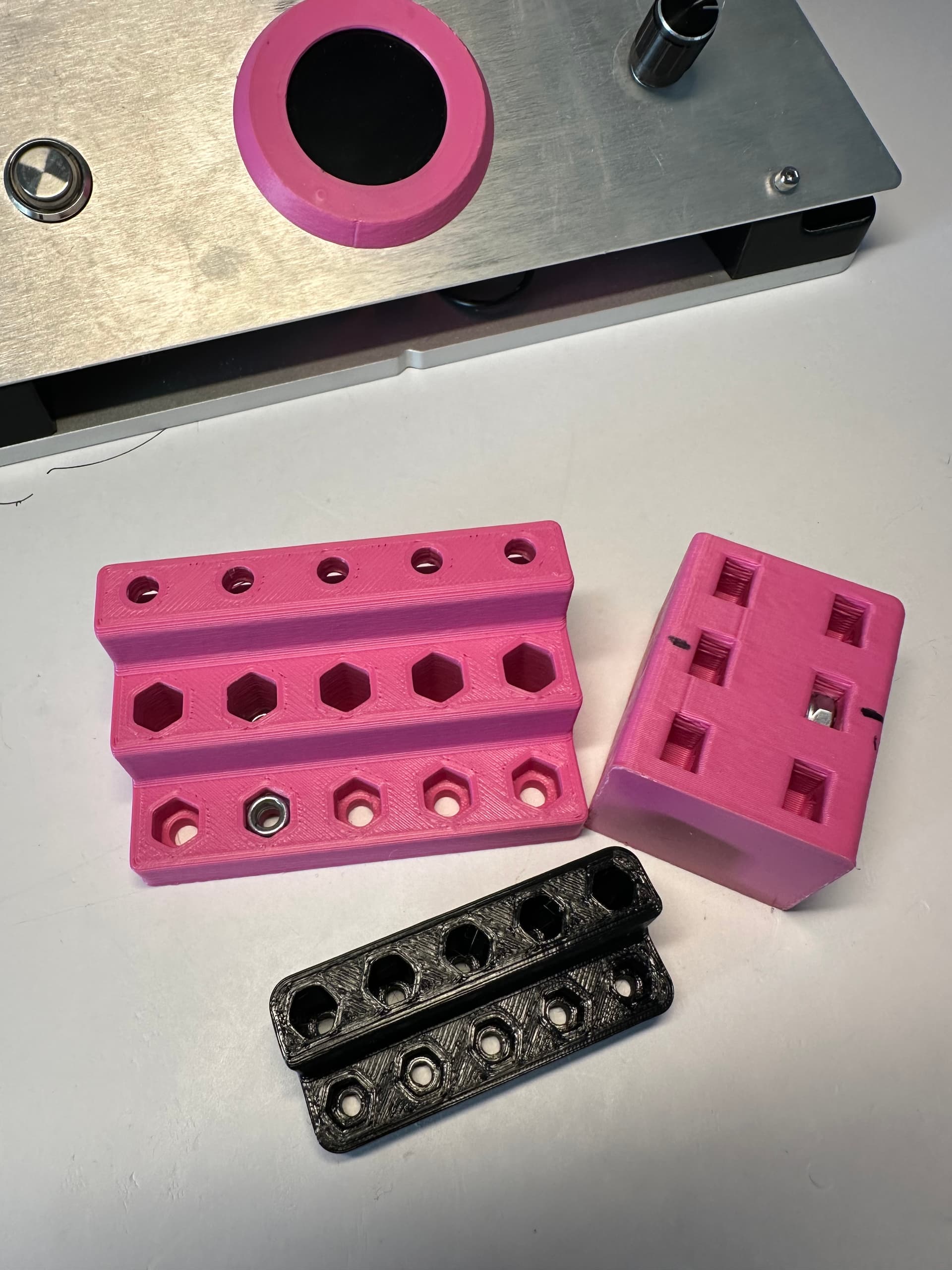

Long story short, if you have already printed those files, you don’t need to re-print them. The only thing that changed for those files (except for the zKnob) was improving the nut pocket sizing (for the M3 and M5 locknuts). Some people were having issues with the pockets stripping or being too tight to insert hardware easily. I printed these tests test parts to hone in on the optimal dims:
If you’re careful and have some patience seating the locknuts, the old files will work just fine. But obviously if you haven’t printed them yet, go with the new ones :slight_smile:

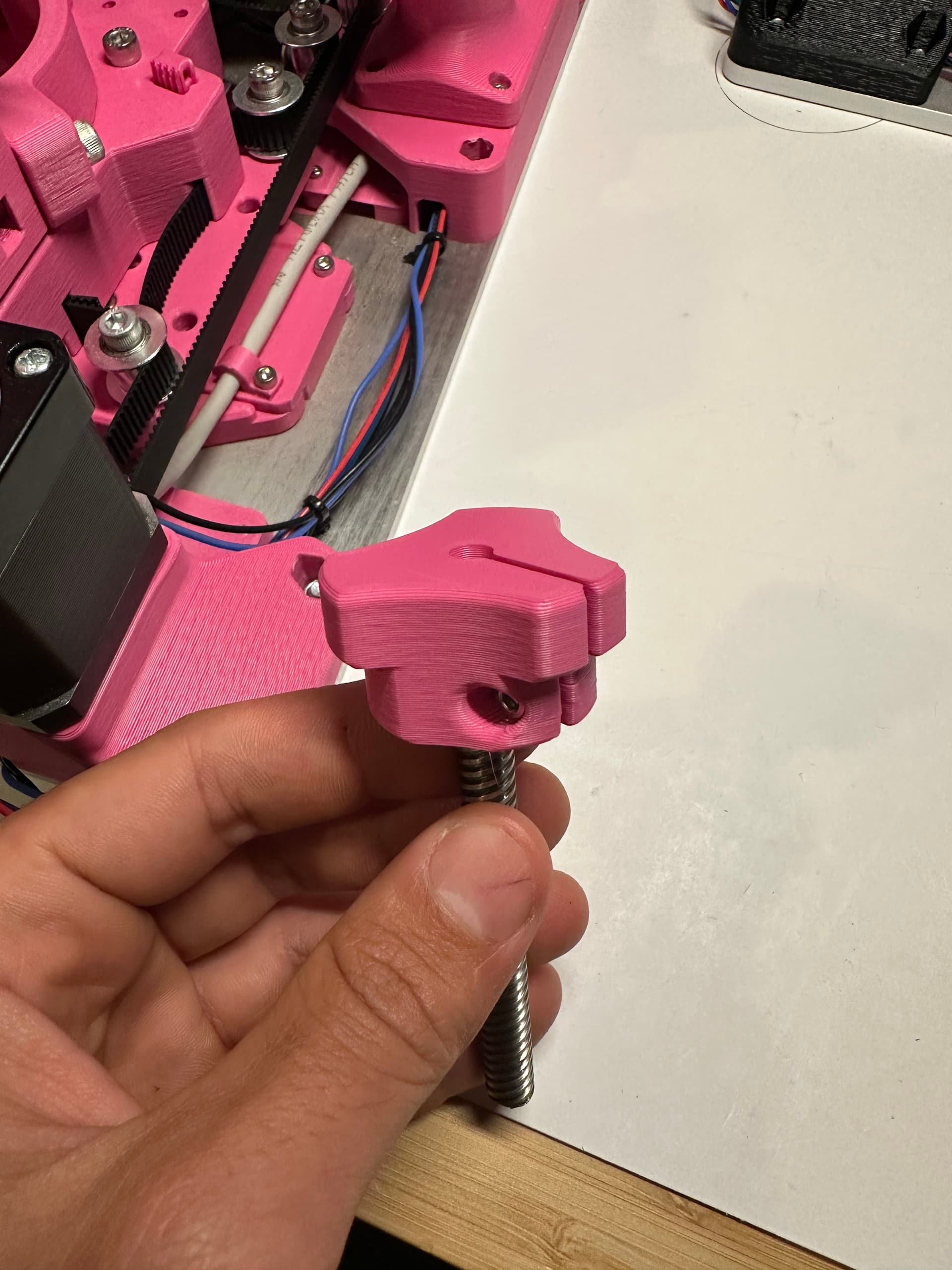

For the zKnob part, people were having issues with the original design, so I changed the cinching mechanism to clamp instead of using set screws. The new zKnob_01 part works a lot better and is a fast print, so I’d recommend it.

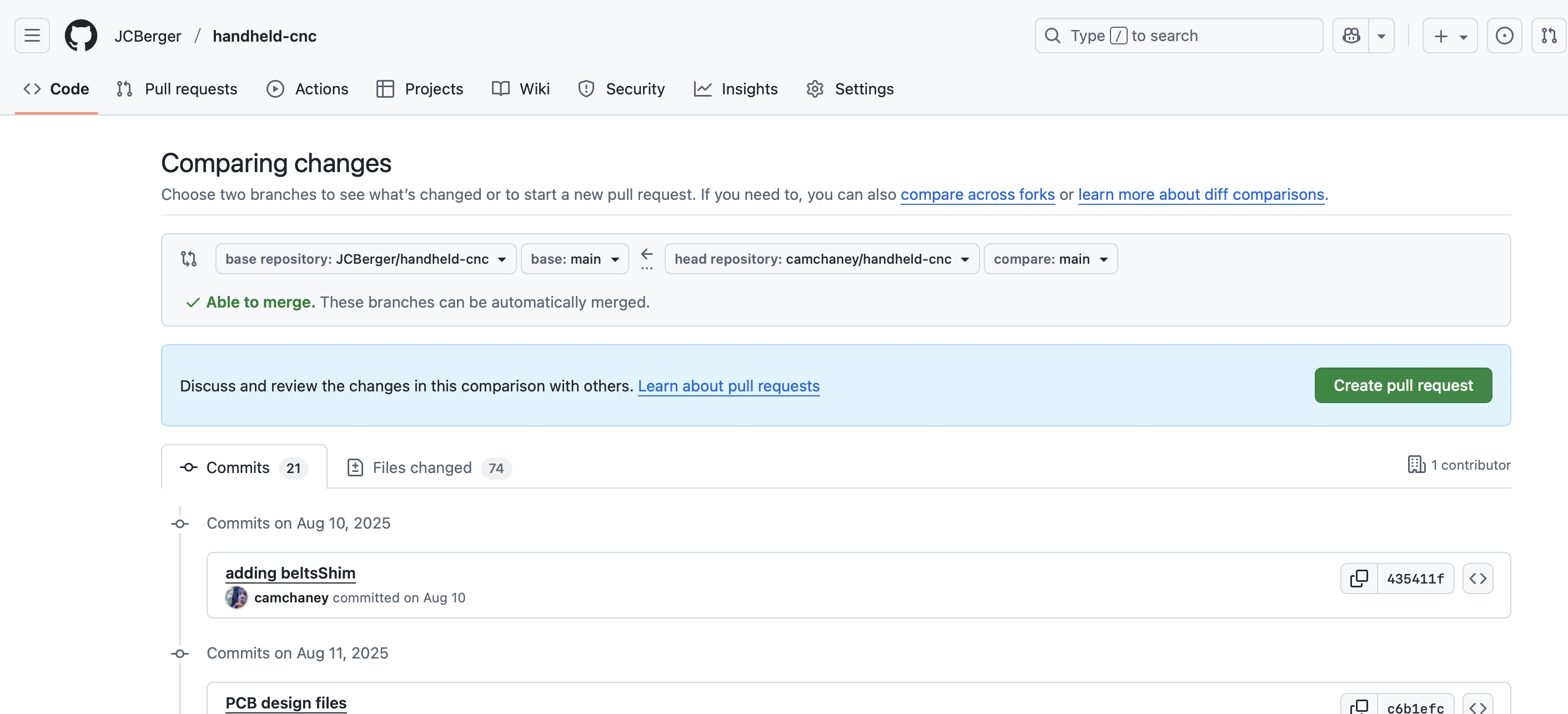

The thing that I did that I think will help keep things clear for me on what changes are happening is to fork the repository when you download the parts to start printing. That way Github can provide you with the changes. As you update the parts, then start accepting commits, which I think will help keep you up to date. The other thing I would recommend is adding the date you downloaded files or folders on your computer.
