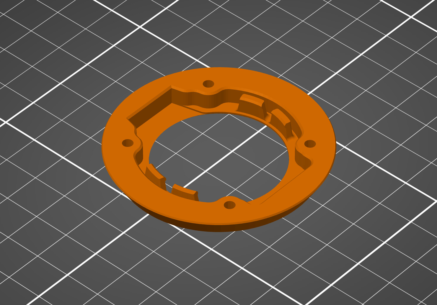

What holds the lcd in the display ring?
Sorry if this isn’t the right place to ask for build help! I’m a bit confused about what is supposed to hold the lcd in place in the display ring. Is someone able to tell me if it’s supposed to be a friction fit? It currently just falls out.
Hey Luke, it is indeed a friction fit. I recently uploaded a new version to the repo that has tabs, though. This should make the fit easier:
Sweet- thanks! Going to print it now
Sweet, let me know how it goes. I designed it for with a board from a different manufacturer, so they might have slightly different dims.
Yeahh so it’s a no-go with the new mount + old screen. I whittled the teeth off one of the sides to see if it would clear but nah. And the force prob would crack the screen. I was going to start filing the other side but said “f it” and ordered the three pack of the screens you linked to haha.
Btw that wave share screen still appears to be linked in the BOM if you click the Amazon alternate source.
Ahhh yeah got it. Shucks
Appreciate that! Just updated it
