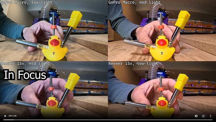

All this being said, I’m still looking for a camera mount for a lr4 for time lapse. Anyone have any nice printable or routable camera mount for a lr4 to capture the router to material point of contact?
I’m looking for hardware, not software, if any suggestions. Octoprint works amazing for me, thanks.

Are you looking for Pi Camera and mount that can integrate with Octoprint/Klipper, or, are you looking to invest in a more serious setup worthy of your man cave’s sanctity?
Am currently leaning towards modding LR4 dust shoe for a GoPro to ride along…
EDIT: Curious if someone figured out something they like already? Not sure I like where I’m heading…
That’s not a bad idea, I do have an old gopro laying around… somewhere. But honestly it’s mostly about the tool mount. I can fab my own gopro to Logitech adapter easy enough and I got some 1080p usb webcams laying around.

Argh… Taking me way longer than I hoped…
  • One goal is to reuse existing dust skirt if possible, even if that restricts FOV.
  • Making a spindle lock button extender before printing.
  • Given additional weight, will add more material to bolt mount.
  • Made camera mount separate so can be iterated on, or modded by others.
  • Kobalt router with LEDs, so printing clear PETG, hopefully there’s enough light, will see how glare turns out.
Mount ideas/feedback appreciated? Am no CAD pro, just a tinkerer.
EDIT: Posted update/video in my LR4 topic.
I was looking at something like a nozzle cam for this. I do think light will be a challenge. I have an ESP32 Cam from Ali for $10 but I thought the options for the nozzle cam would be interesting to try and hide a camera in the dust shoe.
Light, dust, and vibration would be my biggest concerns. For dust and vibration, it may make sense to try and tuck it in near the core. In fact one idea I was tossing around was a cutout, so that the camera could be mounted to the core rather than the shoe (to better isolate it.) The dust collector is then pulling away from it, which may help visibility as well. Obviously it would need power, but I could pull that from my laser wiring. I bought some pogo pin connectors that would allow a more generic supply of low voltage power that could then be converted to whatever is needed from a fixed point on the core. I haven’t gotten around to this project yet. :man_facepalming:. A bit overcommitted at the moment.
Let’s be clear here, compared to me you are no cad pro… You’re a cad god :rofl:
Quick update… Shared an update on https://forum.v1e.com/t/azas-lr4/45696/37?u=azab2c and mount .STL on https://www.printables.com/model/1331702-kobalt-dust-shoe-for-lowrider-4-cnc.
Thank you. Wish that was true, but my true calling has always been to know where to put semi-colons. I like CAD and Maker stuff, but am just a curious tinkerer who’s been fortunate enough to watch and learn from Maker content more than all the Cat and Doom scrolling content on the YouTubes :slight_smile:
