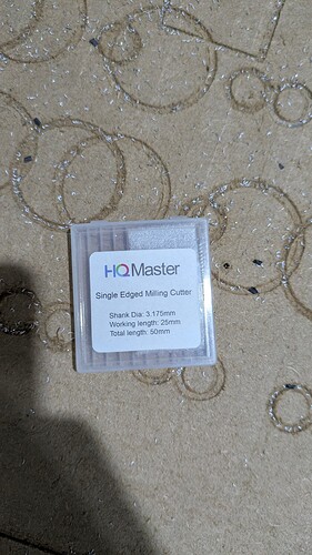

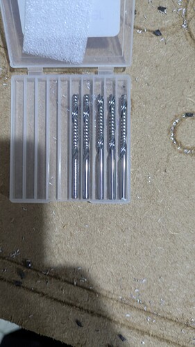

I use this ones for 3/4 mdf. They are like 15 usd fot a pack of 10 in amazon
-you can cut wood, plastics mdf acm (acm is some thin aluminum with a plastic core) whatever you want (no steel)
